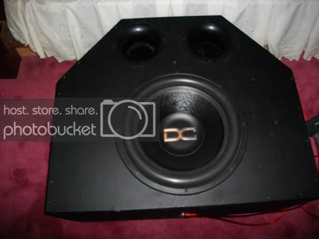

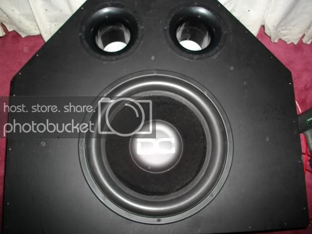

There are 3 areas of bracing within the enclosure (in between the ports and on either side of the sub). I decided to ditch the polyester batting idea because it really was a waste of time. Guy's, this setup sounds impressive considering it's only a single 15" on 1,000 watts. Everything's coming together nicely at this point and I can't wait to pretty things up in the trunk.
I wish I had a better camera. These pics are doing the enclosure no justice. The only real flaws that're noticeable in person are the holes from the nail gun. I probably should've used a bit of filler on them, but I figured the second baffle, a layer of padding and the vinyl would cover the ugly pretty well.
Anyways, we'll probably paint the ports flat black just to break things up a bit. I may even see what silver looks like, because it would be nice for something to match the DC logo on the sub.
More tomorrow. Thanks for looking. By the way, the enclosure is 3.5 cubes @ 34Hz...

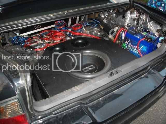

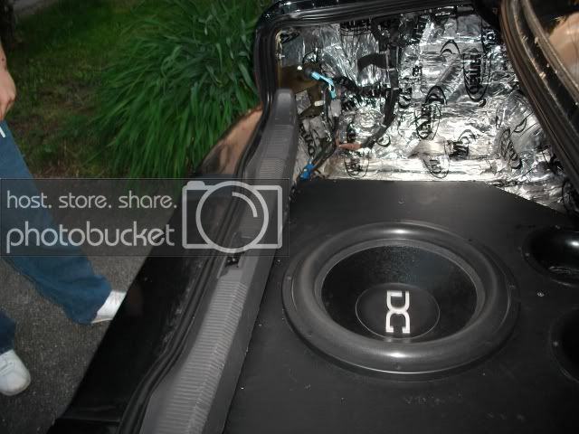

new pics:

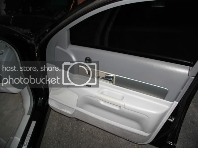

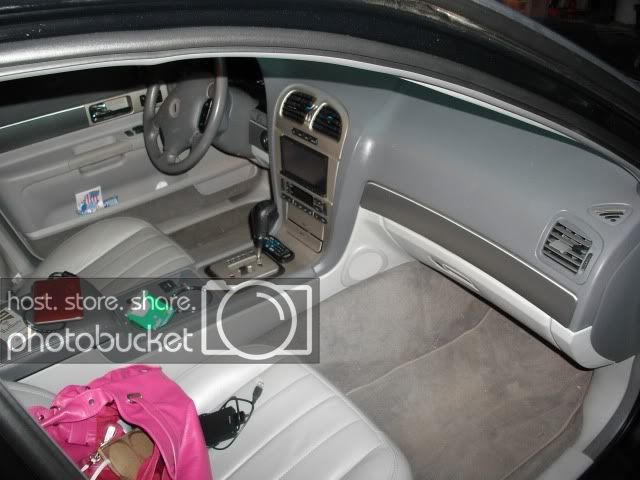

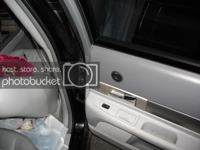

I haven't posted any pics of the vehicle's interior since everything was put back together, so here goes.
And here's a few looks at the trunk. Keep in mind, there's still a lot to do back here. I just figured we could throw in the enclosure so the owner can have bass.
The amps are NOT going to stay on the seat backs permanently. Mounting them there is better than letting them slide around in the trunk.
The DC Level 4 is no joke and the T152S' are nice components. This setup has a ton of output and it's crystal clear. I'm very impressed. Too bad the owner didn't show up for work over the weekend, because it could've been finished by now. Oh well. He leaves for work tomorrow, so it'll have to wait until the beginning of June...
