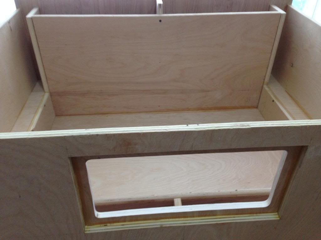

Remember when I said it would barely fit? Well, I wasn't joking:
This port is freakin' huge. Glued the inside pieces together and dropped them in, but I will be taking them out to throw some bondo in the port corners.

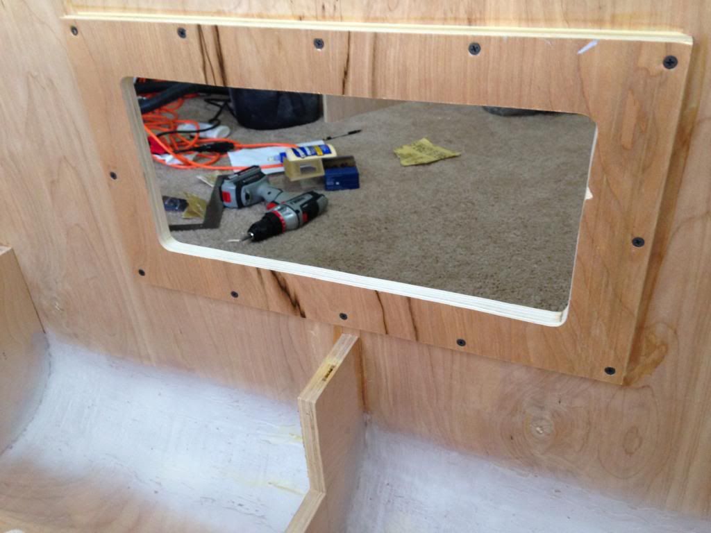

Put the plexi mounting ring in:
Put the port back in just to fit for the top pieces.
