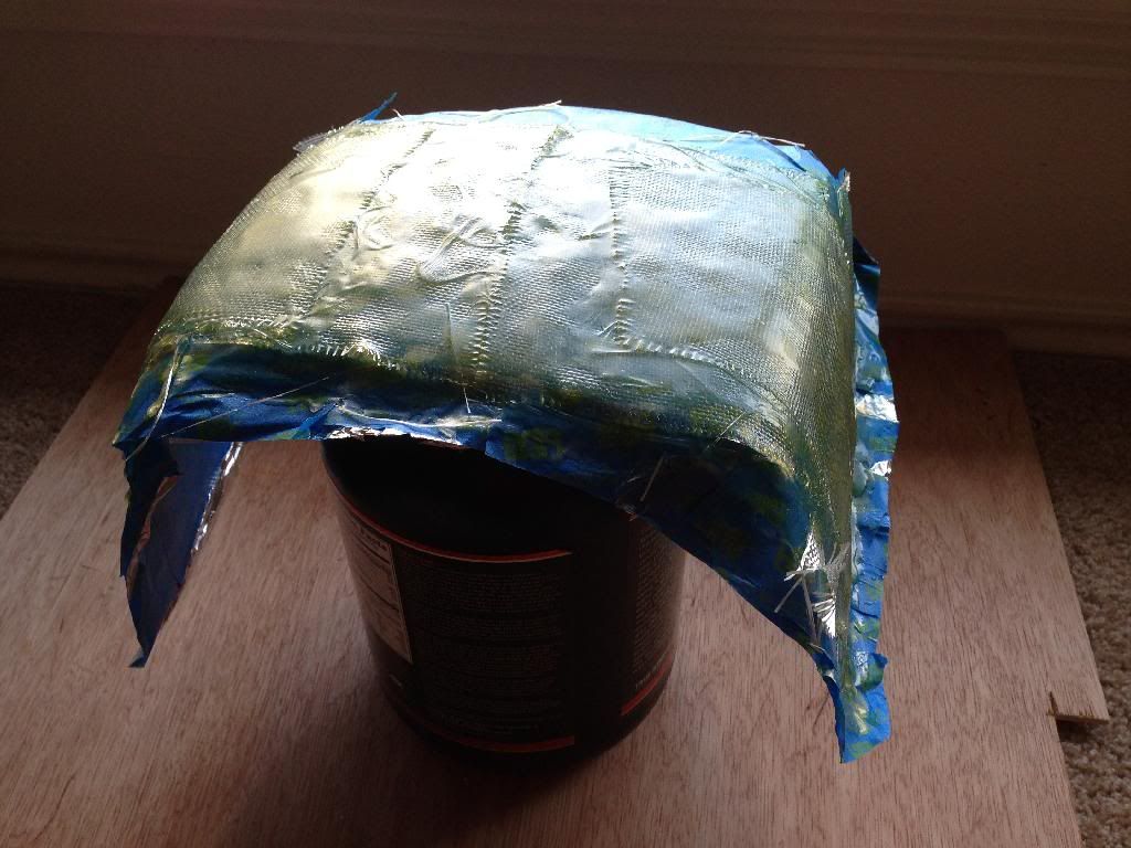

Taped up and covered the area I was working with. I covered the whole thing because I wasn't sure how much I was actually going to use.

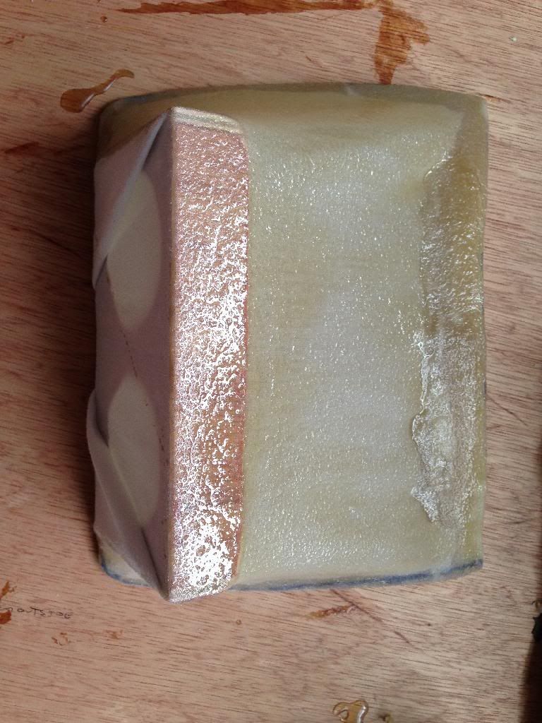

Then I laid down one layer of glass, and figured out after an hour I didn't use enough hardener. So I just mixed up another and threw it on top. Don't remember if this was my first or second:
One or two more layers, and I popped it off:

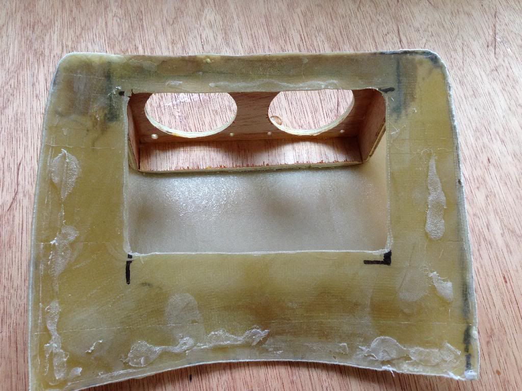

Decided I'm just going to use the top section, not going down the sides. Cut it up:
Then cut the meter baffle, placed it on and marked the fiberglass where I want it:
Then just tacked it on with hot glue:

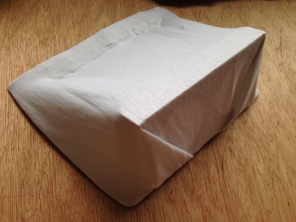

Then wrapped the thing with some shammy cloth I had laying around. It was soft cotton not microfiber. Used hot glue to tack it. Not perfect, but good enough to where I can fix with Bondo.

Cut out an access hole:
Added mat for strength:

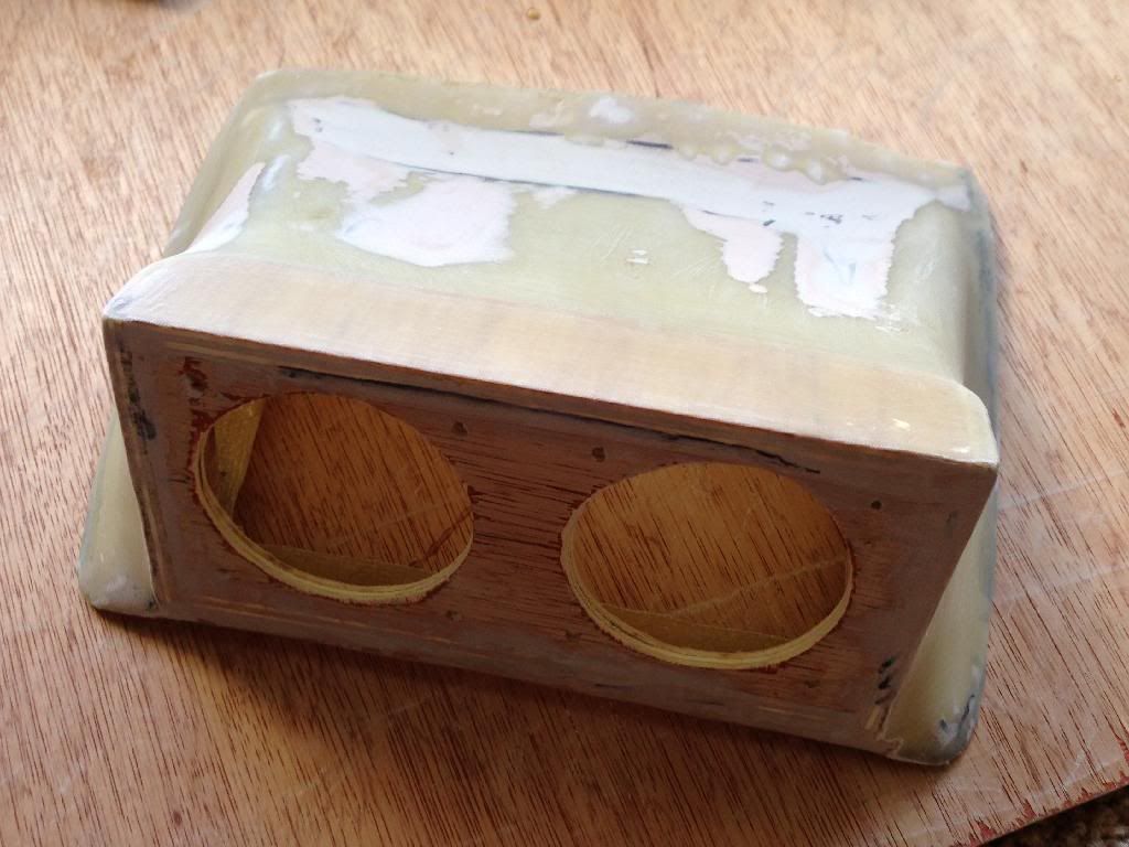

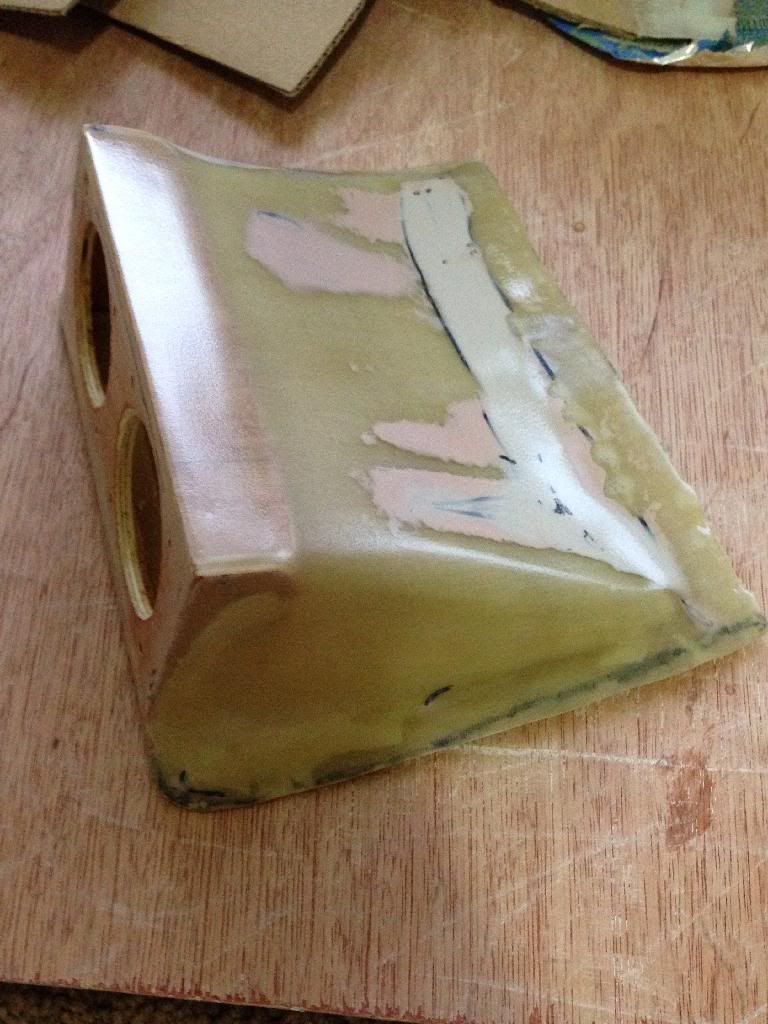

Bondo coat #1 :
A wee bit o' sandin:
After sanding Bondo coat #2 :
Gettin there. Just got some small stuff to fill in, sides to sand down, and it's almost ready for primer.

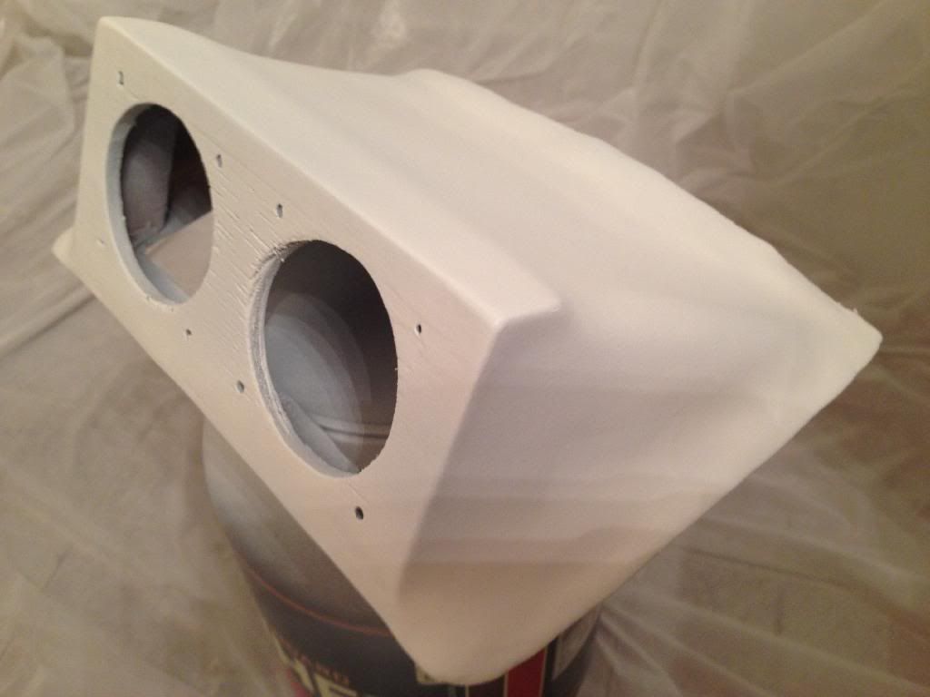

Taken with a potato, but last coat of Bondo:

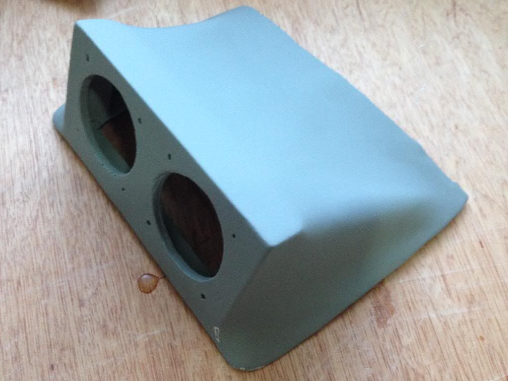

Shot it with a clear primer, it's all I had. Need to get some black tomorrow.
The plexi also came in! This stuff is hard as a rock, I have no worries about this flexing.

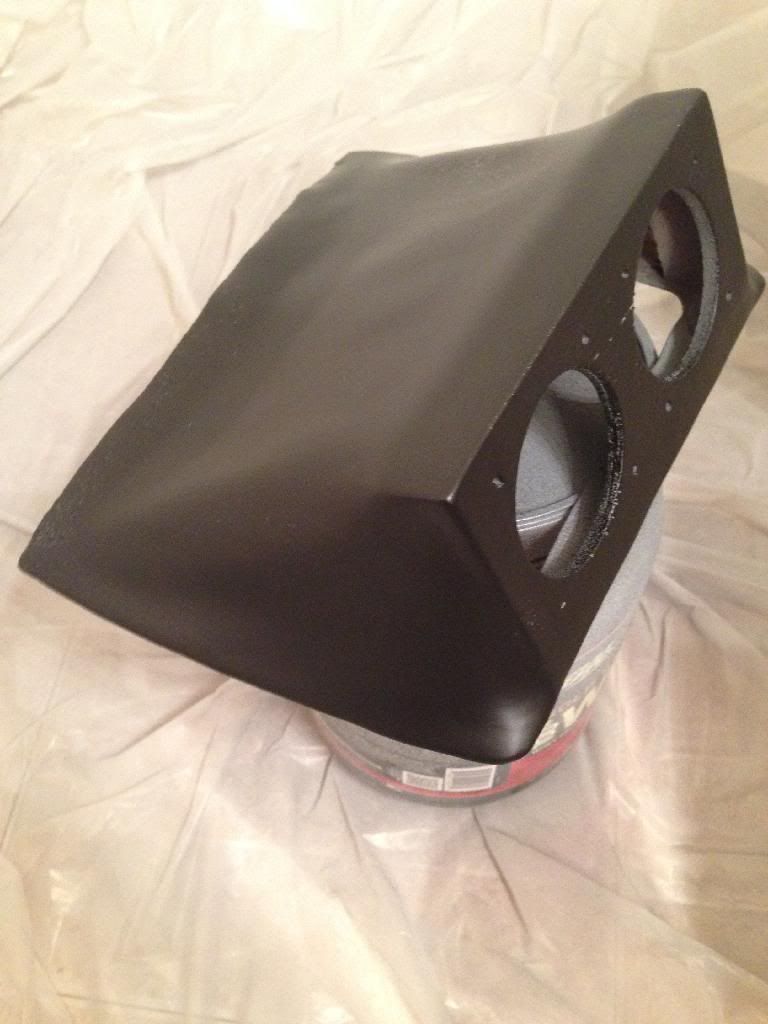

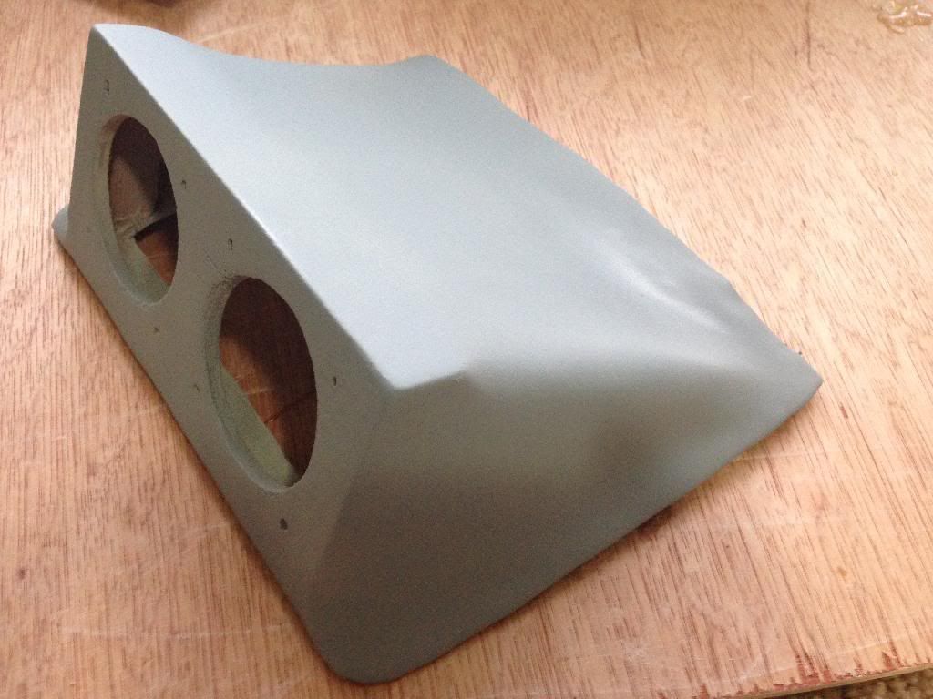

Just some primer and sanding. Alternating between grey and white coats so I know how deep I'm sanding:
This is the point where I start getting annoyed with sanding and my mistakes and just start accepting imperfections lol. It's not too bad right now, some stuff will be noticeable though. Gonna plasti-dip for the finishing coats.

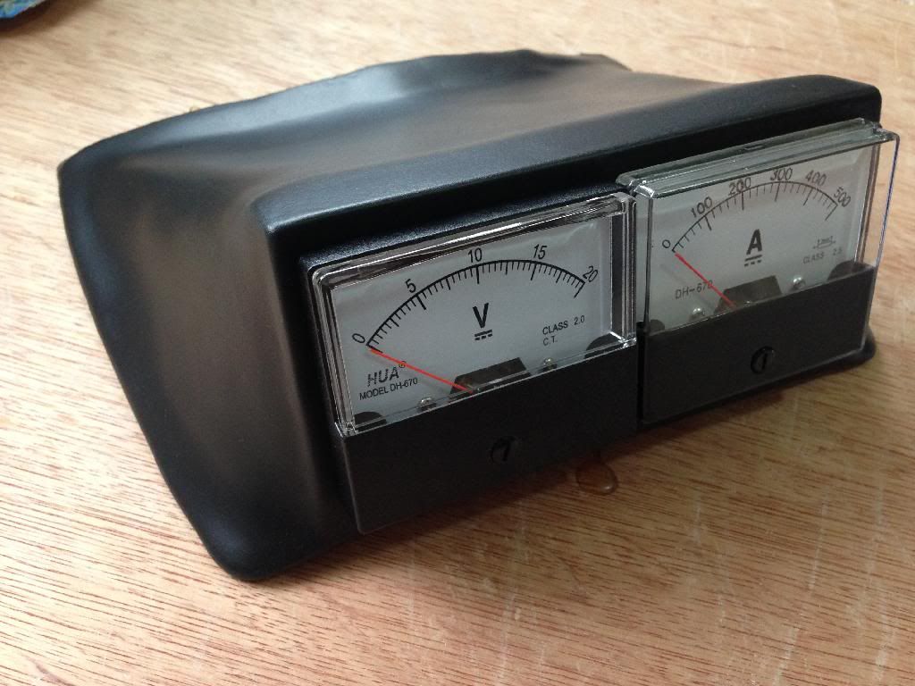

So, this upsets me:
My guess is it was cooler in the house where I sprayed it, and now out in this heat the fiberglass expanded and caused the plastidip to tear. Guess I'll have to take a sharpie to it.

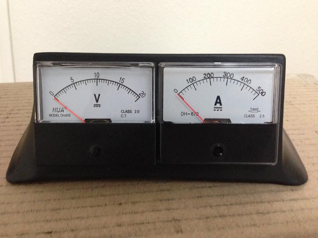

But got them wired in. The ammeters are working correctly, but the voltage is off, I'll explain that later. First, two videos:
Notice how little my Levi draws.
The voltage is off. I wired it all together, ran off a single wire from my daisy chain in the back. Didn't start dropping like that until I wired those two in. I know it's off, because if I turn the fans on in the amp rack it drops to 14.4V and stays there, and that ain't right. I'll have to run some more wires and hopefully that will solve it.

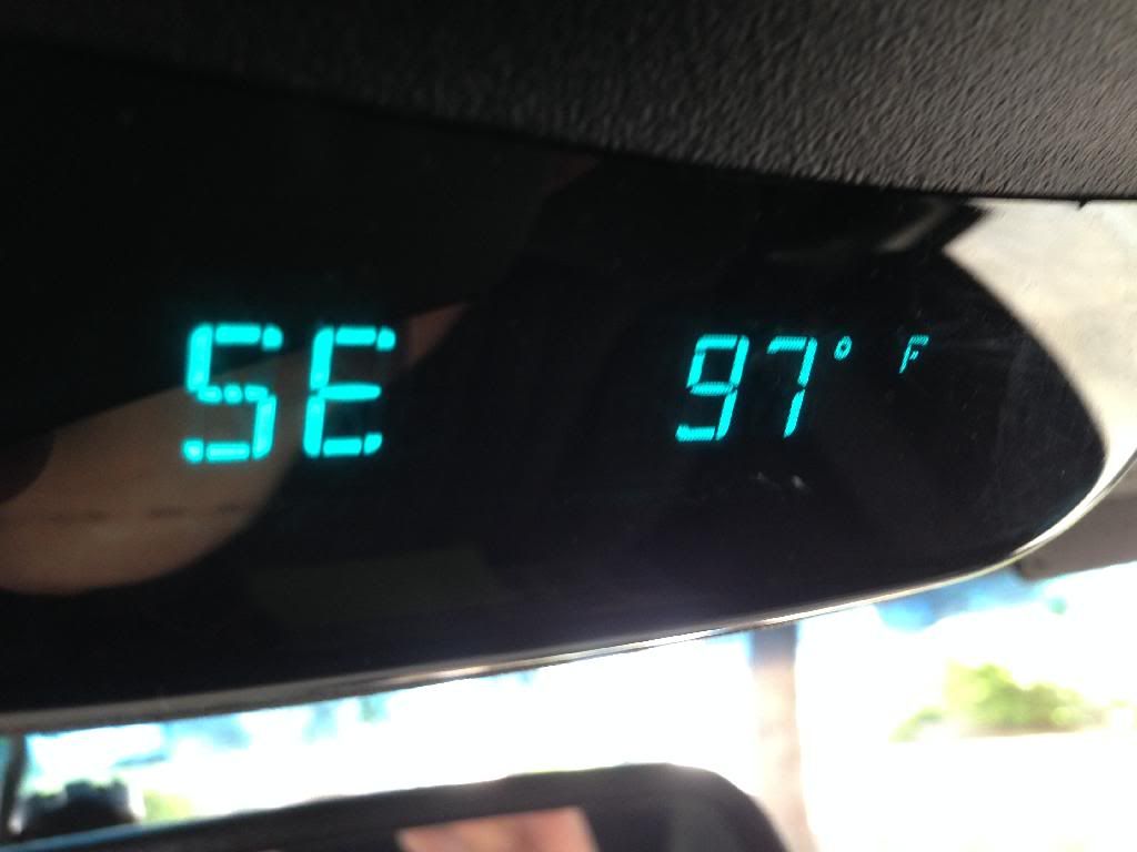

Also, Texas is already unbearable:
Or for those of you in the US:
looks good. maybe try to use SEM rather than plastidip? may help out with the paint not coming off or cracking.
Well it's already done //content.invisioncic.com/y282845/emoticons/frown.gif.a3531fa0534503350665a1e957861287.gif
I'll keep it in mind though.
Sick lookin. Your HU reads voltage?
Yeah, the 80PRS does.
