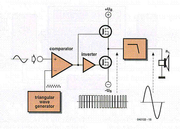

Class D needs a way to derive a duty cycle for the pulse width so it generates a static triangle wave and compares that to the incoming audio signal. This is done by the comparator. The intersecting points of the trianlge wave and the sine wave provide the results, which is then amplified and fitered. I would imagine it's far more complex with a full range Class D design.
Ah ok. Makes sense, but on the verge of my education limitations...lol.
I mean really it could be anything though. My last issue was a leaky capacitor. When the amp stepped down from high to low voltage rails, it would shut down the MOSFETs temporarily. I would never think it would be a cap causing that issue, but Mr. Mantz found it //content.invisioncic.com/y282845/emoticons/smile.gif.1ebc41e1811405b213edfc4622c41e27.gif

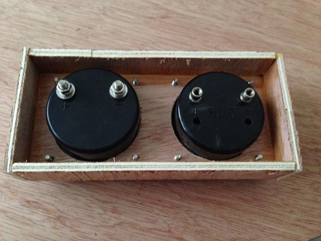

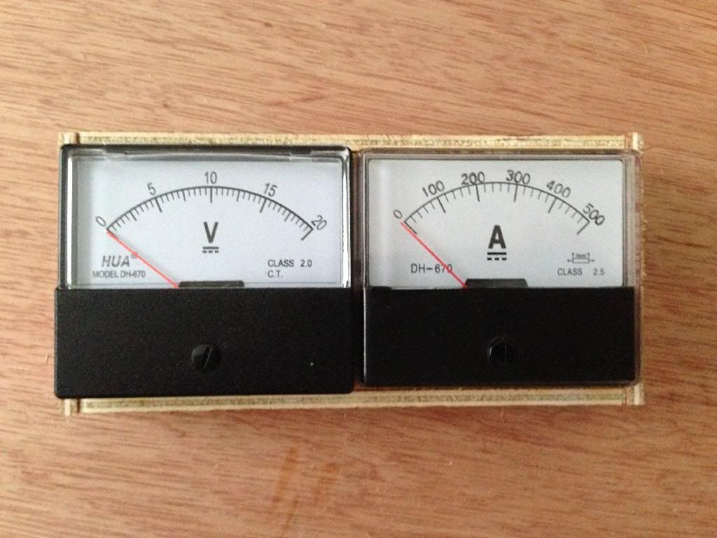

What I am doing now though is build a fiberglass housing for my two new meters. Got the basic wood face down, and some outside supports for the fiberglass:
Will hopefully sit in there just like this when I'm done:
