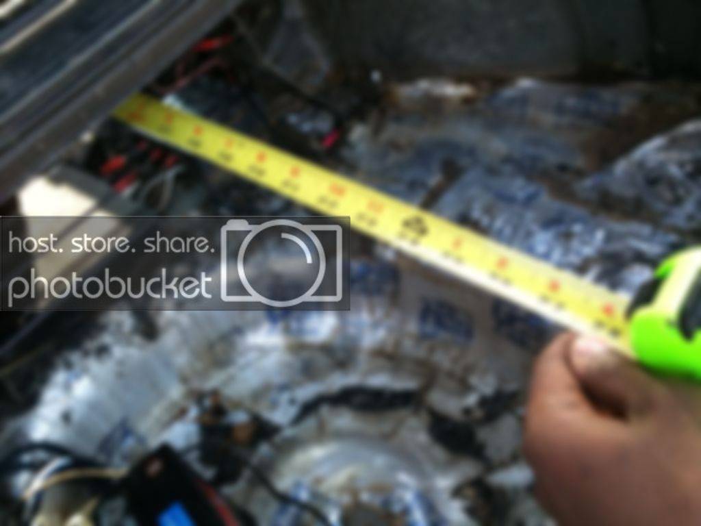

@ Buck & Jerry - A Bigger box would be nice... But I'm already pushing for space - ( only reason this box is fitting is due to me cutting most of my Rear Dash... ( Currently have a 6x9 board there - But it can be altered )
... I'm about to take pictures of the space that I have available [with tape measure for visual measurements]... It's an EXTREME tight fit... But I don't have a little bit more depth I can add... [but not too much due to the back being put on the back side of the box]

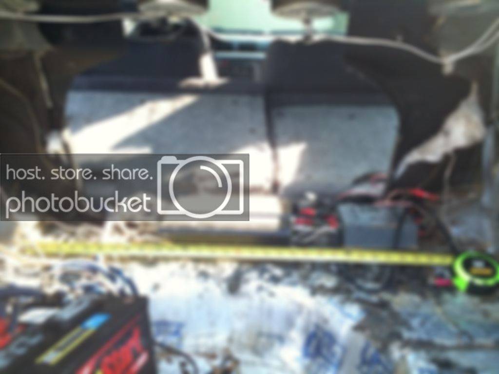

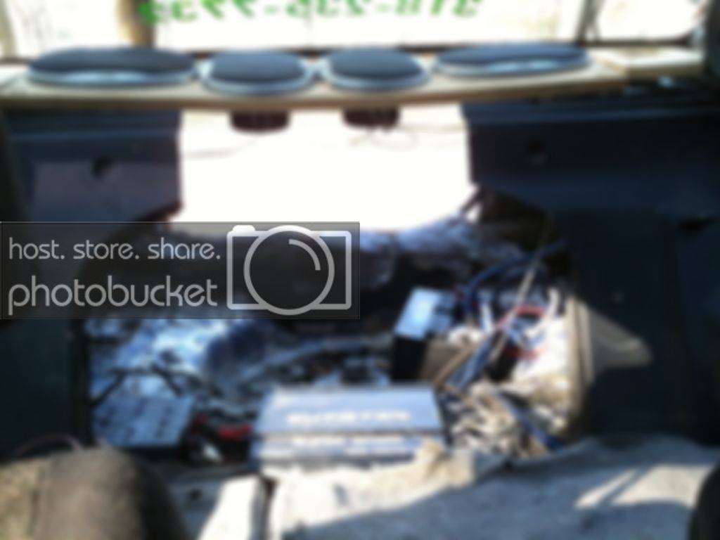

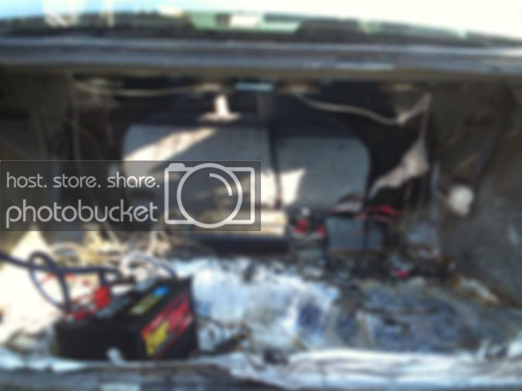

This is the space that I have Available... [Yeah, It's messy right now... But there's nothing in up - So, oh well!]
... The Front View
...The Rear View
... This Is the Width Available... [ I thought it was 32" Wide - It's only 31" Wide... UGH! ]

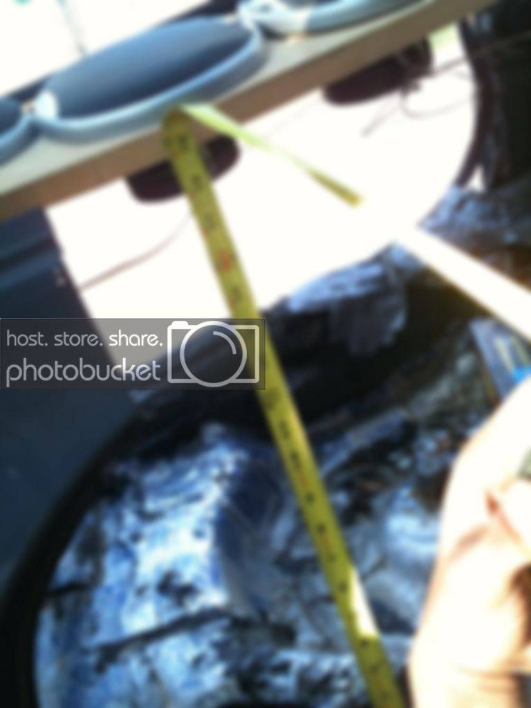

... This Is The Depth... [ I can do 27" ... 28" MAX ]
... This is the Height... [ I " MIGHT " be able to to 19" ... But looking like 18.75" is the ultimate limit... ]

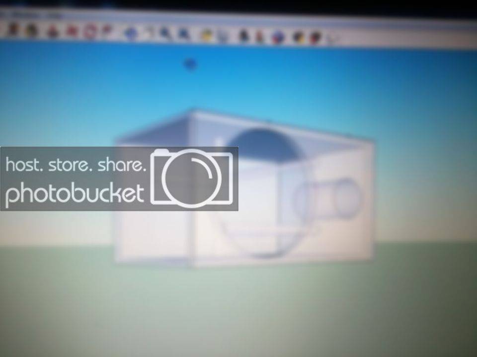

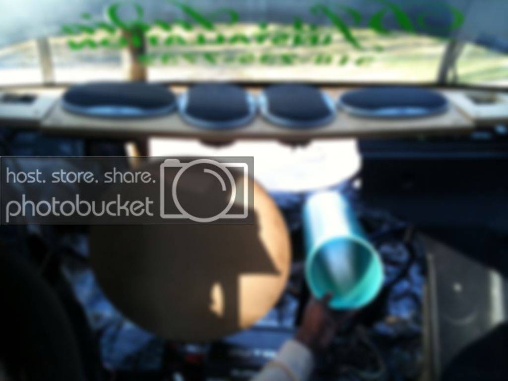

... WELL - HEAR GOES JUST A CUT OUT OF AN 18" SUB & THE 6" PVC I'M GOING TO BE USING! [Just a Mock Up]
..... So there we go.
