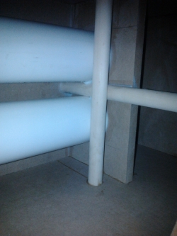

Just out of curiousity, what do you guys think of this in terms of port placement or design flaws?
It performs great, I'm just looking for any areas I can improve on.
its tough to give acoustical advice on a physical structure without knowing anything about it, but to make it simple......look at my store on my website and check out the round port enclosures. The way you did it is pretty identical to how I design mine, so your doing something right.
Ok thanks for the feedback from you and Buck, I really appreciate it. I'll take a look at your page.
The box is about 1.85-1.9cu/ft, tuned to about 32hz with 2 3in pvc's.
I'm glad to see all the positive feedback. I'm doing a box for a 15 that is basically the same design. Should be right around 3 cubes tuned to 30-31hz with 2 4in pvc's.
This is how it currently sits:
Sorry op, not trying to hijack your thread, but maybe this will give you some more insight.
