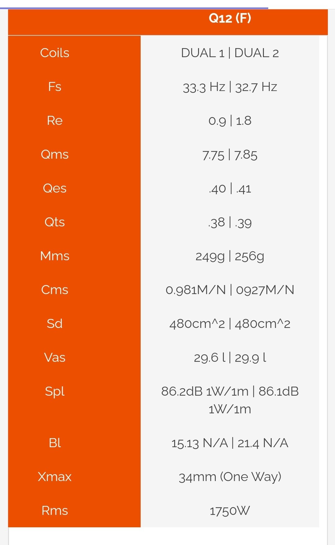

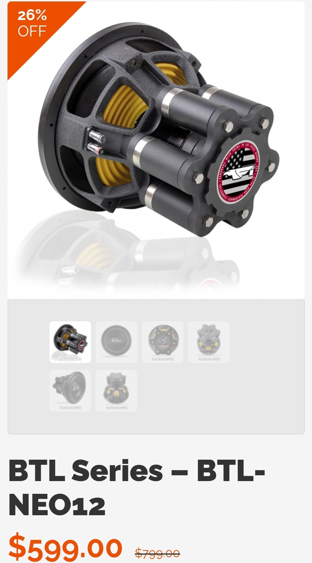

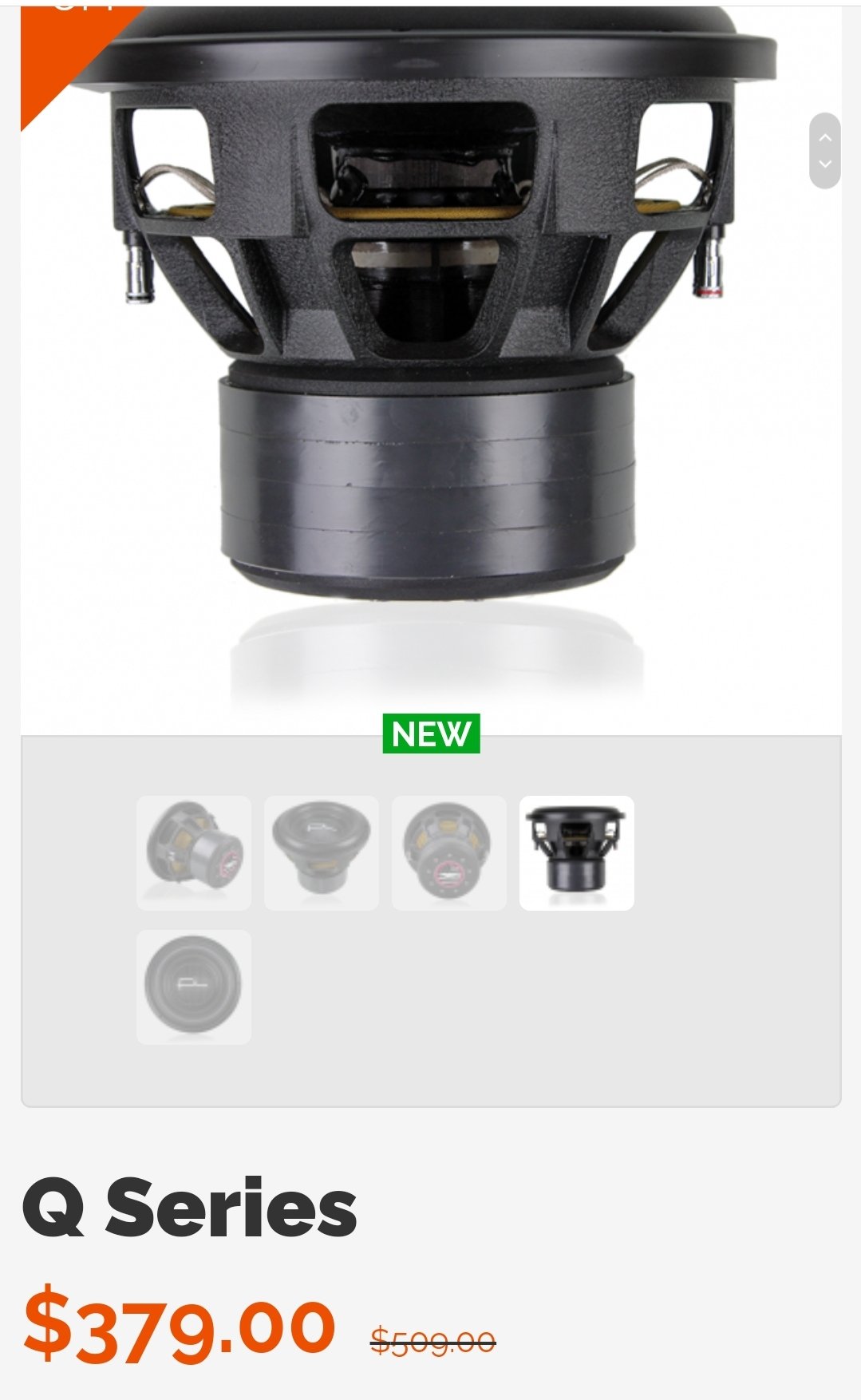

If you are willing to spend $600 on a sub, then, look at a Fi Neo 12". 2,500 rms. and it looks badass.
So they would be lacking in low end bass? I am just mainly looking for something that will sounds good and be loud
Then stop looking at these overkill peaky SPL subs. Get something for daily driving, not metering (DC, Sundown, Wolfram look big and cool but there not very practical for a moderate wattage daily music setup). There designed more for people just throwing raw power at them and getting loud
For your application it would be borderline pointless. You can get something like the Icon or Brahma that will only be a few decibels less but be hundreds of dollars cheaper + sound better.
Don't fall for the trap of "oh this sub has a 80lb motor and can take 3000 watts, it must be badass". Your already at a huge advantage with it being a center console setup (versus a trunk setup) + your stock alternator is decent. Your not in a situation where you have to try too hard to be loud
