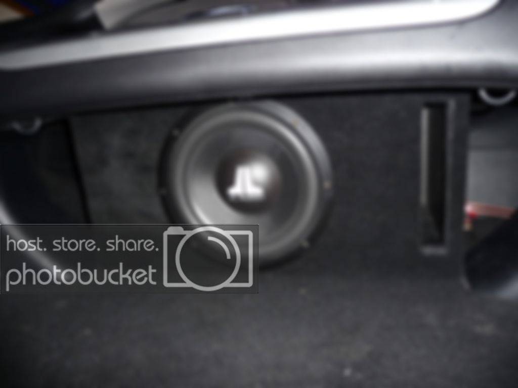

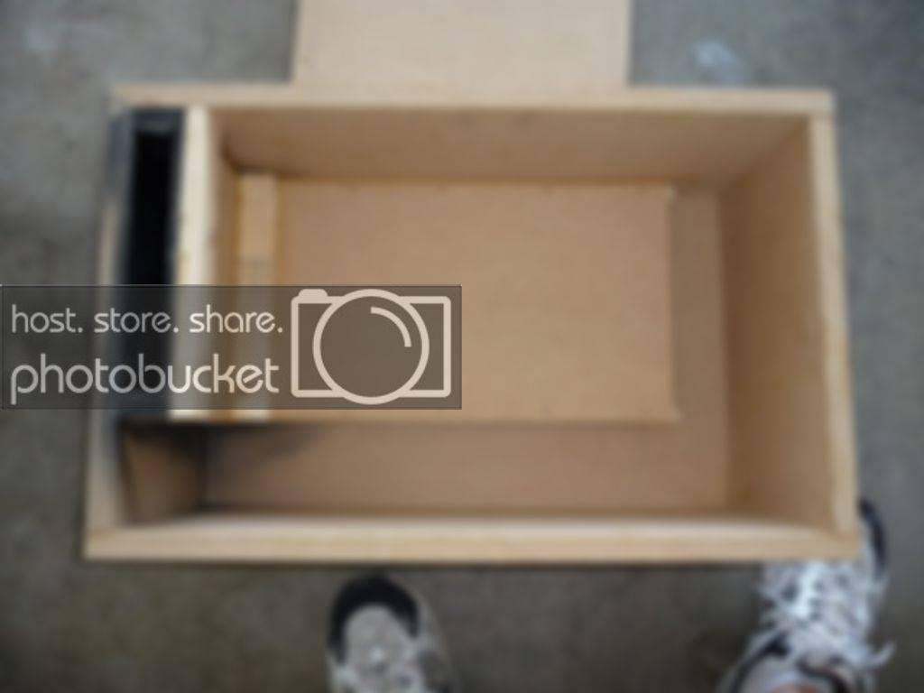

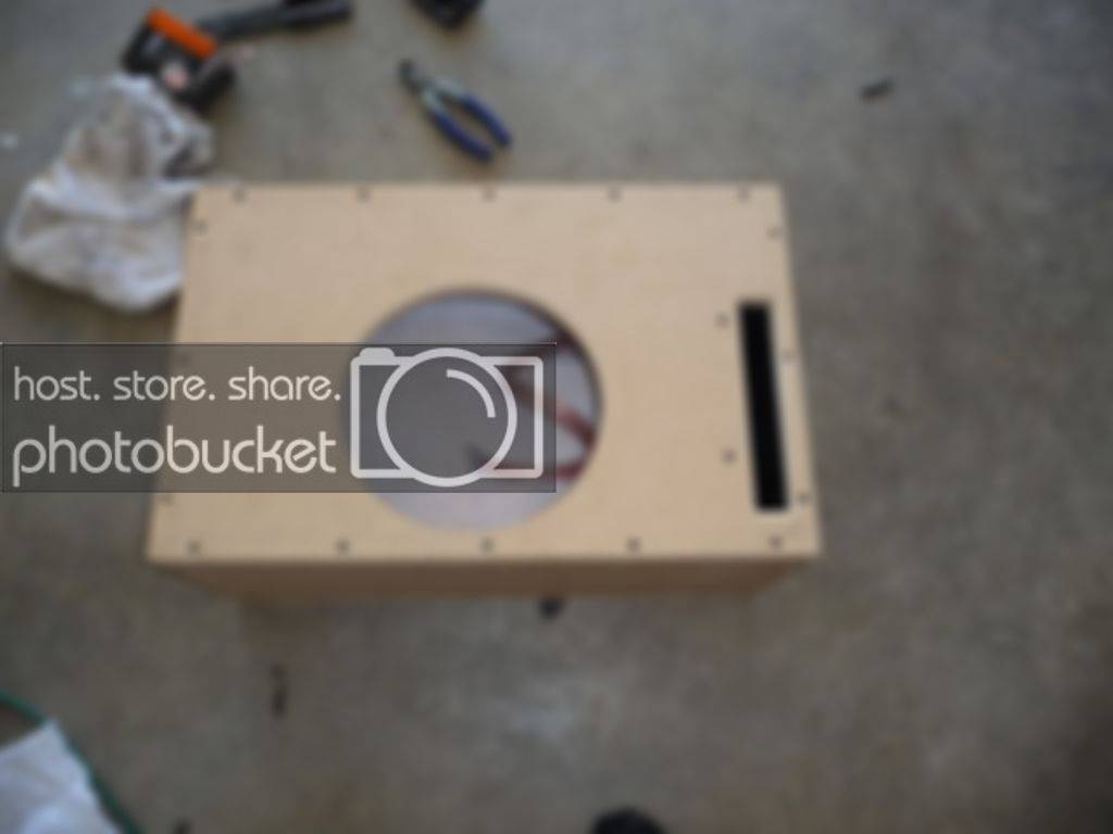

Here's the "compromise" box.... The hight of the port was limited by the strut tower and the width was limited for maximum mounding depth. (A hair over 8") The top of the port was 1/4 MDF and furring strips ripped to 1.25 inches were used to support the port. VV shouldn't be an issue unless I get about 700 watts to something like a W6v2 and that's only around 20Hz. It sounds good @180 watts right now...

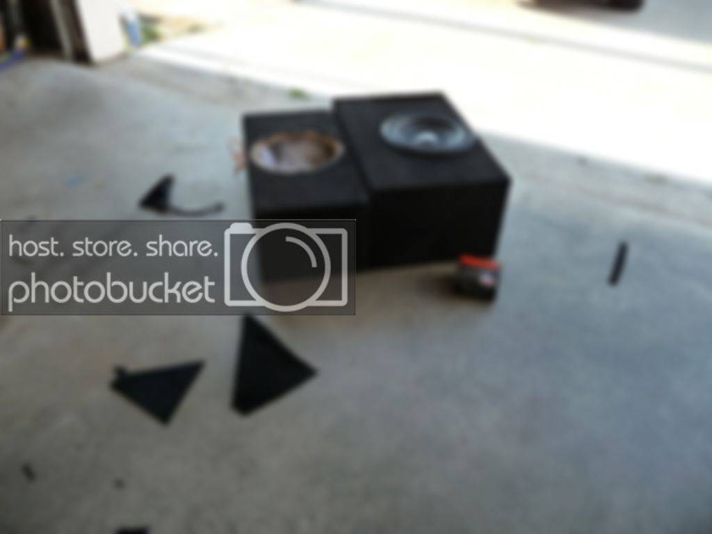

Here's the new box with a WX next to the box I raced with for years. (you can get an idea of how much I've added.

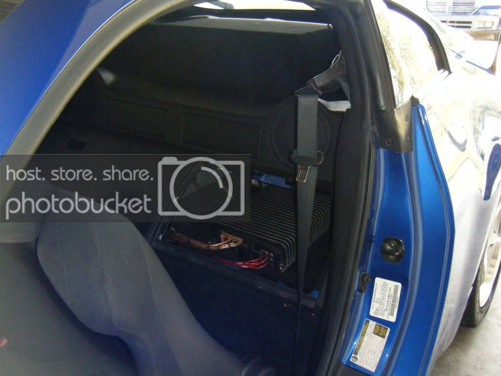

And mounted in the car (This is the WX, I have since installed the W3v2, and cleaned up the wires with the new amp rack)
little "stealth" amp rack. (There's a stock panel that covers it) There's enough room for the 500/1 in there too.

Clean install. Well then I guess this is null for a couple more weeks until you get on the track again. If time doesn't suffer, then you can leave it and be good. If it does, back to the drawing board?
Thanks.
...Pretty much. Although, I Just remembered that I haven't removed my spare and jack at the track in over 5 years. (Ever since I decided I needed some weight over the rear tires.) If I start removing that stuff at the track, I might just break even weight wise, but having the weight in front of the rear tires is better than behind the rear tires where the spare is.
