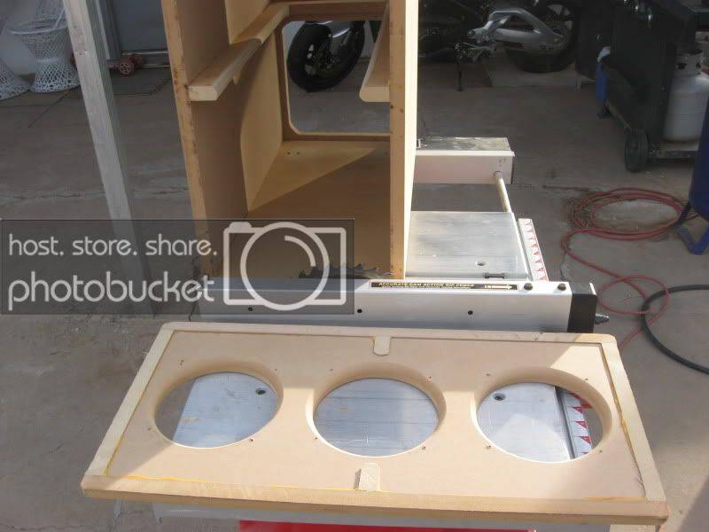

First I chopped the back off my 43hz test box...

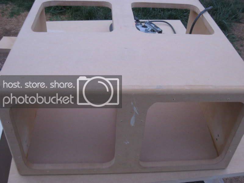

Cut a couple more holes.

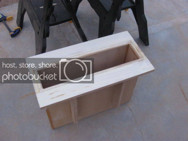

I made a slot port 4.5" x 20.5" and new back plate that would tune me to 61hz on my 2.2 cuft box

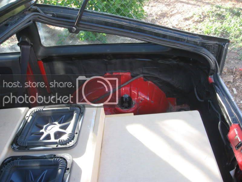

I then realized i should test fit... it's close

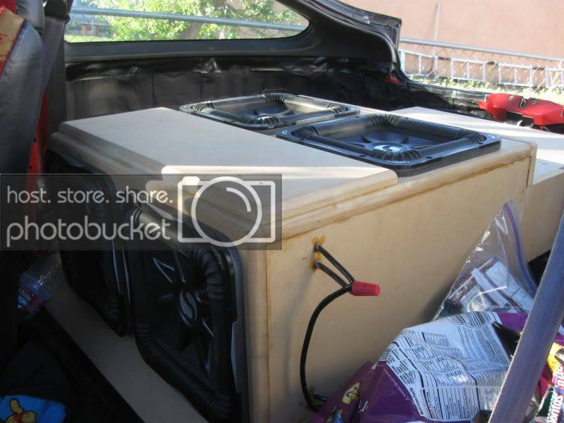

Loaded up some square subs and on the first burp...
I then added a bunch of sound deadener, but haven't taken a pic yet... I need to remove some //content.invisioncic.com/y282845/emoticons/smile.gif.1ebc41e1811405b213edfc4622c41e27.gif
Don't mind the mess, I just threw everything in the car before loading on the trailer to come home.
Here's a front view of the box as it sits now:
