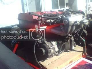

Picked up an engine upgrade. It's a complete DOHC B18, two transmissions, half shafts and everything to mount it in a rex for $200. I'm going to run the D16 SOHC that has already been swapped into this car until I get more time an better weather since I don't have a garage...

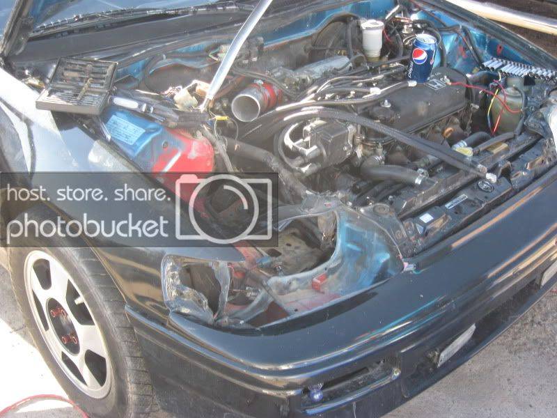

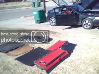

Starting the tear down:

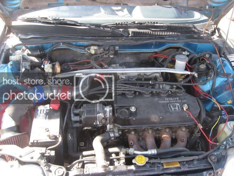

It's a little harder to get a Group 31 battery under the hood than I expected. There's a great thread on Termpro that shows tons of pics of them. All I got to say is that anyone who lays a battery flat did a little cutting...
This is what it looked like when I popped the hood yesterday.
I strung wires through an existing hole in the firewall that I still need to work on getting sealed up tight. I then started scrapping stock wiring and the stock headlight. I then used a hammer to make a little more room for the G31.
A little sweet talking and some flexible wire got the battery in with the aftermarket headlight (which sticks back further that the stock making this project much more of a pain). The air filter fit just right with a little smashing action going on.

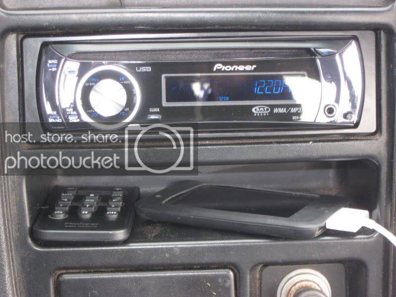

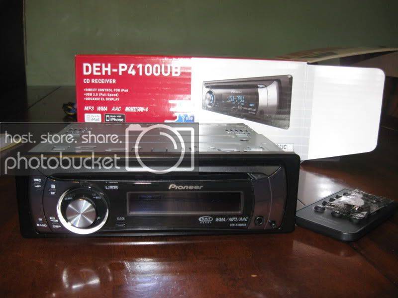

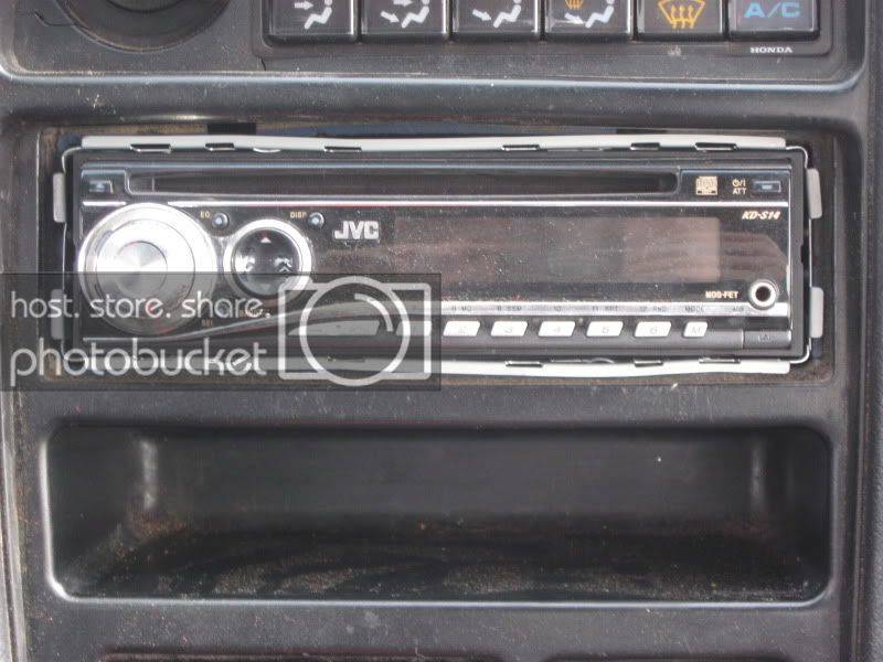

I ran to Walmart this morning and dropped $160 on a Pioneer deck that would play off a USB port and iPod and has the pause feature.
I never even gave this deck a fair shake. It's a JVC CD player with no pause or USB. Out with the bad...
In with the good...

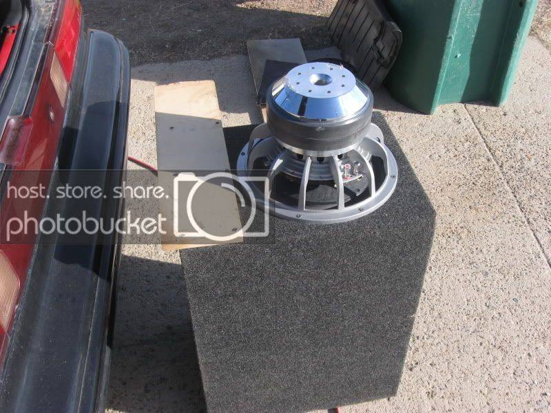

I installed my Batcap 800 and RD D5 in the back and then made this wonderful sealed box...

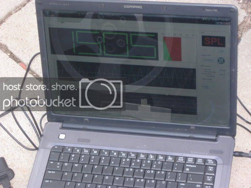

It's a vented subwoofer enclosure that someone left in my back yard. I slapped a board over the port and inverted an RD Alpha Max 12 (for easy wiring purposes). With everything in, I keyed up a 100hz - 20hz sweep and pulled out the TermLab... and then couldn't get the termlab working .
I got my TL working. It's a USB Termlab. My comps USB ports don't put out enough power to run a TL. I bought a powered USB hub and it started working instantly. It just sucks that I have to have 2 things plugged in like I would have with a AC powered unit... oh well.
All tests were run with flat HU settings, maxed out gains on the amp, and volume 35 oh the HU (~ half volume)
My car has two strong peaks. I tested multiple times with sweeps and then went straight to the tones in the area to pinpoint my peaks.
65hz - 131.8 db
47hz - 133.1 db

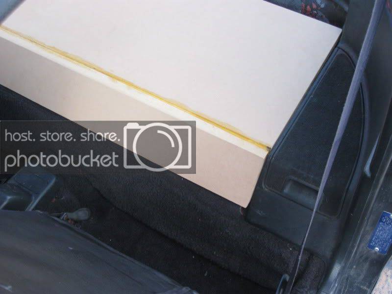

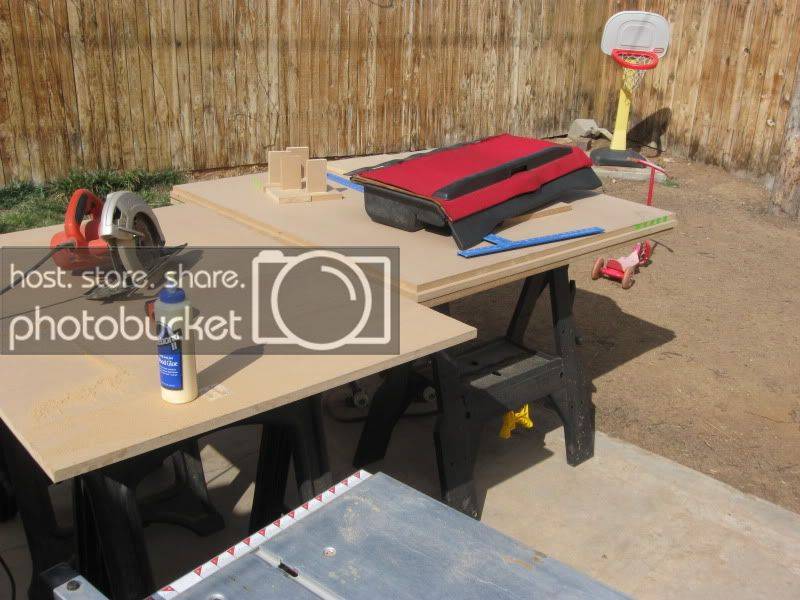

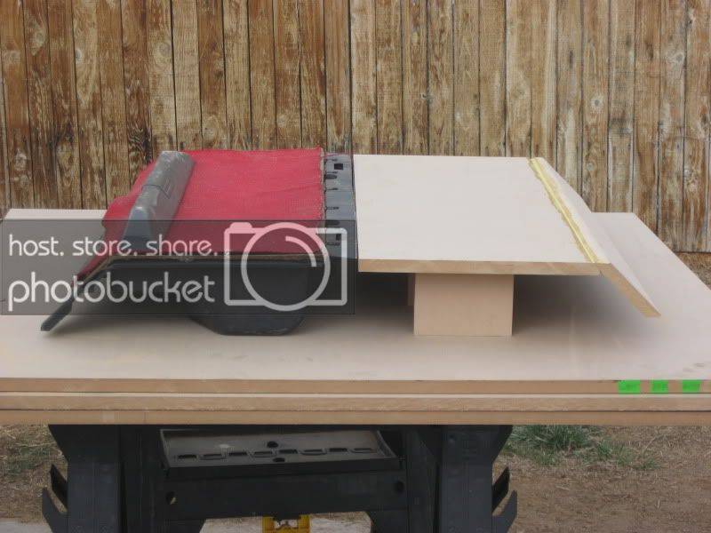

I don't care much for the stock storage space behind the seats. It is flimsy, would never support the boxes I plan to be moving in and out, and doesn't fit right with the 4 runs of 1/0 on one side. With the storage space removed, there is a chance I'll damage the wiring of the fuel pump or the amplifier while moving enclosures.

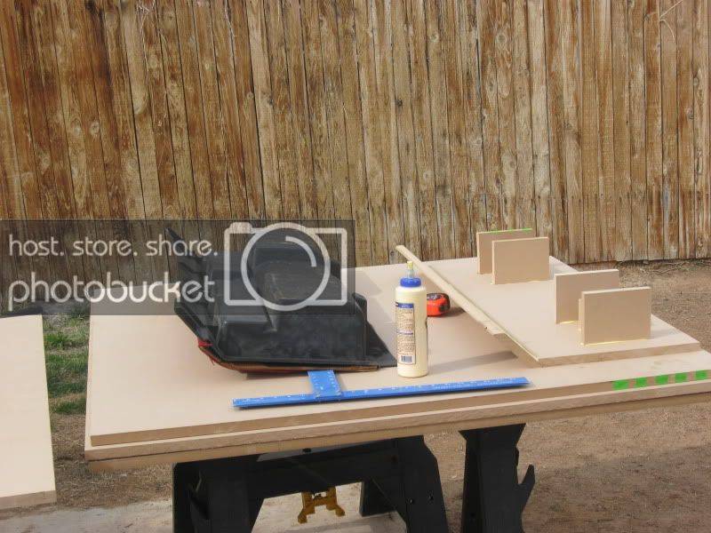

Here's a pic of the stock storage unit. Right behind it is a couple of the "T"s I made for the base.

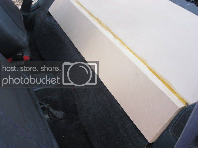

I placed them side by side and measured everything twice
There are braces supporting the front 45 degree board that don't show in this pic. I think it turned out pretty good for my first try... not to mention I was racing the storm clouds.
With a little trimming and squeezing:
Not a perfect fit, but a little duct tape and sound deadening, it'll do the job I need it to. I'll do a little more trimming before final install even though it passes the string test now...barely.

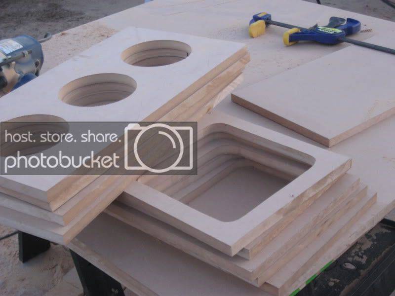

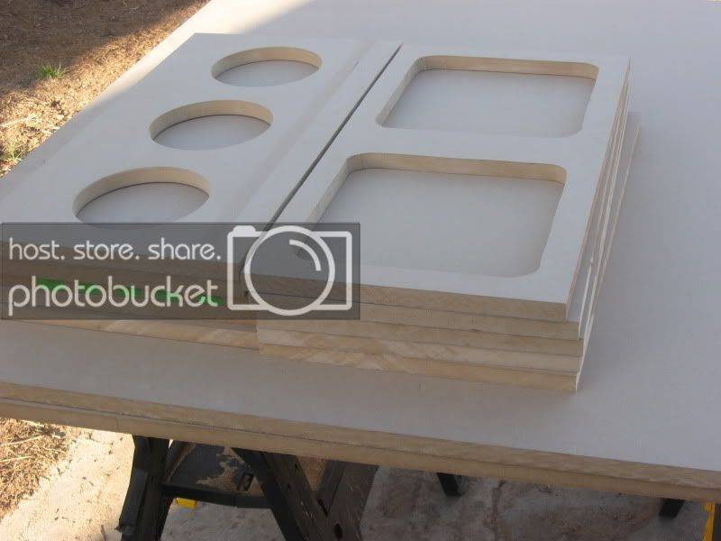

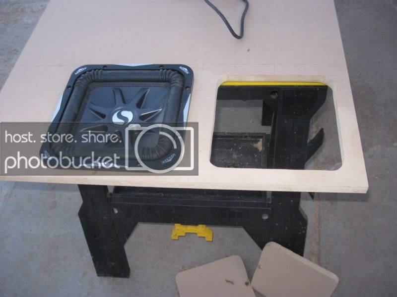

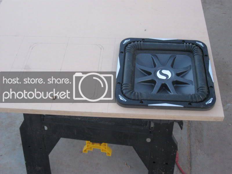

I made some square holes. I've never owned speakers I didn't make the baffle with a Jasper jig...
This if basically my jig now and I'll make every other baffle with a flush trim on my router. //content.invisioncic.com/y282845/emoticons/smile.gif.1ebc41e1811405b213edfc4622c41e27.gif I don't like measuring...

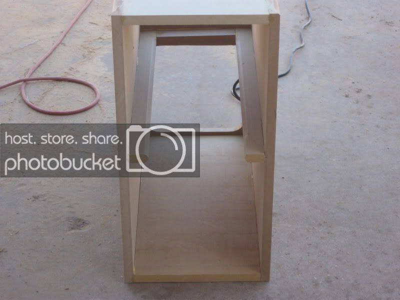

I made two boxes for testing. Both were made for 2x L7s. One is 1.4 cubes after sub displacement tuned to 61hz, the other is 2.2 cubes tuned to 43hz.
The simple insides of the boxes... not much room for bracing:

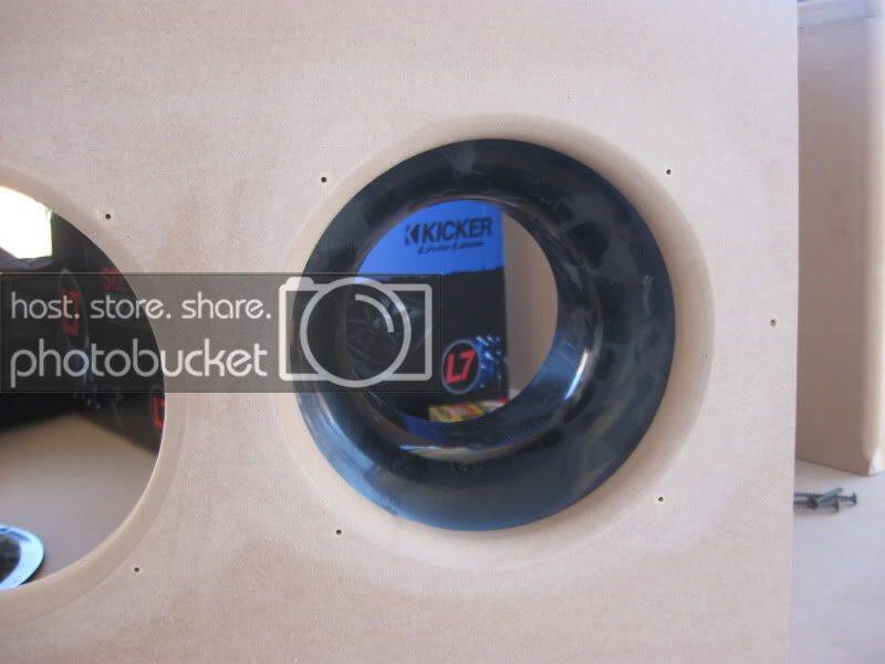

This is what the flares look like from the inside. I had to do this so I can test the flares on multiple boxes without tearing them apart to get my flares back.:

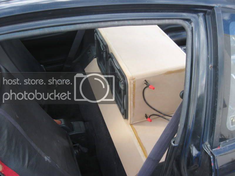

Subs mounted and wired:
Flares mounted:
Behind the b-pillar:

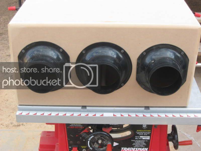

Ports duct taped on:

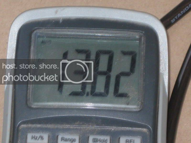

My new biggest problem... stock alternator blues:

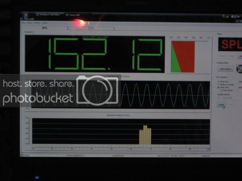

I dropped in my box for 2x L7s tuned to 43hz and got a best of 147.2 @ 47hz. I played a 65hz tone and did a 143.
I put my original test box from the last post and started moving things. I had a charger on the batts during all the testing so voltage wouldn't be a huge issue today. I made a couple of big changes and started with:
A few more tweaks and turns and I made it to 152 @ 65hz:
It was dark at that point. I think I can get a bit more out of this box and have a bunch of stuff to test on the car. I will probably take it to the show on Saturday with this setup.

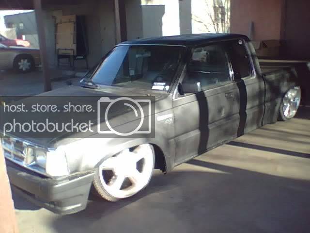

Helped my friend get his truck home.:
This bad boy set a world record for USACi stock 1801-3000 last year of 162.8. hopefully it does just as good this year in 601-1800... but does it laid out.
I did manage to move my ports to the inside of the box and got another 10th...
