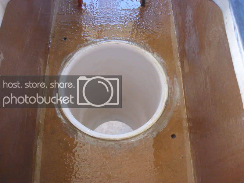

I then inserted my ports. They are 8" ID schedule 80 PVC. I cut them to length, then rounded over the ends. They were glued in with industrial strength liquid nail, topped with titebond, then I added a little more resin to the inside up to the ports... This batch was a really hot mix so it didn't turn out too great (Nothing a little sanding and waxing won't fix)

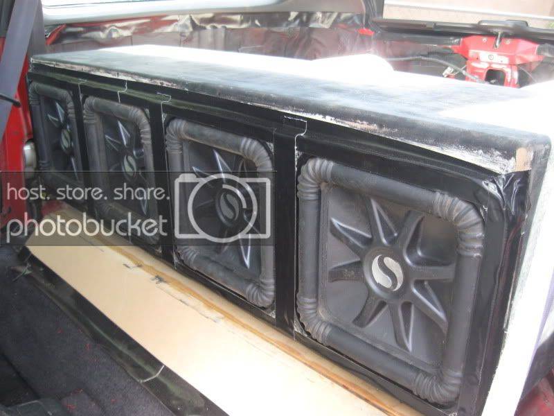

I got a little side tracked building a port reducer for a friend's box. He has 4x DD3512s powered by 2x DDM3s:
After playing with his stereo for awhile, I burped a 154.2:

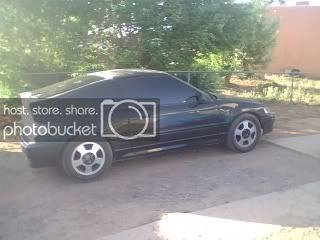

All I did this week is get the windows repaired (neither would roll down), inside door handles replaced (much easier to get out without outside help now), and get the windows tinted (which makes the car look much better):
