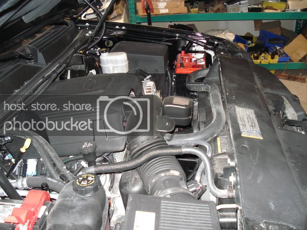

My older 1500 has an aux battery tray but his truck doesn't have one? I thought it should as well but the air box is right where the aux battery tray would go. His looks like this one under the hood:
the two trays for 99-06 afaik are one in front of the driver side electrical box, and two on the passenger side by the firewall behind the coolant.
