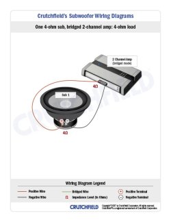

Im pretty sure the sub actually has one coil, im not entirely sure but theres only 1 place to connect wires to it. So it is hooked up at 4ohms bridged i think???
This wiring diagram is accurate to my setup and what i have it wired to currently. Whether the amp hates the sub or not i do not know, but this is how i have it wired. Again, it sounds great and works fine. But anything other than low to lowmiddle volume will smell like burning. Im not sure about airflow but the second i turn it up too much i can start to smell burning coming from the back so i would assume the airflow throughout the car is good as well.
Update: The burning smell is slowly going away at middle volumes. To the point where it only comes on at middle volumes. I adjusted the sub master volume on the amp from 2 to 10 which is right in the middle and sounds balanced on most songs and i only smelled it at higher volumes. So im going to assume it just has been burning off whatever it needs to OR it only wants to be controlled from the amp rather than adjusting it on the head unit. Its now at the point im comfortable and happy with it so its worth for me.
