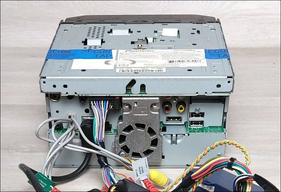

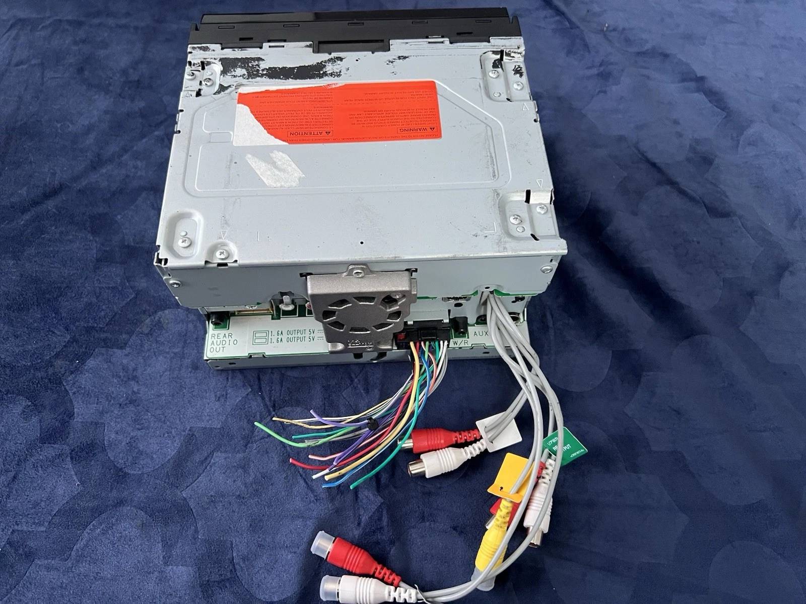

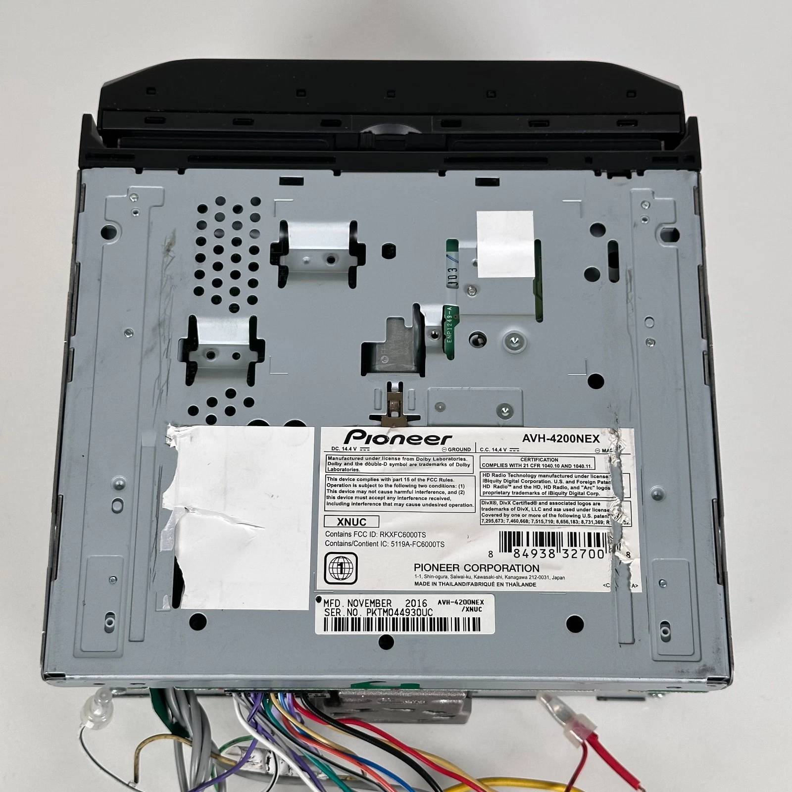

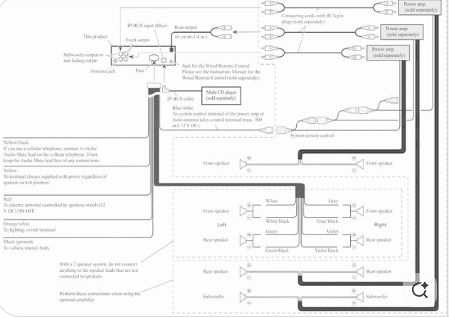

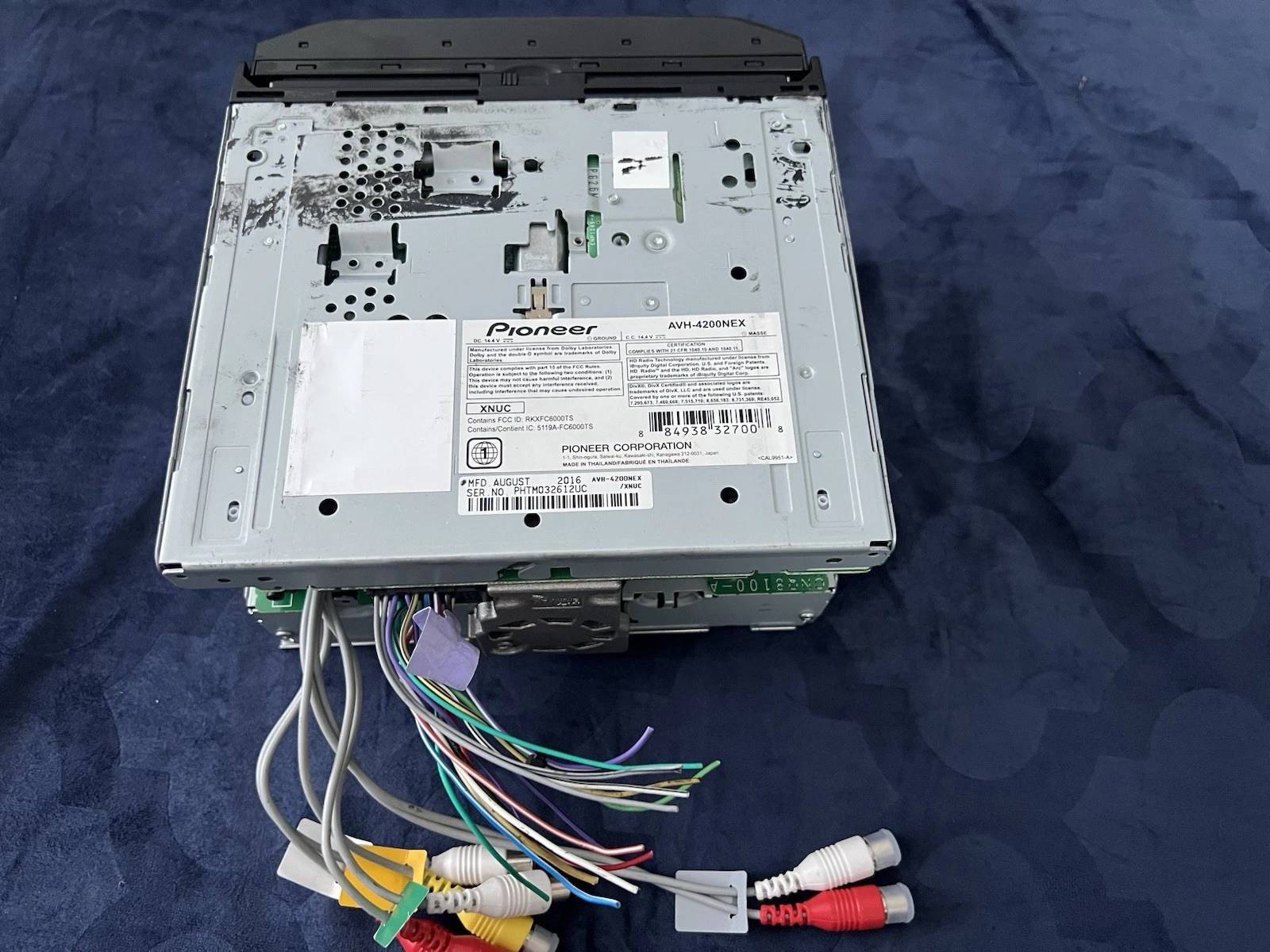

I’ll add that, when I have wanted to see the OEM harness on various stereos, I’d often go to ebay and find the same stereo in the “used” section, then look for photos of the harness, sometimes can find a photo that shows it well to see where the wires go. This sometimes take a while as many people do not have very good photos or can just barely see it plugged in the radio, but worth a look. Check active and completed listings, and it can take several different listings to piece it together. Might not help at all, but it has helped me in the past doing that.
Some quick examples after a search on ebay. Not the best, but can zoom in and get a rough idea what wire goes where in the connector.
