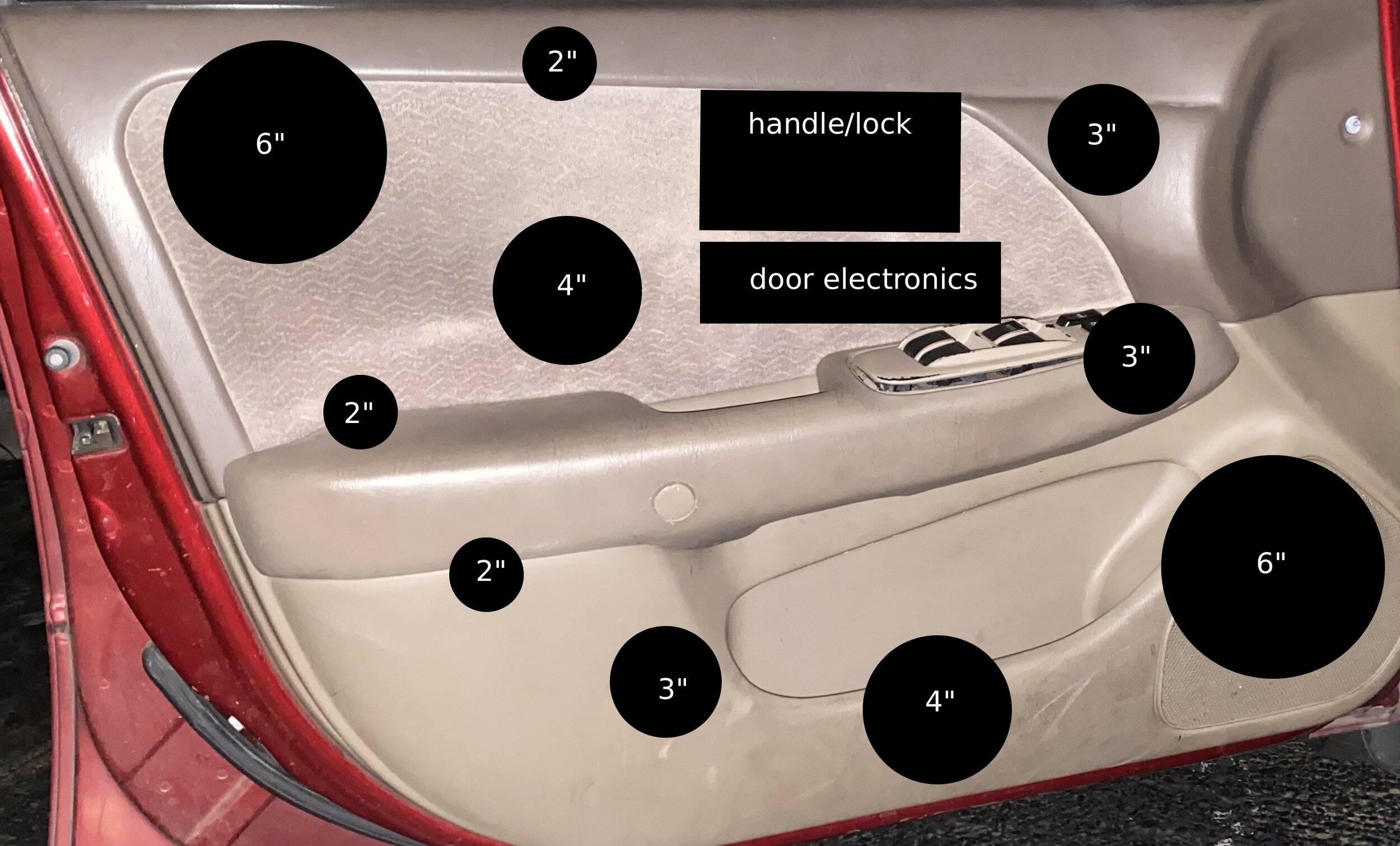

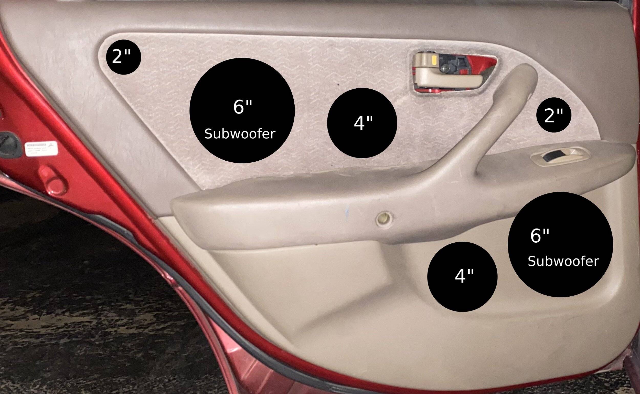

This is for my first project with car audio, I have experience with wood working and felt resin fabrication; wanted to know how this rough draft looked to others before i went ahead with any fabrication.

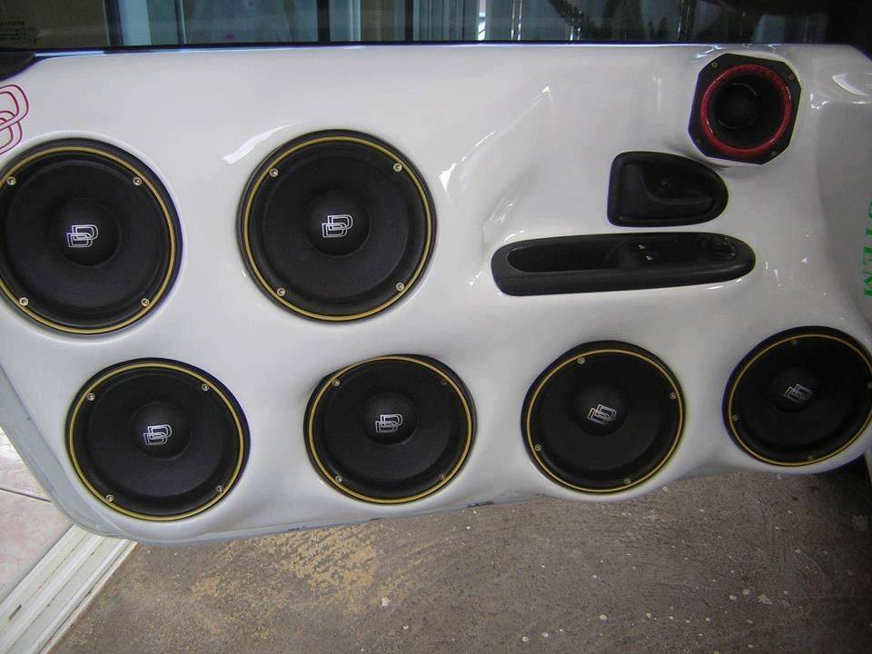

my plan is to keep the door handles where they are and relocating the door electronics to sit flush on the door, with the surface being smoothed and removing the factory contours besides funtional ones that allow the door to close. the odd photo out is kind of the style I want the finished product to look like.
any advice is helpful even if you think it might be trivial, this is my first time doing something like this and any feedback is valuable.
thanks!

Hey if that's what Mr phinneas wants it's all good just seems a little redundant
Personally i would at least rearrange the driver locations tho
I get it, but even in the same array or correct alignment, it is still/always a compromise to the staging, even if the equipment used is high quality and on its own produces decent quality sound - a set of headphones versus a large concert venue, just totally different goals.
The thought of multiple sizes, multiple tweeters installed, eek - the REW graph is going to look like a rollercoaster, a great ride, but not a great sound.
Some things cannot be "tuned" away; it's just physics.
If you want loud and high-quality (and very loud) sound, Stevens Audio is hard to beat!
Setups like that are more for the show, less the SQ go, and the final "look" of the arrangement, not the sound stage/imaging; they're mutually exclusive, and why I like to chime in when it's a new or relatively new install or someone who's inexperienced, or may not be knowledgeable of the difference.
I always recommend that people go and listen to pro-style gear for cars before they start cutting up your door card and laying fiberglass.
The "pro" circuit, "SPL" sound is not for the faint of heart.

I need a tweeter that can play 1500hz @ 12db think them Stevens SA-1 would be suitable?
I grabbed some older Hertz Space 1 tweeters that I'm told can handle it but I haven't had a chance to test them out.
Yikes, 1.5k?
Not many other than a few, but not at any real power. Might work with a slope greater than 24db, but even then, most tweeters exhibit one of two things at those frequencies, low power capability or high distortion, just the way it is.
What kind of power are you throwing at them? Why so low?
Yikes, 1.5k?
Tweeters will be powered off a Old School Sony ES amp 35 watts per chan.
I have a NVX component set minus the Tweeters (the SB speakers a few years back) and I'm told the crossover are @ 1500hz.. I could get the SB version of the tweeter but they are a little big for the planned location.
I was gonna put these in my ladies rig and she everything stealth as possible..
