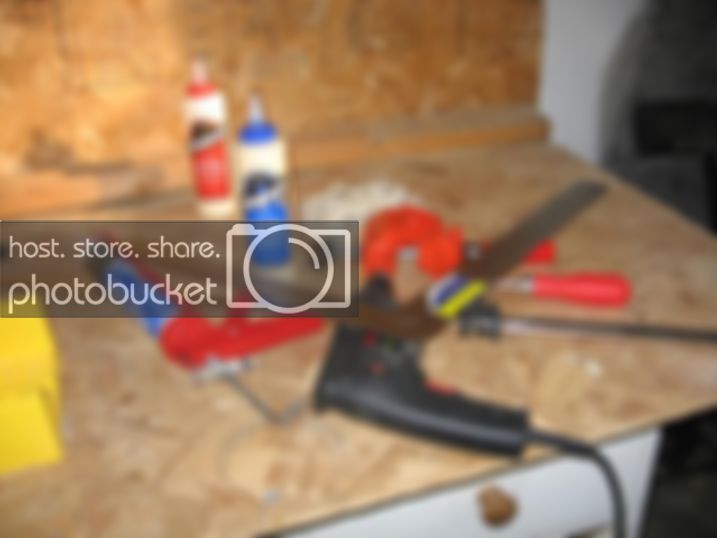

Some of the tools laid out. Check out that beasty angle clamp. I highly recommend them. I got it from Lowes for around $25 IIRC. The carpenter's square is also very useful.
I use the plastic bag there so that no glue gets on the bottom piece of wood.

where does everyone get those clamps? I wanna build my own box soon but I dont know where they get them. And price?
Any hardware store will have them. IIRC they are around $15-30 for the cheap ones depending on the length.

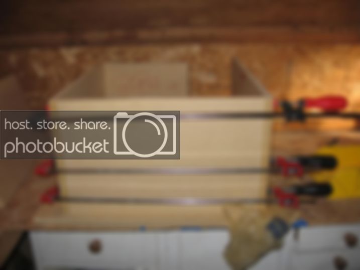

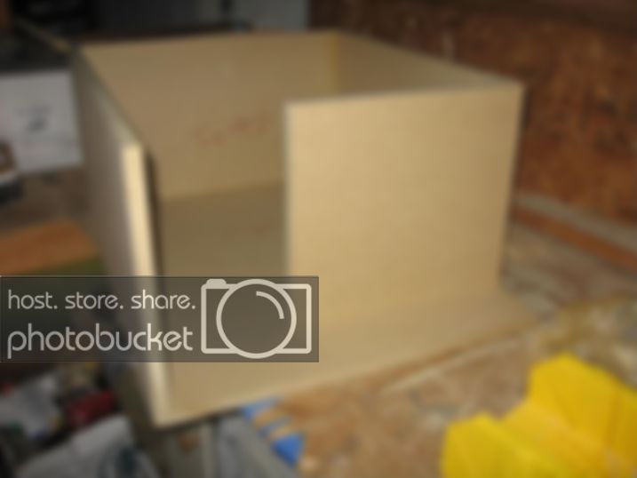

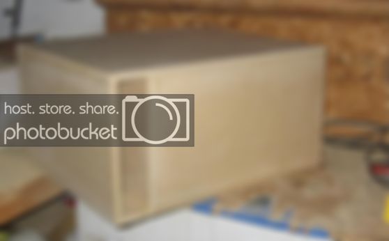

Here is my progress so far. You can see the router accident on the port. That is filled with wood filler.
