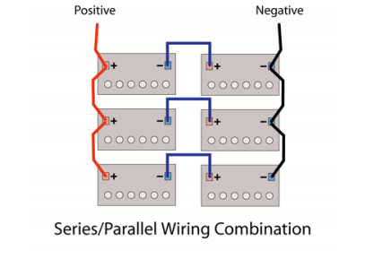

Ok, please disregard this statement. I am very uneducated (and somewhat a dumb dumb), because series is something like this:
30905
So, when I mention the videos, basically what they do is run a positive wire to the 2nd battery (no isolator), wiring power wire to amp(s), and appropriately grounding each of the batteries in their respective locations. On the other hand, I hear so many say they have to be in parallel and must match. What is the reason for parallel as opposed to just connecting them together with the power wire? Is it only so that you can double the amp capacity as opposed to just using the 2nd battery as supplemental dedicated for the sound system?

Wiring in series would cause 24 volts.
