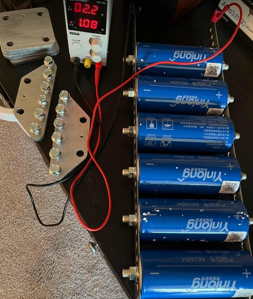

If a recall D4S shop says it is ok to run those Titan 8's with an AGM. They also informed me I could run their lithium cap bank with the AGM I have up front. Charge the Titan correctly before installing.
Those have 5x 10ah scib cells. Max charge voltage is 14.4. I would not recommend them.
All you need for a charger is a variable power supply from Amazon.
