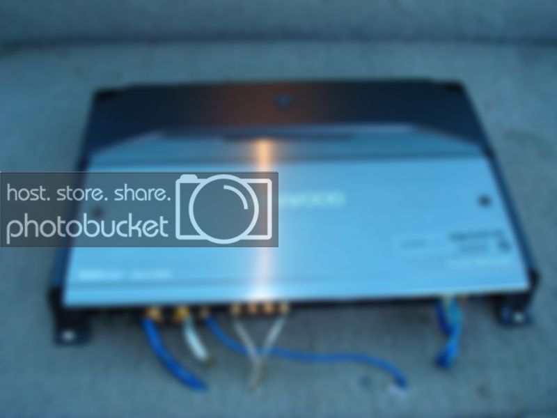

i had a kenwood, and the amp was on stereo, which i didn't know and neither did CC. they just told me my amp was bad. i was blowing fuses left n right. then i took the cover off my amp, cause i saw there was more buttons n crap in the manual. and noticed it said stereo and mono. i switched it to mono and never had any more problems.

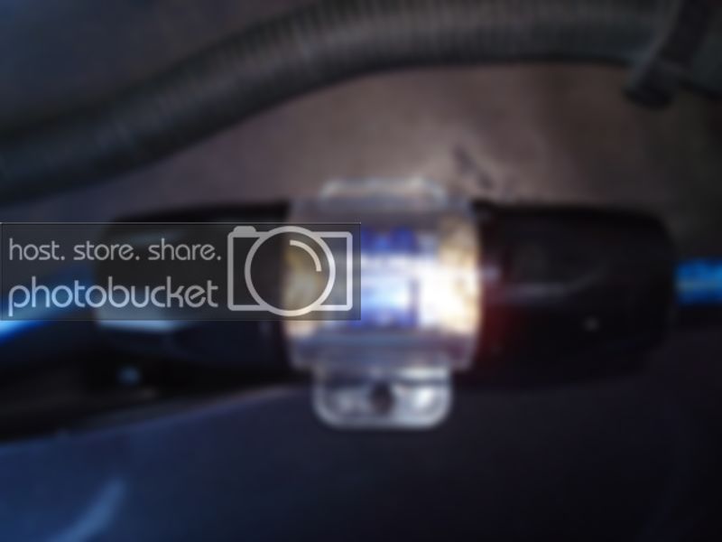

okay, so i went to a stereo shop today and asked for a bigger fuse, 40amp fuse is the highest for BUSS/ATC . so they gave me a fuse holder to replace the older one and a 60amp fuse, i still got the 8gauge power and ground wires.

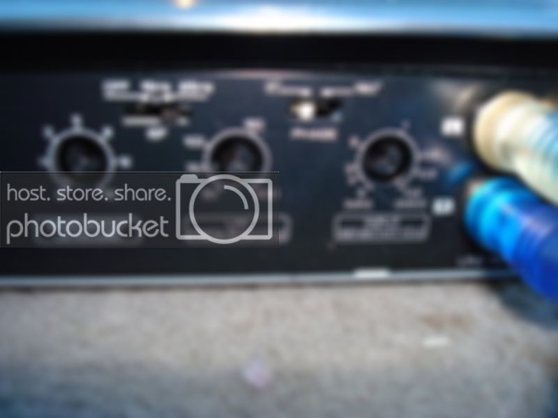

thats the setting it has 0 gain/ bass boost. the rest of the stuff is close to the max level
yeah turn all the bass settings down on everything, headunit and amp, aswell as the loudness setting. turn the sensitivity knob (gain) to the number 2 or a little below it, your headunit probably puts out 2 or 1.5v if its a standard non high end headunit. that knob is to match your headunits voltage output so you can achieve maximum rms power with a clean signal (if im wrong someone correct me please). if your setting that at max, its clipping the signal hardcore and its not good for the amp.
everything seems fine but now my lights dimm allot, what kind of capacitor should i get for the 900rms 1800 watt kenwood amp??
