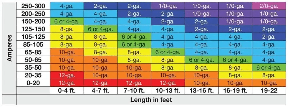

Consult this chart for that power and whatever length of run you need:
I would just run 2/0...

I’d say absolute minimum wire would be 1/0 gauge copper from the main battery to the back. Fuse the main wire at the battery with 250A fuse.
Then distribution style fuse block with two fuses near the amps (the type that uses ring terminals so you can get whatever ring terminal fits the wire and fuse studs), to spit the power to each amp.
The 4 channel would get 4 gauge copper wire, but fused at 80A since that is what it calls for, the 1500 .1DM would get 4 gauge copper wire too, but with a 150A fuse.
Could perhaps run larger wire at the amps with reducers, but I never liked the reducers and I do not think that's necessary, the short runs of 4 gauge would be fine.
