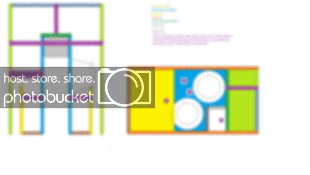

My budget will be $10k max. Less would be better but I know it costs to get loud. This will be spent over the next serval months so I can have all of the equipment and start building in October/November
This will be going in a blow through in my 1998 Toyota T100.
The height of the bed limits my sub size. It is only 17" high so I can only do 10s or 12s unless I just do single top and bottom layer in the box, then I could fit 15s.
I have about 26 internal cubes before displacement if all outer walls are doubled. That would take up the entire bed so I would have to fit the batteries in the cab. If we don't use the entire bed I may put the batteries behind the box.
I would like to do either a 4th or 6th order. I will be doing interchangeable ports. One for the lows, one to be musical, and one for spl if this is all possible.
Will probably do dual Alts and 10 or more g31 batteries
If you were doing this, what subs and amps would you buy? I'll figure out the mids and highs later as well as the box design. Just interested in equipment recommendations.
After the box, Alts, batteries, wiring, etc. I would guess I will have around $5k left over.

you don't need 10k. you don't need 5 k.
you need to build the box for the cabin and use the best subs for the cabin FR and box size.
6 cheap 12s walled off 4kw can get you into the mid 150s.
like 6 FI BL 12s.
this outlandish power crazy people go after to get loud is ridiculous. those inefficient woofers tat need 4-5kw to even get loud are foolish.
if your gonna wall it id do 3 15s or 6 12s something efficient. not those huge heavy coils with mms of 450 500 grams and a 3500 RMS power handling.
you have enough power on tap to break 150.
another good option would be 3 of the soundrive 15s ported with the 3500 they will easily get you into the 150s.
1kw or subs get another AQ run it at one ohm don't risk damaging your equipment for 200-300 more watts.
upgrade your alt and maybe two good batteries or one good battery and a really nice cap bank(alot lighter and does great for music and burps)
no needd to put 20 kw when you can do it with 8 and a well designed system.
if you gonna do a blow through do 6th order BP with the rear chamber the lower tune so the ports can be built into the side of the box and come directly into the cabin and the front chamber ported in the middle.
something similar will POUND
