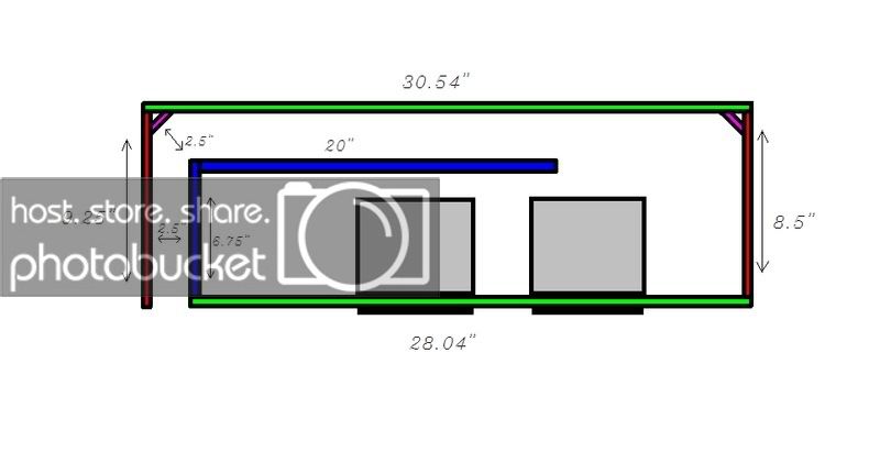

ok i did some more measuring..with my subs an inch apart and 2 inches from the end of the box..my port wall on the inside will be exactly to the outside perimeter of my sub..leaving the actual port wall about 2 more inches away from my motor on the inside. good?
if that makes sense
maybe this will help
sub mounting is 6'
port=1.5. that leaves 7.75''
so i have 1.75'' of clearence between port and sub
if i make the volume of airspace smaller..will that give me more room between port and sub?
or should port go in middle
