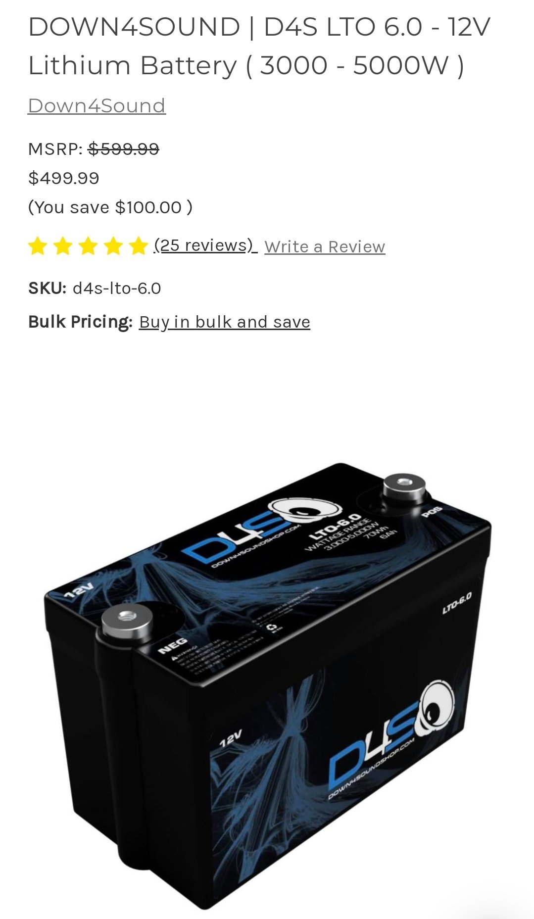

I’m getting a 2000 watt setup. 2 sundown sa V2 15” and the big 3 and a 3k-3.5k amp and I have a stock alternator I was wondering which lithium battery I should go with that isn’t more than $500-$600 that can power my system without having to replace my alt right this very second I want enough power and hopefully not much volt drop. Any feedback would be great thank you!
I wouldn't bother with lithium for 2k but...
You will need to remove the stock battery and run this alone.

Do you have to charge it?
It won't charge from the vehicle?
I missed a memo or something because the write up in the link above talks about alt charging and then recommends a charger to go with it
It also says you can run 5kw on it and a 100 amp alt which I'm thinking sounds to good to be true or I'm reading it wrong
Is it a way to get around having to put a new alt in or is there no avoiding that

Yes buying a charger is a good idea with lithium or AGM.
Yes your alternator will "charge" them but a charger to top off and maintain them is recommended.
They like a higher charge voltage than stock alternators produce.
Takes power to make power so no you don't HAVE to upgrade your alternator but it would be a good idea to get that voltage up higher.

I'll really puss him off now. Great company, fast shipping, and great customer service. Count the minutes to the dislike. Hooked another fish, again. I've caught this fish multiple times.
