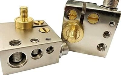

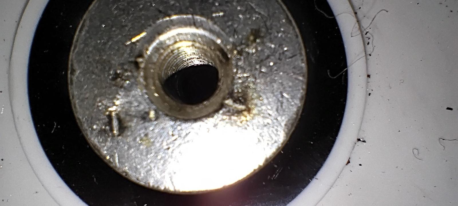

Not sure what to make of this, I assume it's from the many times i reconnected the the negative terminal and the screw made contact first. I use a Knukonceptz Ultimate Terminal v2.
My first initial concern was if this was caused by music, bad ground and hot terminal. I'm only using 650 RMS @ 4 ohms.

It's the negative terminal? What is the concern? I see some arcing marks but they are very minor. Looks as if it were loose.
To prevent this use a THIN split lock washer and tighten to 6lb ft.
I don't think the arch is from loose connection as I can't make it any tighter and upon removal it takes a minimum torque to loosen the screw.
My original concern is that I don't know what this is and if there's a way to prevent more arching marks. Always a big spark when connecting the NEG terminal, no marks on the brass side, so it must be from the screw making first contact when reconnecting.

There could be gaps between the two surfaces. Place a lead washer in between and tighten down. The softer lead should fill any gaps. Perhaps solve the issue... ya neva know.
