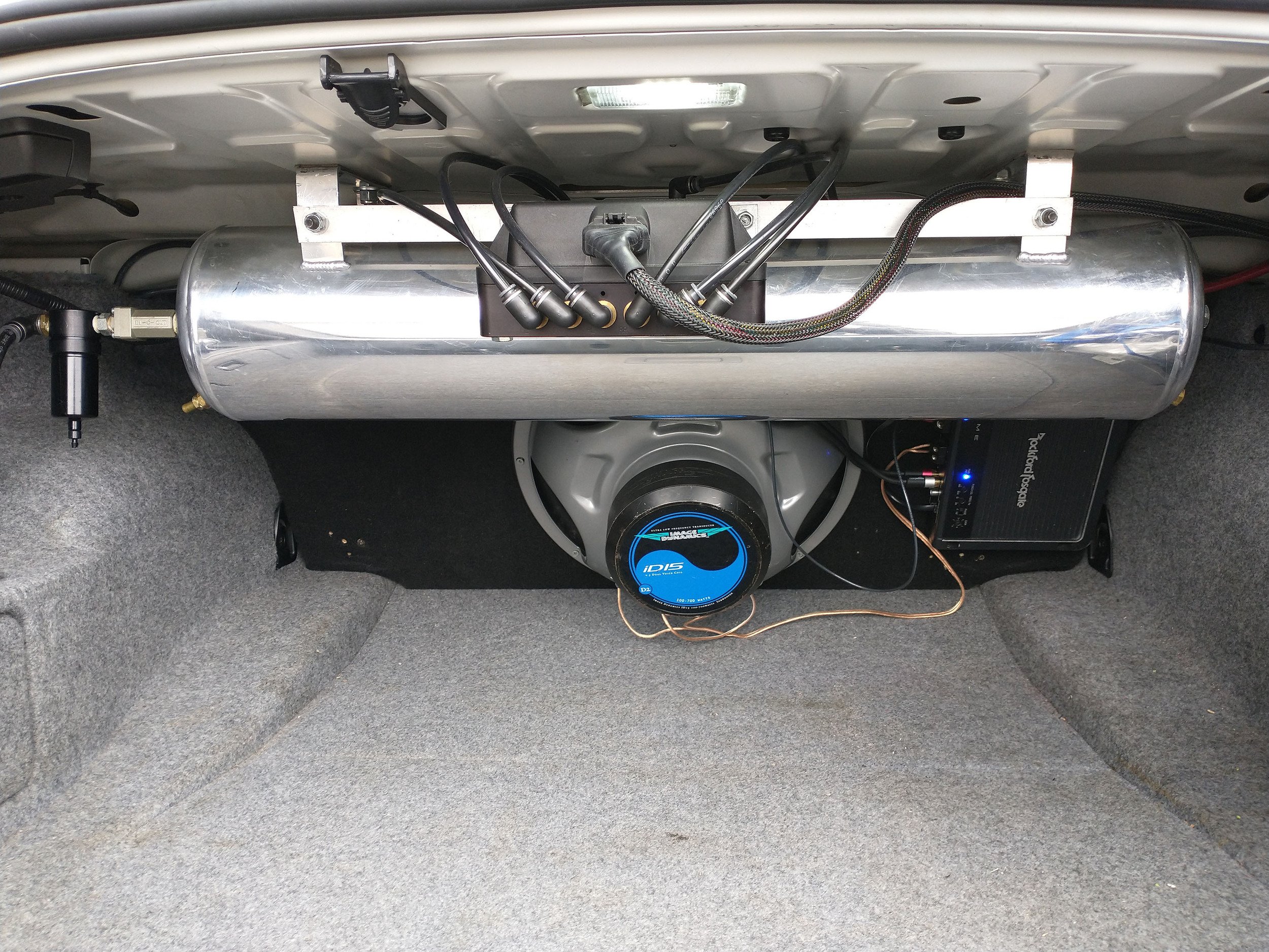

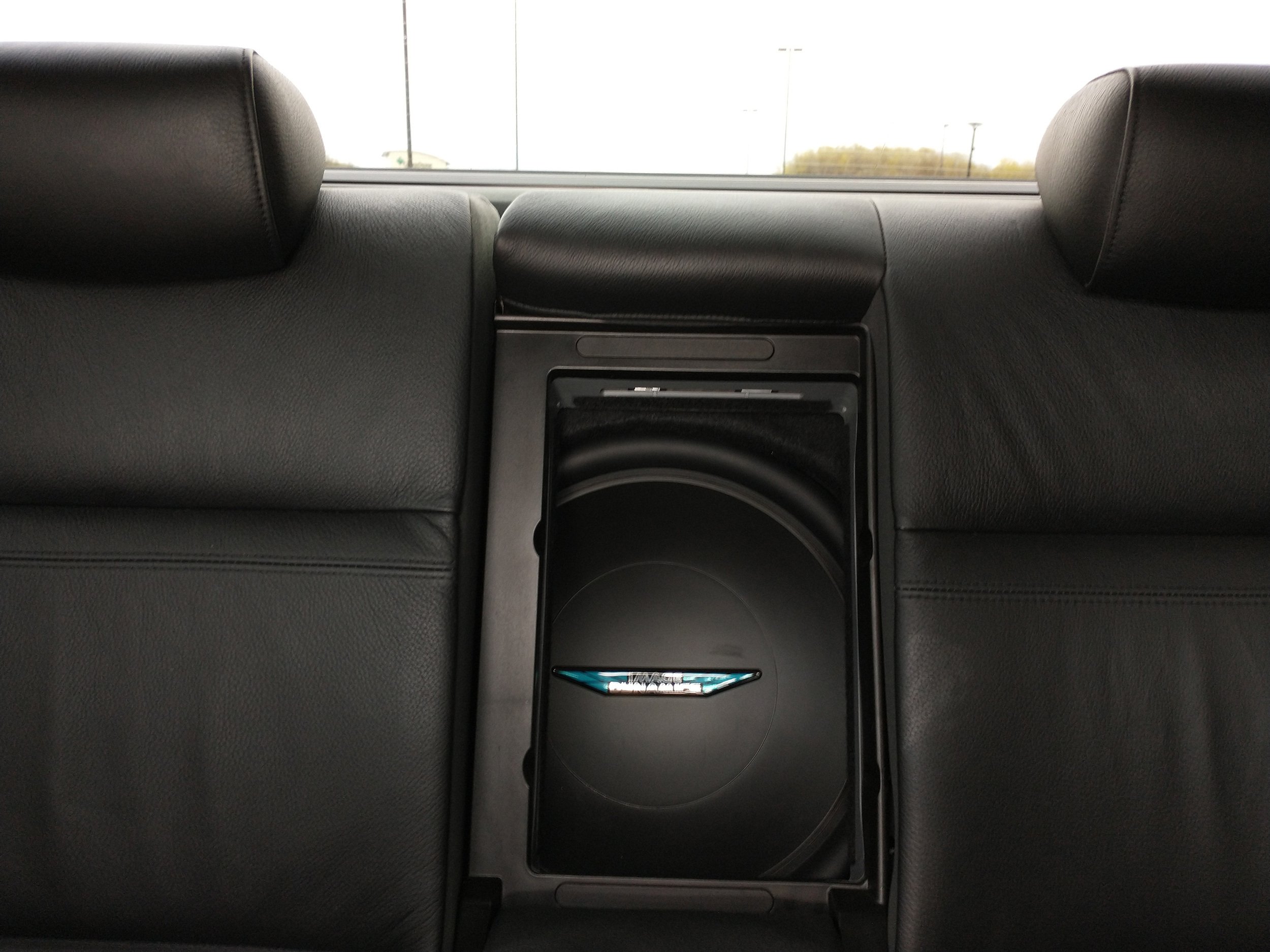

New guy here. I've had an infinite baffle setup in my bagged FBO BMW 335xi for years and have only recently really been trying to get the most out of it and understand where the limitations are. Here are some photos and the specs on my setup before I get to my questions:

My questions mainly revolve around what the best settings on my amp and knob are to get the most out of my setup, and if changing them really make any difference at all. At the present moment, I have the gain setting on the actual amp at around 5 out of 11, where the knob is almost completely turned all the way down. If I click the knob up from 0% until about 5%, the sub volume increases nicely but drastically, until I can tell the signal starts to clip. The overall volume of the bass from the sub is quite high at this point, but what really concerns me, is that the cone of the sub is BARELY moving/flexing at all, even at its supposed maximum clean power. If I look closely, I can see the IMAGE DYNAMICS logo vibrating, and if I were to gently hold my finger near the cone, I can clearly tell it's vibrating, but I'm wondering why it's not "flexing" like any other sub I've ever seen. Is that just how free-air IB subs operate without a baffle/enclosure to modulate the air?
So, I'm wondering if there's a "right way" to use the knob and gain setting on the amp in conjunction to optimize the sub's performance. I feel like the sub can output significantly more power, but just needs the right combination of gain/knob tuning. Maybe instead of having the gain on the amp so high, I can turn it down to maybe 2 or 3 out of 11, allowing me to turn my knob up higher to get to that sweet spot. Though, I'm not sure how that would make a difference, since again the knob should only be turning down the amp's gain setting.
TL;DR - Why is my sub not "flexing," and begins to clip at such a low power/gain setting.

Cone movement becomes exponential as you halve the frequency. If you're playing normal music played on instruments the cone shouldn't be pumping all that far peak to peak.
You may try to download or buy a "bass mechanic" CD or similar and throw some test tones at it. I'd wager once you dip down to and below 30hz you may start getting closer to physical limits of your woofer.
Really you probably could get away with a bigger amp if you find you're not near mechanical limits and the coil isn't getting overly hot.
In the meantime you should probably dial your gain down if only a small percentage of the remote knob is enough to hit maximum unclipped power from your amp. I try to aim for 50% of the dial with loud/modern recorded music, that leaves you some flexibility and room for boost when you play older or low record quality tracks.
If you're just looking to get louder you could go to greater lengths to completely seal off the trunk from the cabin. That's a tedious job though and it will be hard to pull off and keep things looking as clean as they do after.
