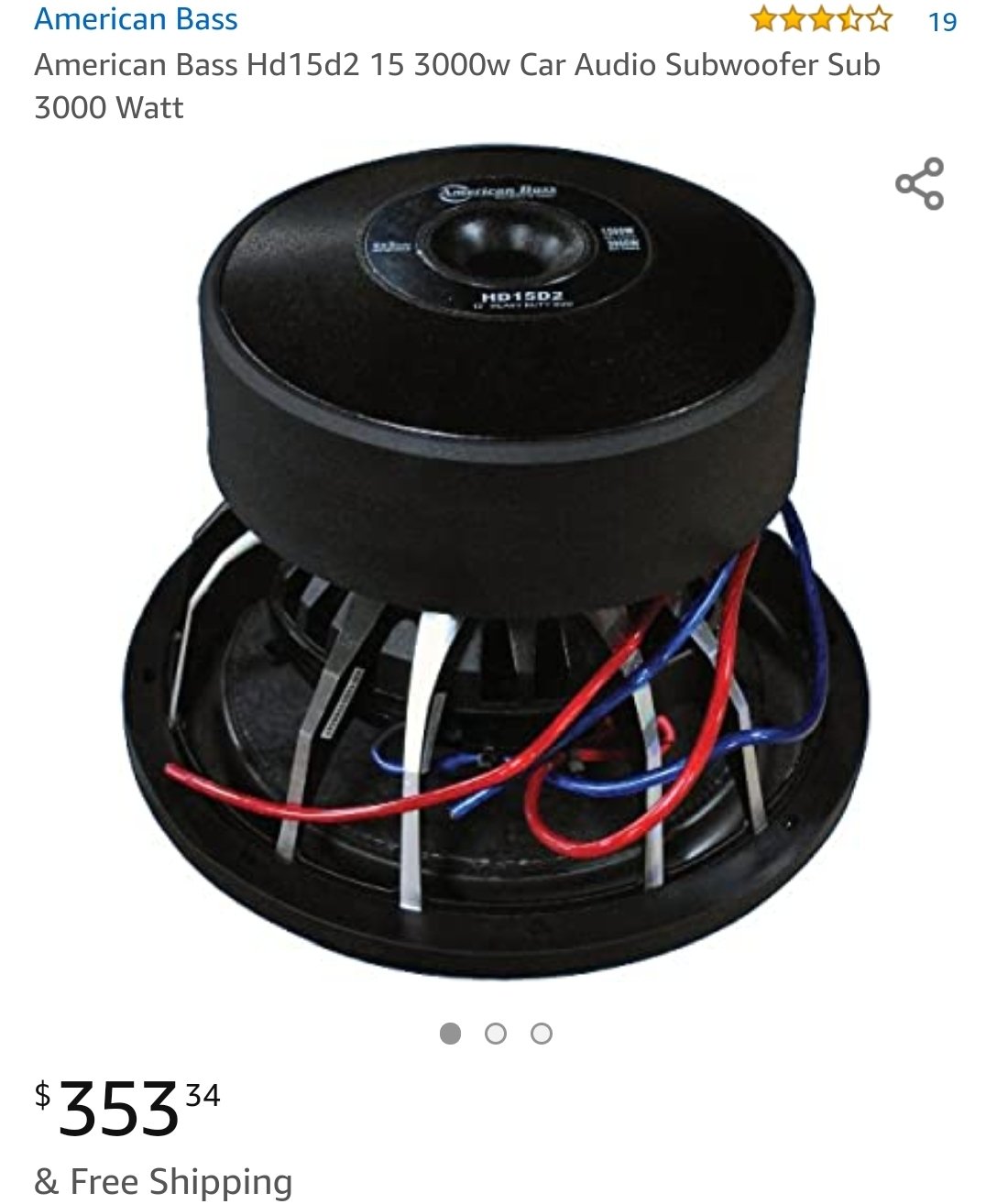

haha You're fine after much thought im going to scrap that build because it wont really be much of an upgrade. Im thinking some HDX 15's now on 4500w. We will see still working out some stuff.
I have an suv so a fair amount of room. I measured 40x27x27 worth of free space with a little lee-way. that come out to about 16 cubes. I think 9 cubes after port and sub displacement should be good what ya think ?
That sounds about right. Just add the sub displacement, port displacement, and bracing displacement to come up with the cubes that you need to start with. Probably going to start somewhere around 11 cubes.
Good looks bro, going remeasure just to make sure but this is looking good.
I'm running this 15" on an MD3000 and love it. 4 cubes tuned to 32hz.
