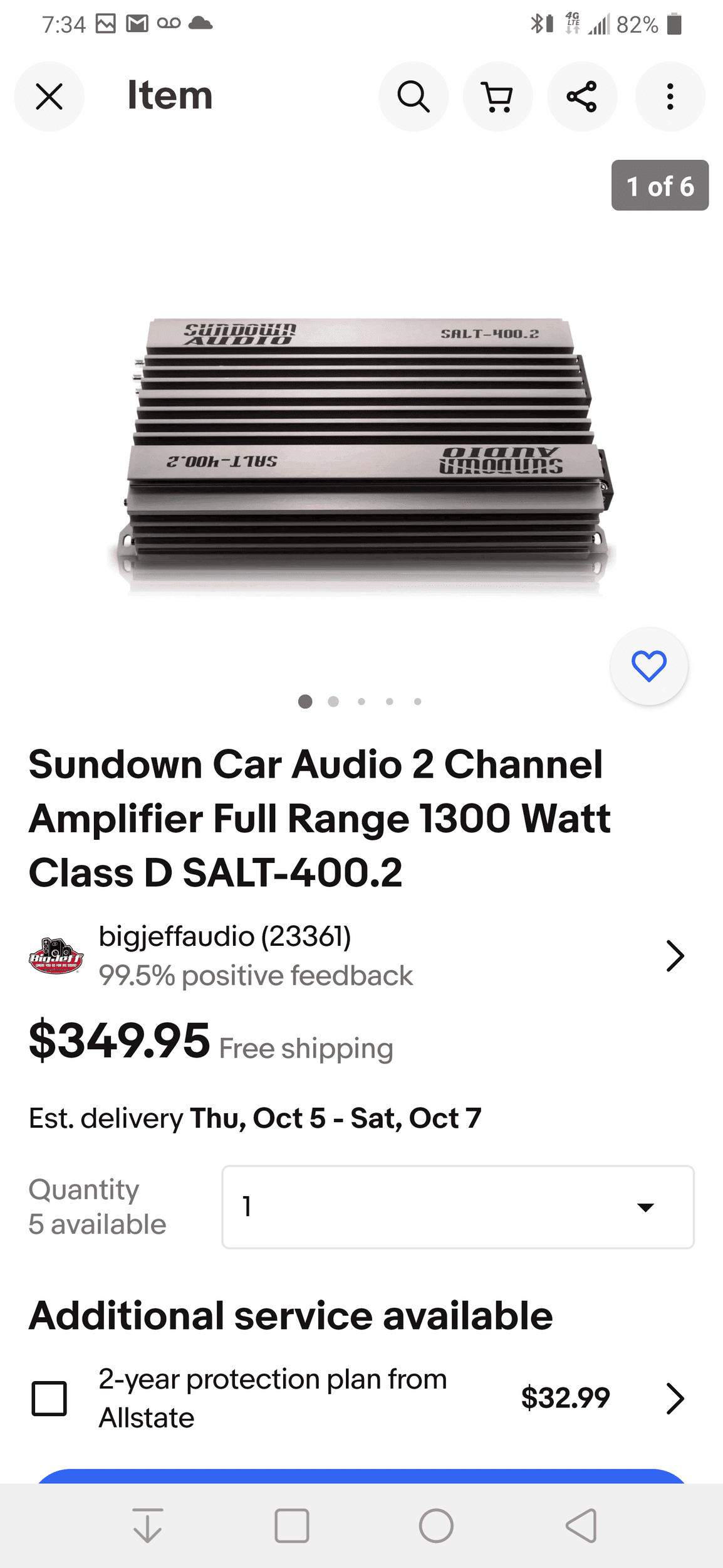

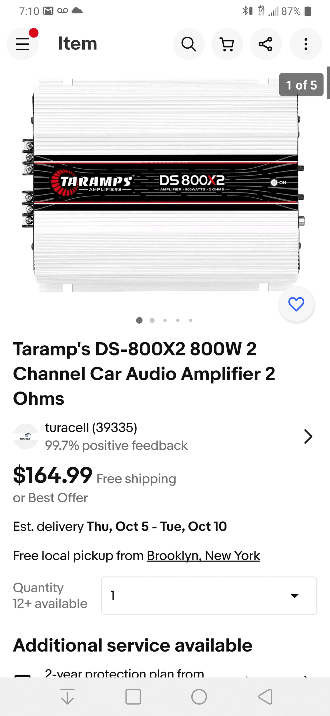

Any amp in the list above works just fine. What you need is one that plays 500+ watts a 4 Ohms. For that your best bet will be a Full bridge amp or 2 channel amp. You should be fine with a full bridge since it will only be 500 watts. These two amps should fit your needs.

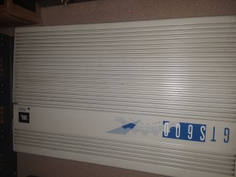

Ive got a really Clean and Dammned good JBL GTS600 if you have an interest,that I could part with. Ive used it @4 ohms on a pair of JL 10s in the past and usually ran on front stage with a GTS300, and used either 2 or 4 GTQ400s on substage.
Do some Searching.. You may be able to find a great deal and even an old school gem?
