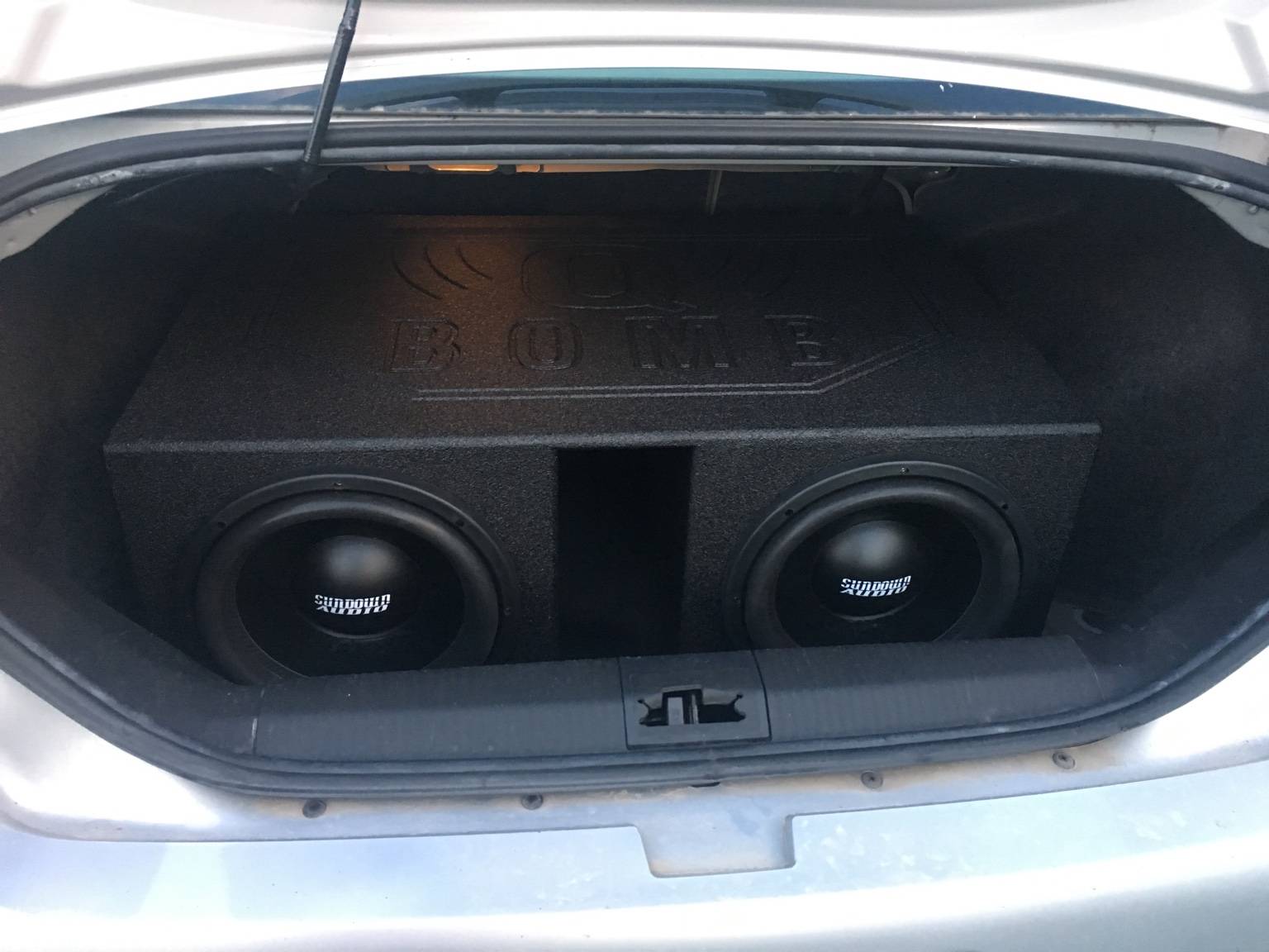

I have 2 SA-12s on a 2800 AD DB drive amp with 0/1 gauge wiring. JVC Head unit. Also with a soundstream B20 bass processer. The box is custom made for SA-12s 1.75 cubic ft. I have about 500$ and trying to get louder. I do have a stock alternator but it does produce 15v. I had to get a new battery after I installed a capacitor. Please leave suggestions. Thanks

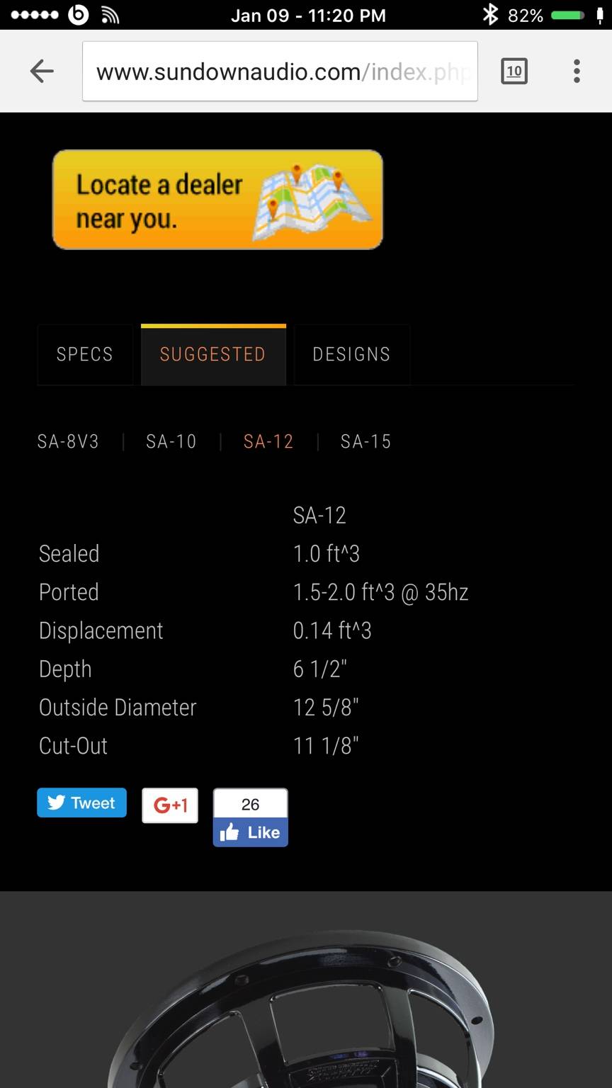

box seems a bit small to me, I think those subs like 2 - 2.25 each.

I'd at least take the time to do your big 3 in 1/0 you don't want to skimp on the electrical, & if you managed a 4cf box then you should have enough room as stated there going to like a box that's bigger because recommended is 1.5-2.0cf per woofer.

I have a 1.75 box for them now that was designed for them, the black box was the old one. This is the only video I have of the new box tuned at 35. Also in my opinion this box is louder. https://vimeo.com/198790835
