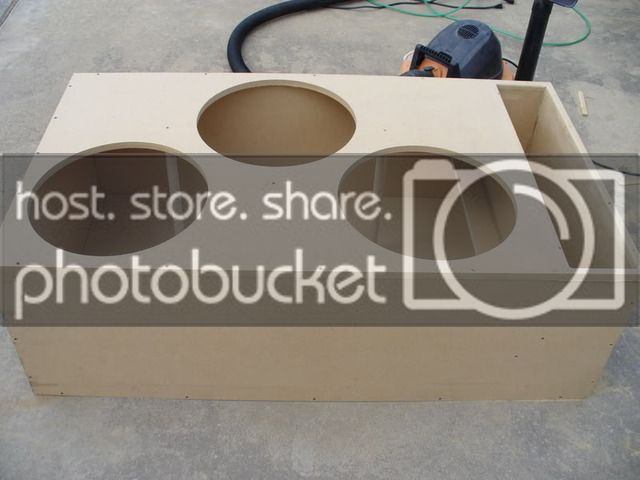

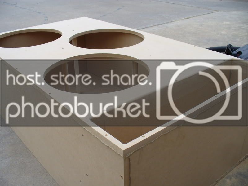

Well, I had some issues getting the boxes in my truck, so I had to scrap that idea...I could have sworn everything measured out ok...oh well, stupid me for not being meticulous enough. So, today and yesterday I made a box for three of the MJ-18's instead. It's 14ft^3 tuned to 33-34hz...
