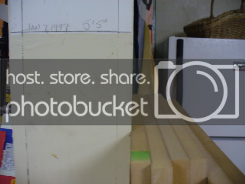

So I finally got around to getting all of my cuts done since it was raining like no other last weekend. The wall will consist of four MJ-18's (4 ohmers) run off of a Sundown SAZ-1500D at 1ohm (obviously). Each box will be 9ft^3 tuned to 33-34hz. I just thought I'd start this so you guys can see the progress...
Miscellaneous pieces...
5 feet of pure joy.
Long shot of all the big pieces.
I can't wait to finish this thing and see what kind of numbers it'll put up.
