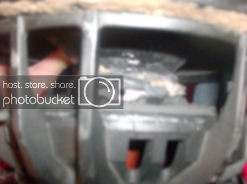

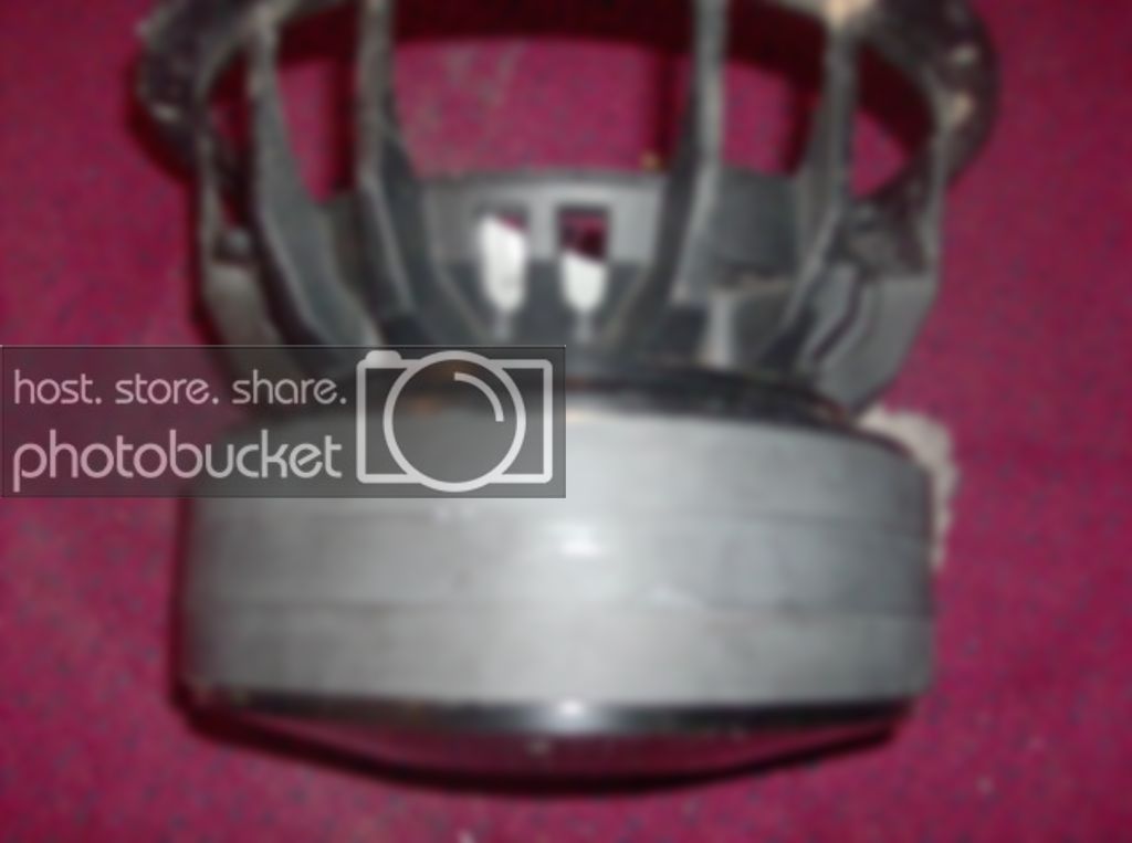

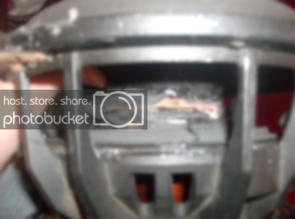

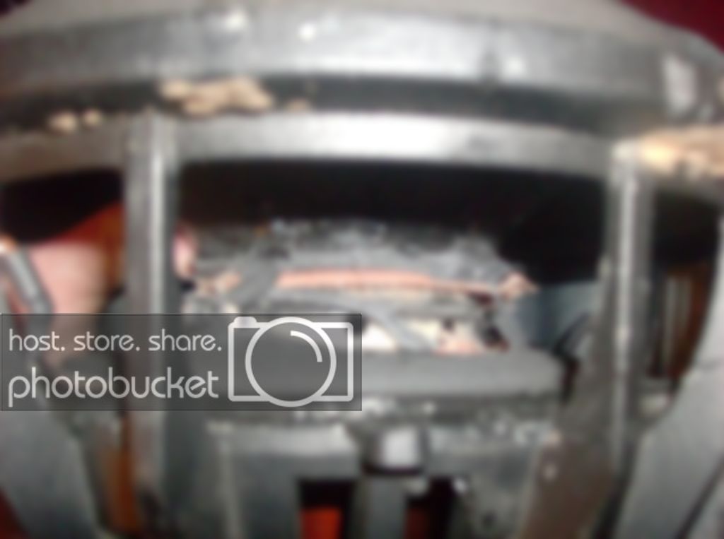

Once again everything is in good shape coils,surround, tinsel leads, cone etc.. Just ripped apart the spiders. LOL
All that damage and I was still able to post a 150.1 in Street C. Not to bad is I do say so myself.
It's hard to keep em together when the car peaks at 40hz. LOL
DJ added some extra love to my new recones, which arrived today in NY, so hopefully this won't happen anymore but what do ya expect...LOL they are only rated at 1k rms and have been seeing well over 4krms apiece.//content.invisioncic.com/y282845/emoticons/laugh.gif.48439b2acf2cfca21620f01e7f77d1e4.gif

So do you know whats making them rip apart?Is it from playing below tuning possibly?If your peaking at 40 what does your box cut off at?
he's peaking at a frequency where the subs move alot and sending a shit load of power to them.

He's peaking at 40 which means the box is probably tuned in the low 30's with a peak freq of 40hz.With that anything below 32-30 hz he would basically be free airing the subs.And with 4k to each I'm probably sure there moving quit a bit.
I'm not saying its wrong just asking if he thought this might be part of the problem.
Its just a short bandwidth and I am having similar problems with my set.So I was looking fro input.//content.invisioncic.com/y282845/emoticons/smile.gif.1ebc41e1811405b213edfc4622c41e27.gif
He's peaking at 40 which means the box is probably tuned in the low 30's with a peak freq of 40hz.With that anything below 32-30 hz he would basically be free airing the subs.And with 4k to each I'm probably sure there moving quit a bit.I'm not saying its wrong just asking if he thought this might be part of the problem.
The box is actually tuned to 43hz. With the colder weather it peaks a little lower. They do move more than I would like which was in direct relation to the size of the box. Once I get back in NY I will be shrinking the common chamber down to help compensate for that.//content.invisioncic.com/y282845/emoticons/biggrin.gif.d71a5d36fcbab170f2364c9f2e3946cb.gif
