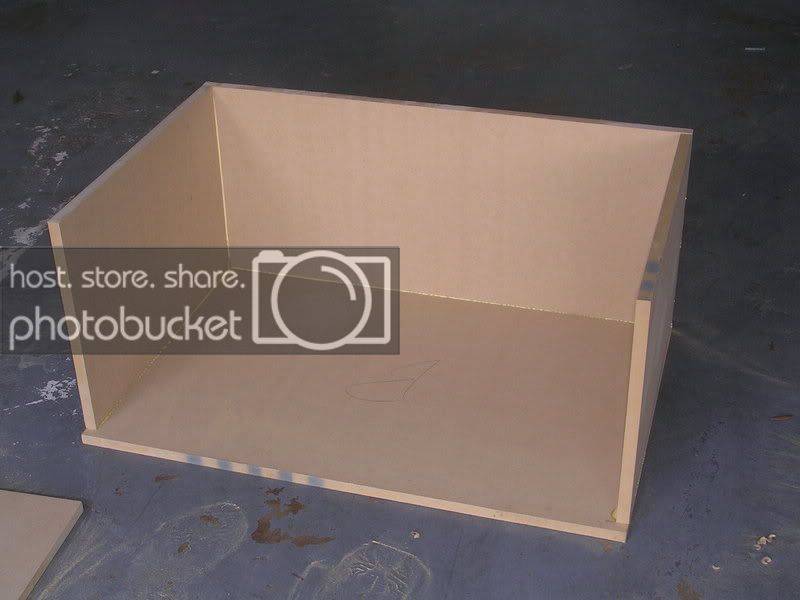

Sub Box: 7 cubic feet before displacement ported (see photos

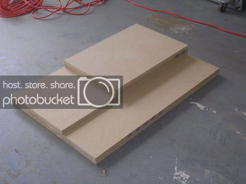

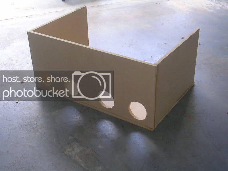

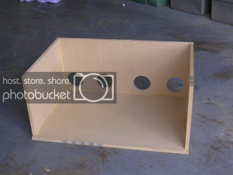

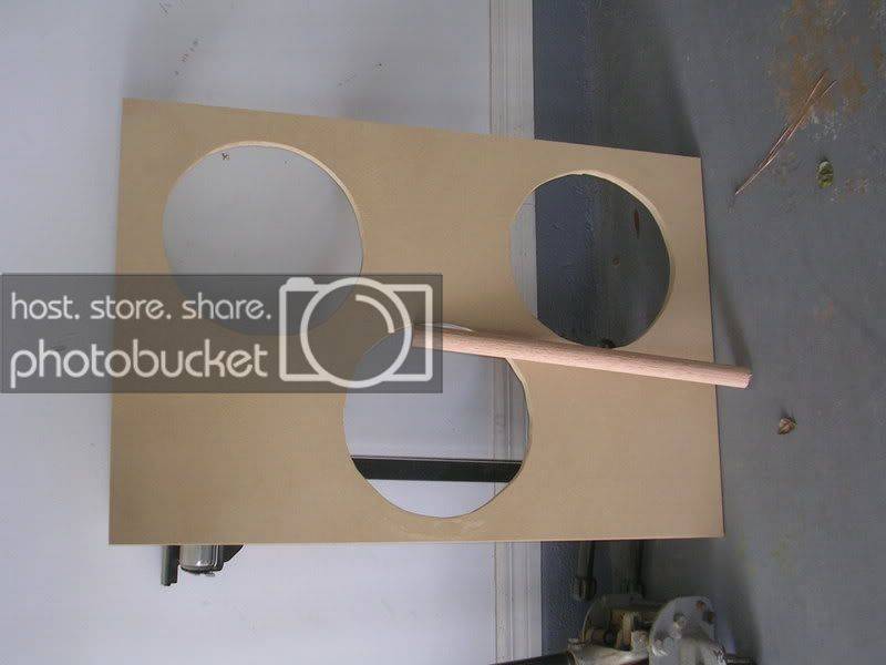

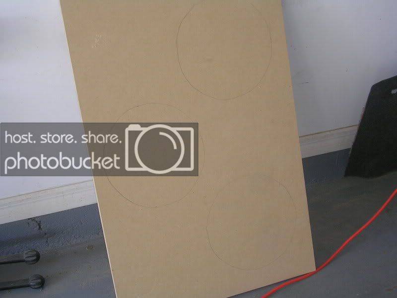

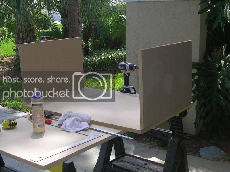

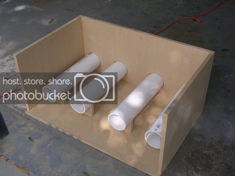

Ls2poweredgoat is building the box
Pics:

so you have 2 runs of 1/0 wire. one 150amp fuse and one 200amp fuse? why not get two 200amps or even two 250amps?
with 3 subs in the top your going to want to double up the wood. just make 2 layers on the top so it doesnt flex so much. glue and screw them together.
+200 amp fuse + Distroblock 40amp fuse to 4chn amp, 150 amp fuse to sub amp + amp - ground
x2 on the fuses...
and kinda x2 on the double-baffle...but I believe bracing would be more effective..
