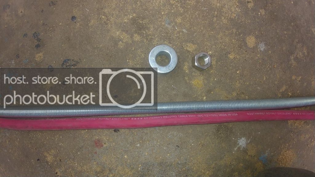

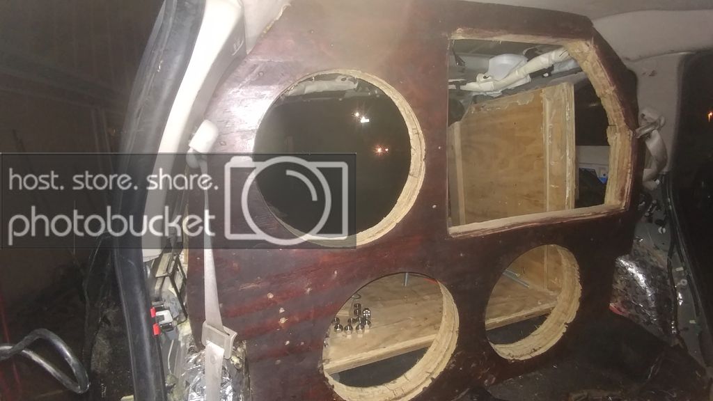

Lol good point hispls about building everything else...here's an updated picture of what i have so far....what do you think about that? Obviously i have to fix the bottom part lol, I'm going to do that here shortly so it'll go down at an angle and meet the bottom of the front baffle like its supposed to.....and yes i found out that the resin wasn't a good idea...well it was but i got to impatient because i didn't mix enough hardner....so it took all day to dry.....oh well lol. So I've got 5 layers on the baffle and three pieces of 36" threaded rod for bracing. The picture of the rod is next to 4/0 for size comparison. And I'm going to make the right side have a 90 degree and go over the top of the battery on the wheel well

Hey buddy, its looking alot better and it looks like you have built it so you can replace the baffle later if need be ? I think hispls knows what he is talking about and you could try it with two subs next and see whats louder. A Lot of these guys been around the block a time or two doing this stuff. I know sometimes we just want to try things too, but sometimes we end up wasting a lot of cash in the failures.
Well yes....but i have to make them first lol...then I'll shrink it from there
Looking a bit more like you give a **** about things this time. For bracing, just hold off until it is playing and put your forehead to the box, flex problem areas will be obvious and you can brace where needed,
Honestly 2x4 for braces is fine for your goals but doesn't look as pretty, and it's always best to build the thing bomb-proof to begin with as opposed to putting band-aids on after doing it weak.
As far as port depth, you may not need any. The side walls (keep them straight and strong) will "extend" the port. Assuming that port is 20" wide and your baffle is 4" thick, the port will behave as though it is 14" long as you have it. Do take your time to round over those edges on port mouth.
You can lengthen the port by screwing sections of 2X4 to the back of the baffle and lower tuning a little as you go to test if needed.
