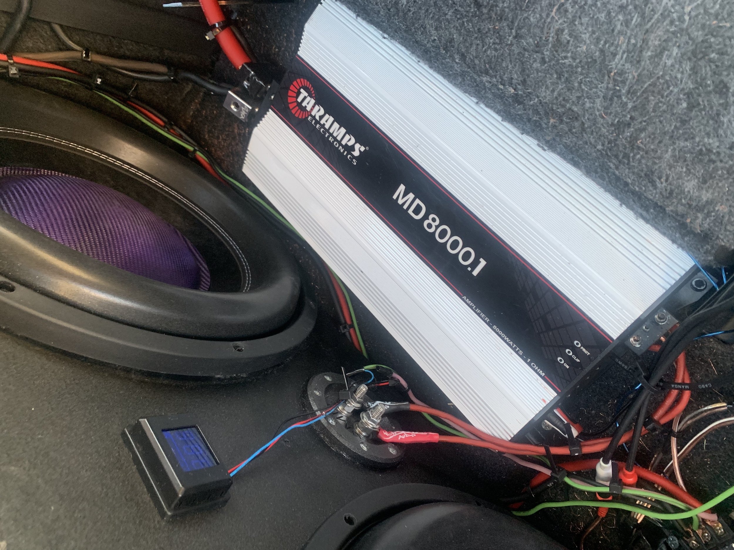

I will try this however I plan on getting a 300 amp alt. I don’t Necessarily want to run my amp on the absolute minimum I do however think this speaks to the durability of taramps . Like I said I’ve been beating my setup into the ground no issues and it’s louder than any Korean I’ve had ... basically all I’m saying is even w slightly weaker electrical these will perform how you want. Beef it up it’s even better. The clip light is super accurate what is there not to like about Brazilians. Other than the fact that you can’t wire them into the dirt which is not what I plan on doing anyway. Taramps really are the future for daily driven 140 db+ car audio setups in my personal opinion and experience( for size and price). I was simply asking if I could expect the same results from a 12k and honestly I probably could run it for awhile on my electrical. If I’m not clipping it and just using it how I use the 8k but I’m sure it would blow my 8k out the water in terms of output. That’s just what I’ve seen from personal experience. Probably won’t try it tho I need an alt before more amps

And It did from the 5k to the 8k way louder and easier on my electrical I see less voltage drop now. I know that math of the electrical doesn’t add up and that’s the bottom line. But I’m sure putting the 12k on would be a lot louder. I really don’t see why it wouldn’t. Especially if it got louder w the 8k. Not saying you should go put a 12k on every stock electrical it’s just stupid not smart. But maybe w a lik experience and know how you can make it work. I have 60ah of agm In the back and dual runs of sky high ofc 1/0 into the amp. My wiring is top notch just need more batteries tbh. These amps really need that constant 12v for their power not 14 it makes sense that big reserve of batteries could also give these amps what they want.

$1400 roughly it cost me for what I deem to be close to the minimum to power my Korean 4K, I agree with some of the posts above for sure. Even that 8k will require an alt, batteries and wire upgraded from the current setup to do really well... buying a 12K makes NO sense till the Op gets the current amp fed decent (alt, decent reserve, wire... etc).
you’re basing your recommendation to do something On the opinion that you think it pounds hard and it’s worked so far, not based on how vehicle electrical power actually works. You’re going to do what you think anyway and that’s cool but pause on advocating that anyone without experience , proper budget, or trying to “bass fast” put amps that size on stock.

or maybe if you read what I wrote you’d see it’s working fine but nah you just wanna know best so go ahead and act ignorant to everything I’m saying
