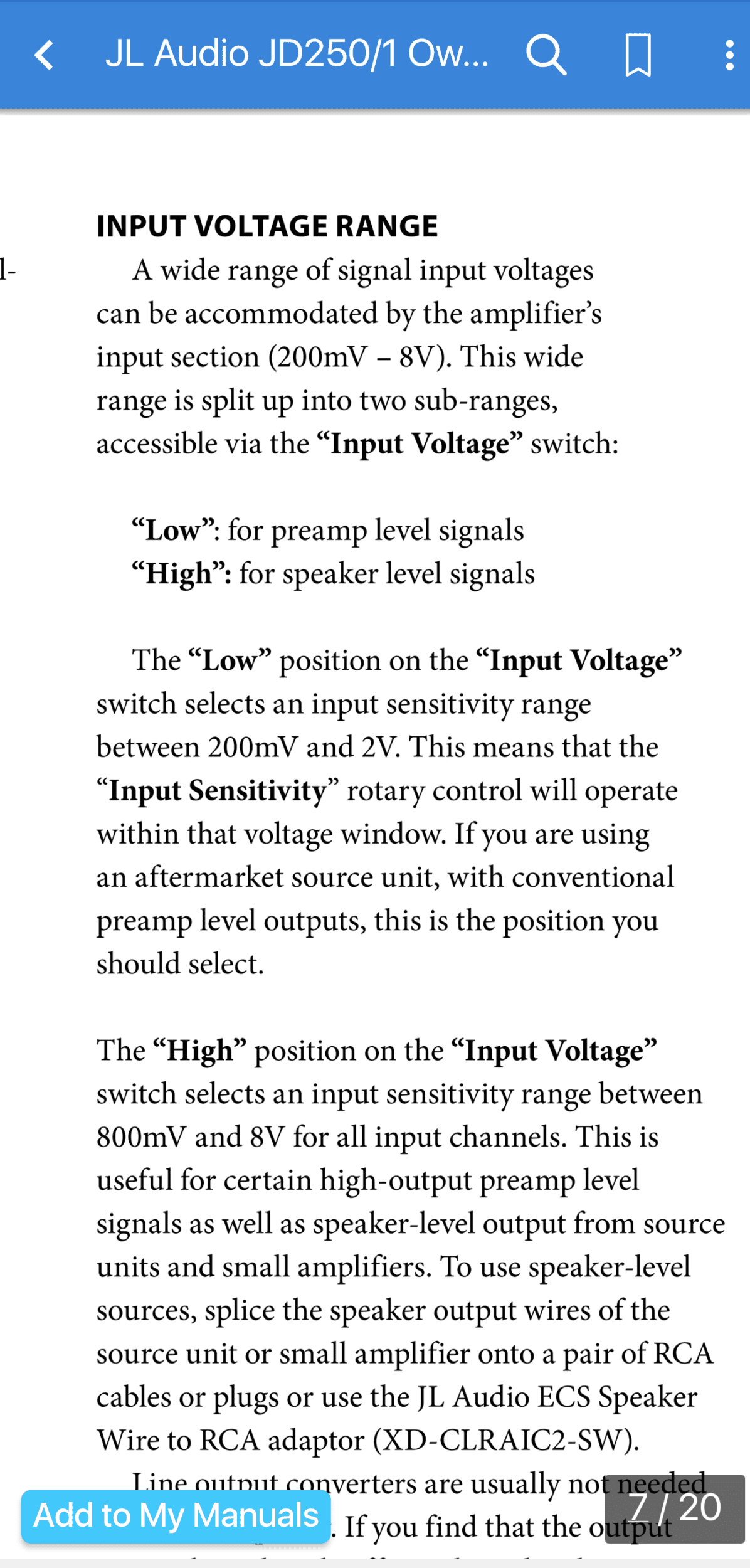

The input is noted as 220mV. It does not give me a range. It just states 220mV.
What does this mean exactly? I'm currently running Lexus ES350 2020 HU into LC2i, and then LC2i into JD1000/1.
JD1000/1 is set to high level input.
If I were to switch out to the Taramps HD 2000, would this be okay? Would I have to drop the gain on the LC2i to match a certain voltage? I've never seen amps that have a specific number... it's usually a range. Unless I'm looking at the wrong specification.

220mv is probably with max gain. Don't know why they list some amps only 220mv while others are like 4v-220mv. I had no problems running a 4v and 5v deck on a Taramps. Gains were a tad lower than halfway using a -10db 50hz tone, sub control on my deck set to 7 of 10, volume a few clicks from max using that amp clip light
