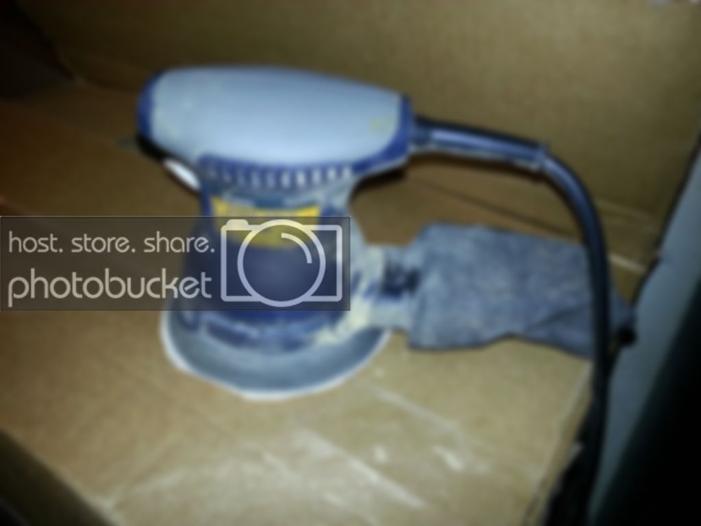

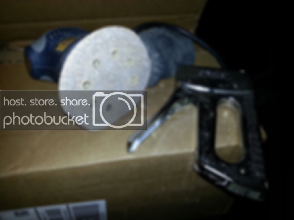

I know I didn't put this in the build, but you will need to sand the rough edges before you wrap it with a sander like in the pics. I use 40 grit and sometimes 60 grit to start. 100-150 grit is the highest you should need. Keep running your fingers over the edges and seams to make sure it is smooth after sanding. Then you need clean up all loose sawdust or the imperfections will show through the vinyl. Depending on the box you're covering you may or may not need a staple gun like in the pic.
