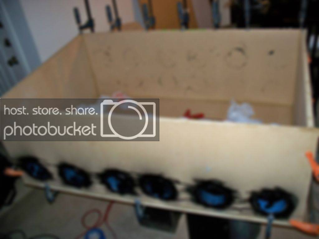

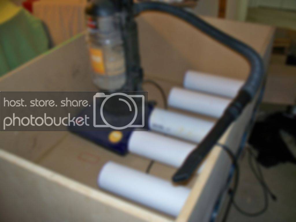

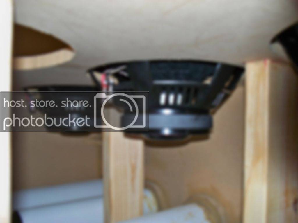

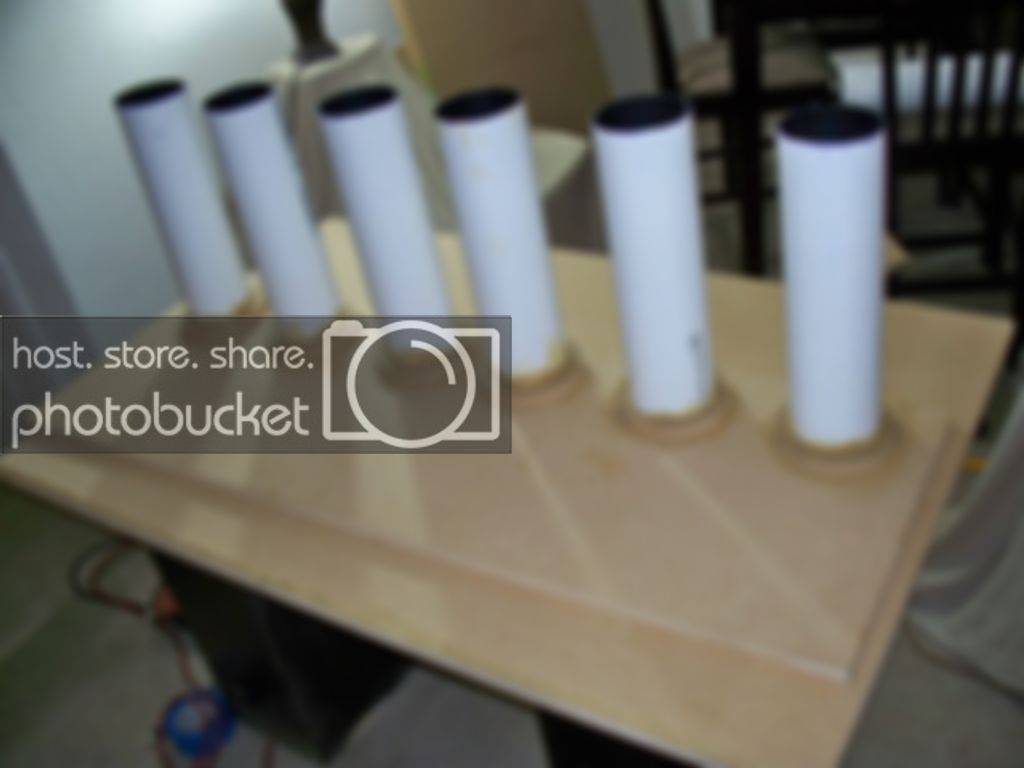

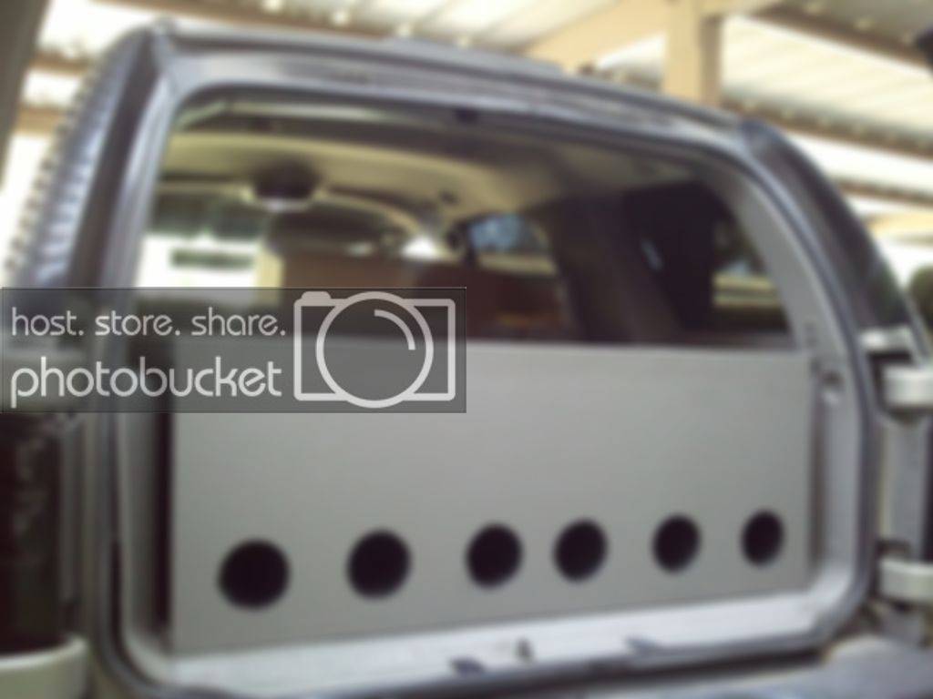

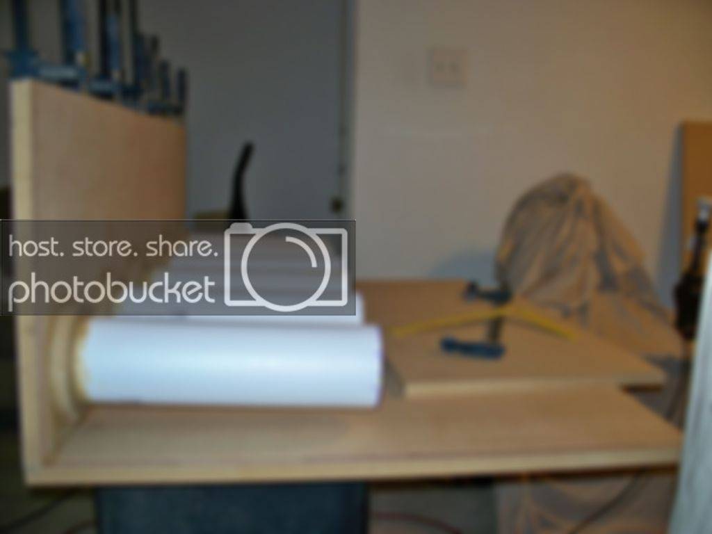

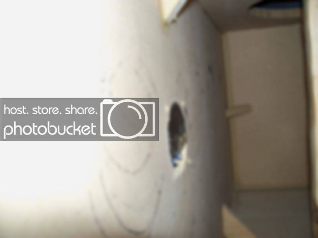

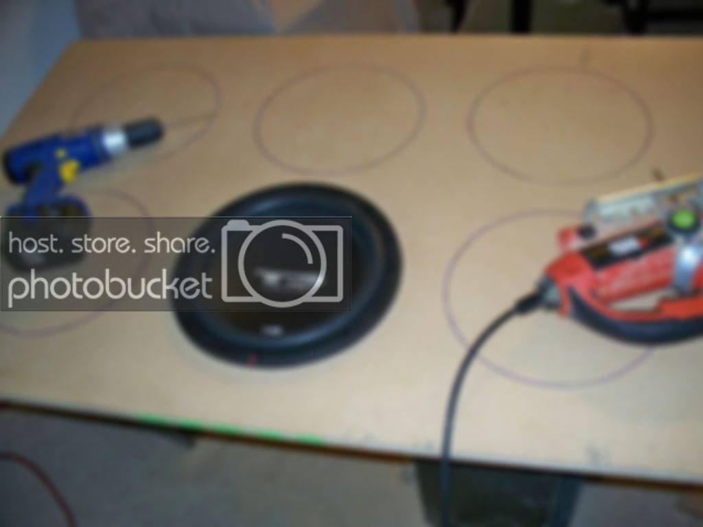

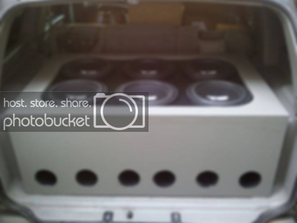

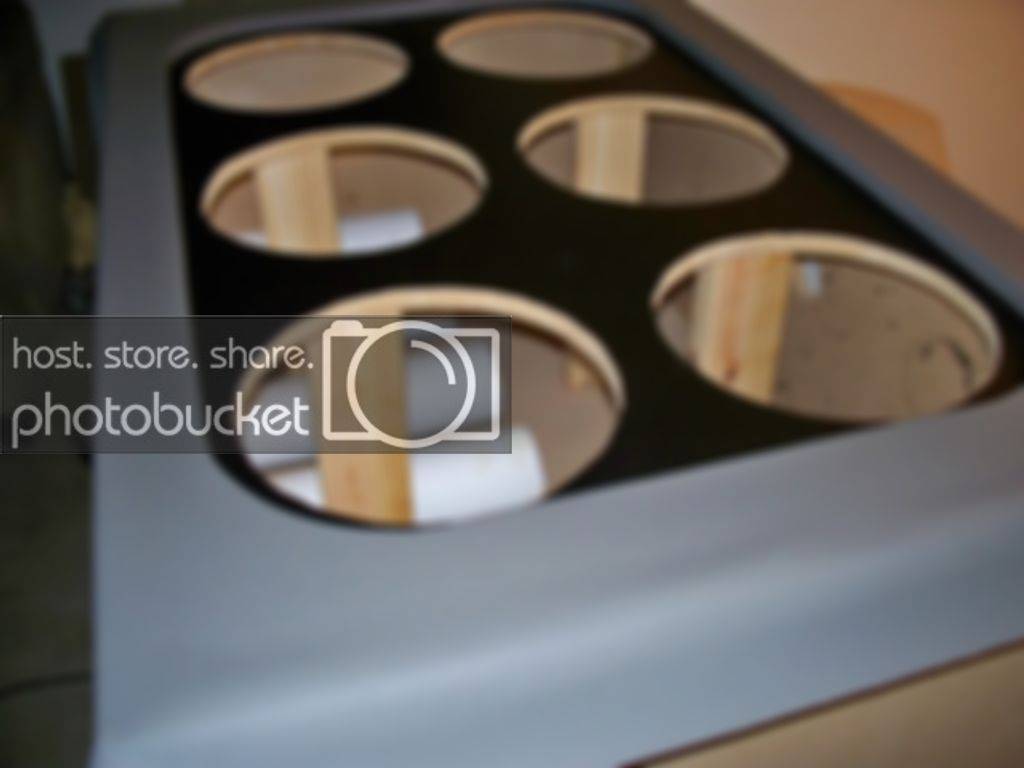

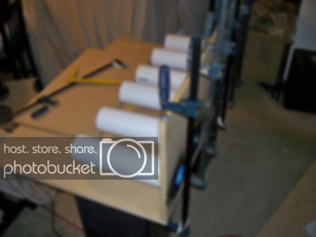

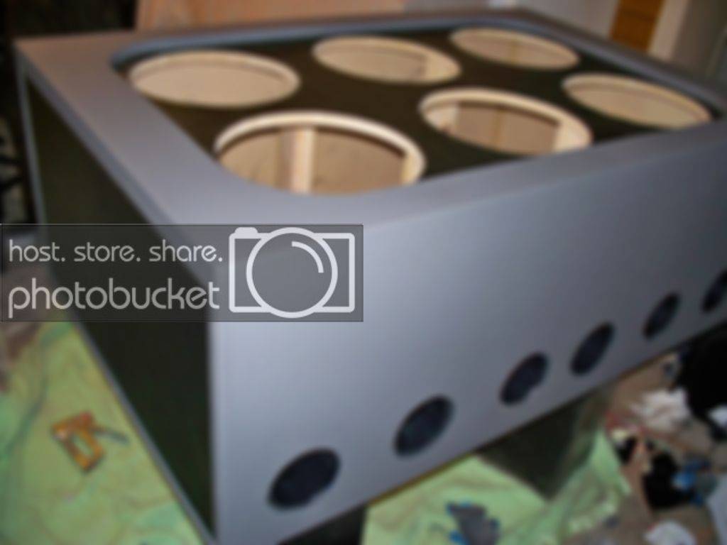

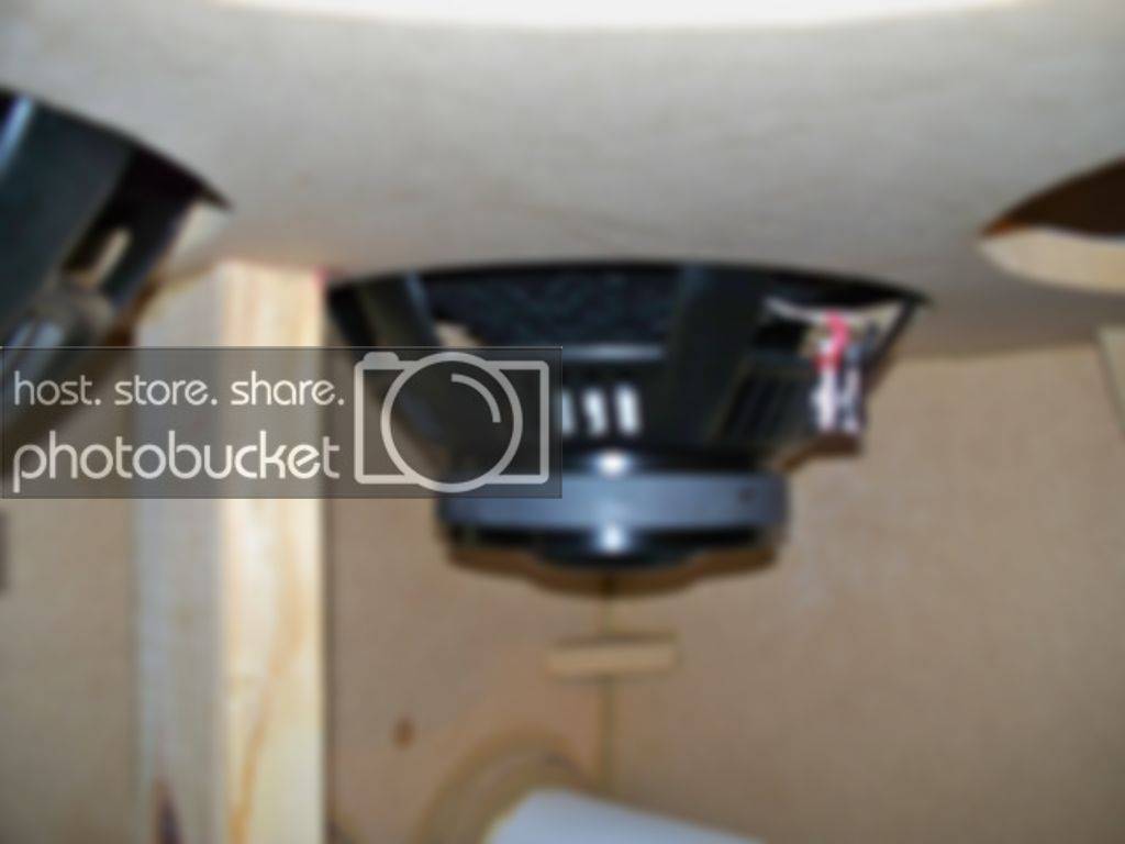

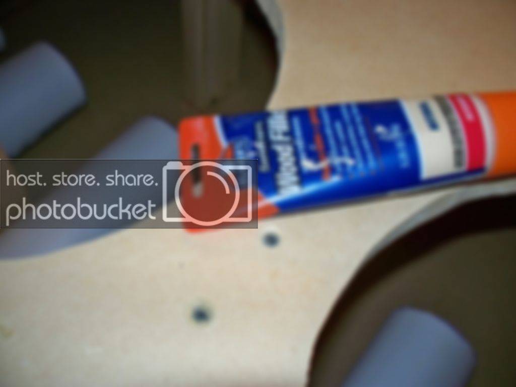

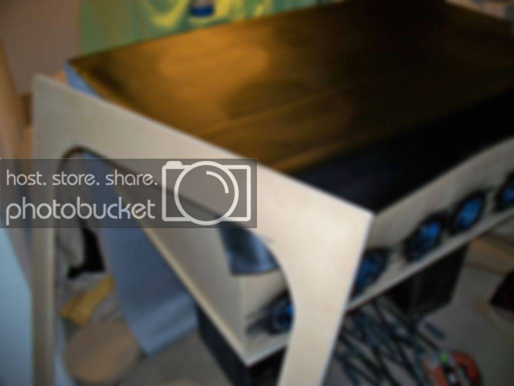

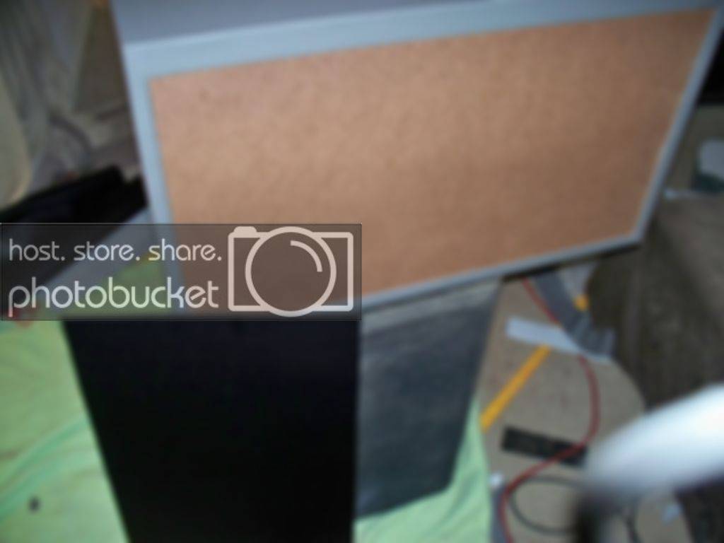

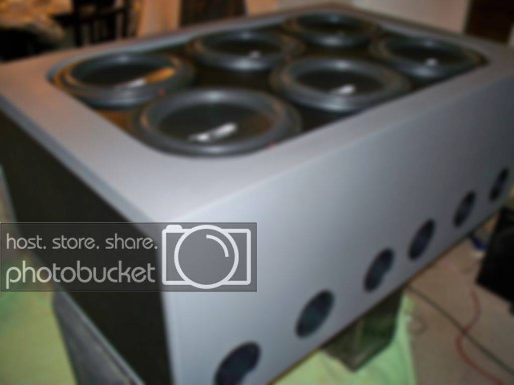

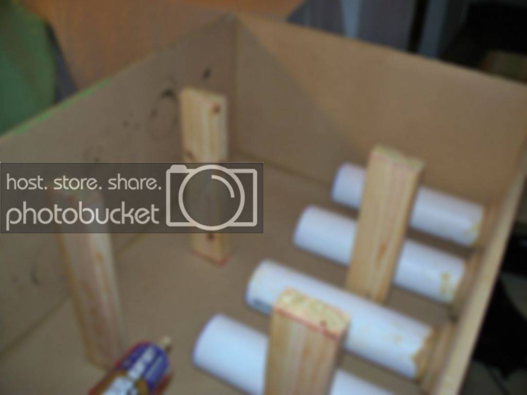

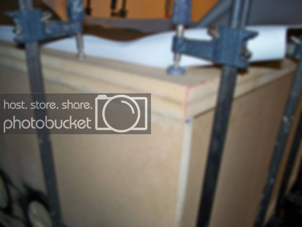

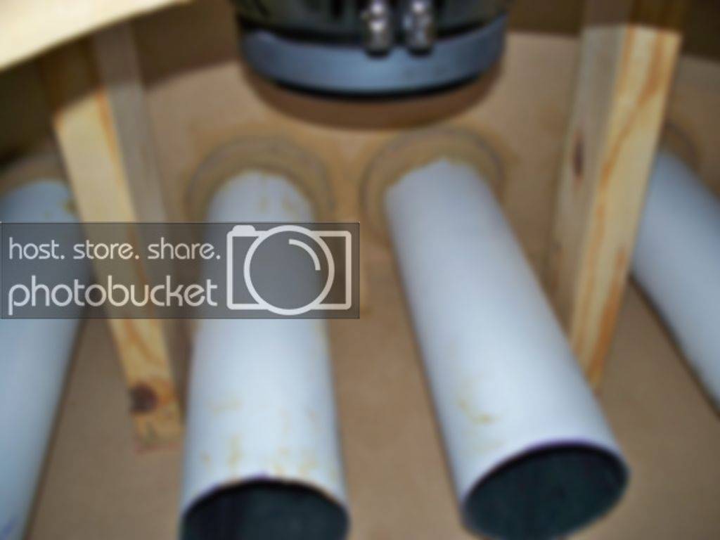

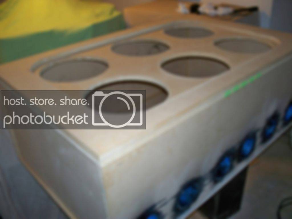

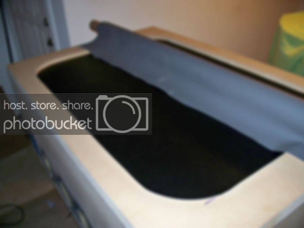

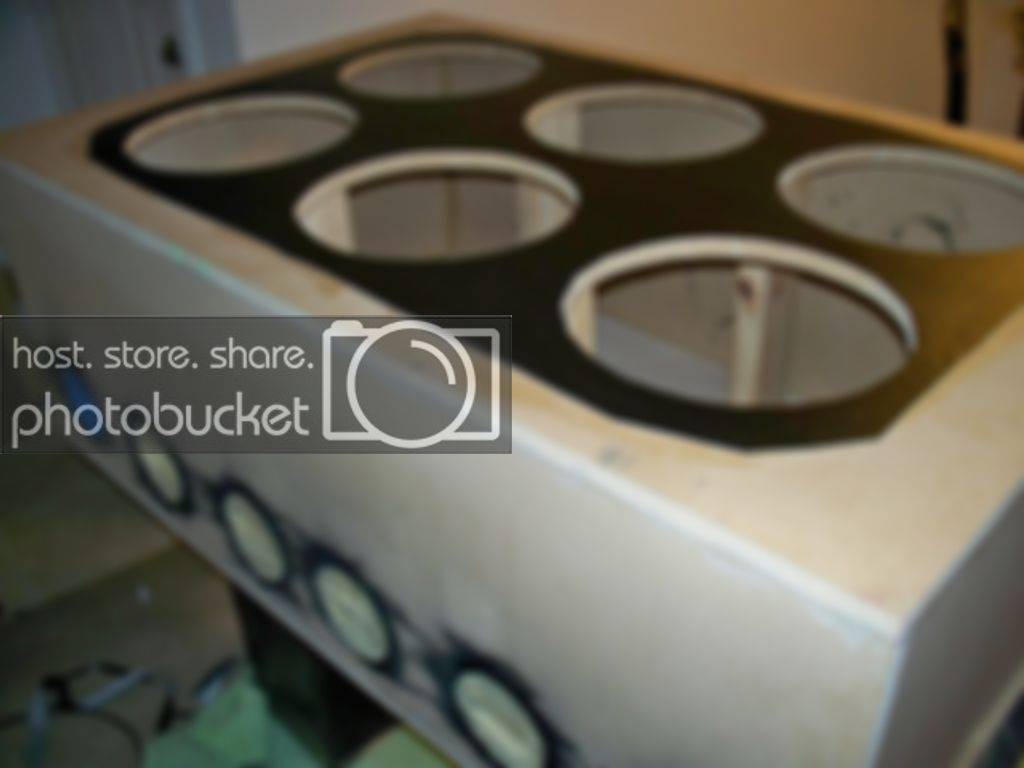

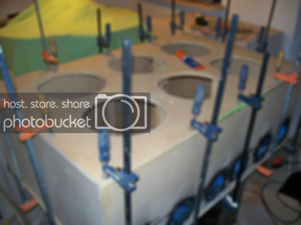

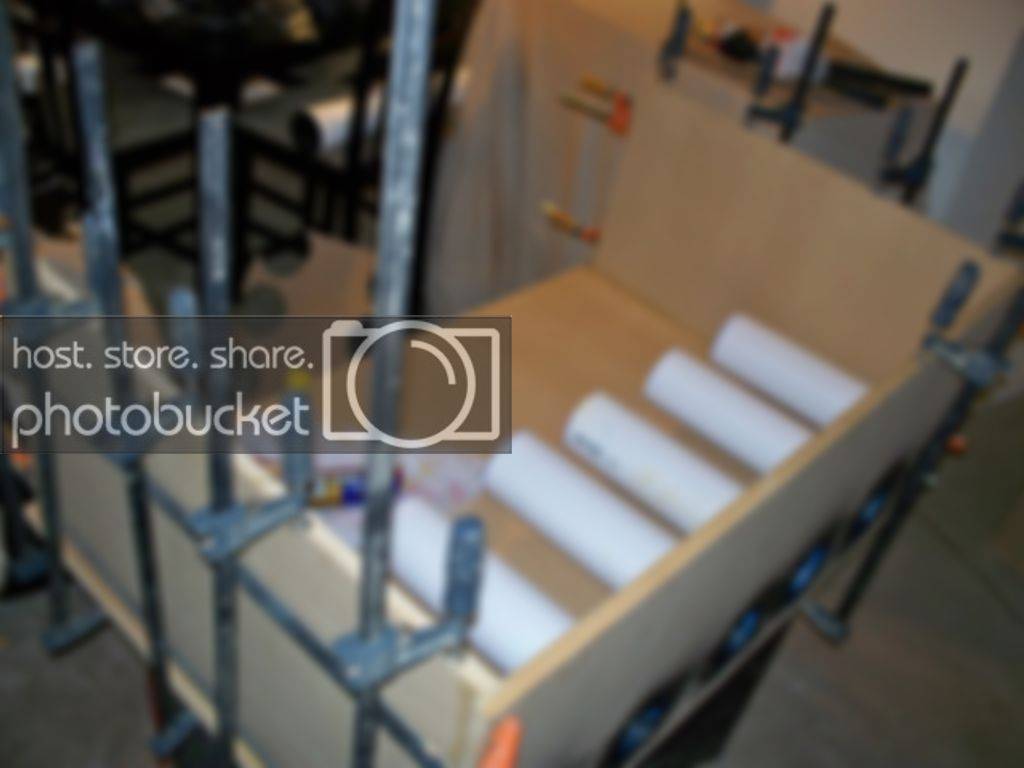

This was suppose to be a raw box because it's a temp setup, but I decided to cover it anyway. The subs were so cheap I wanted to experiment with them. This box is 12cu ft tuned around 30hz after all displacements. It has 6 4" pvc ports. This is a simple build with no fancy bracing, but my box does not flex. This box has been installed for about 3 months so far. Subs are being pushed by a Brz2400.1d.

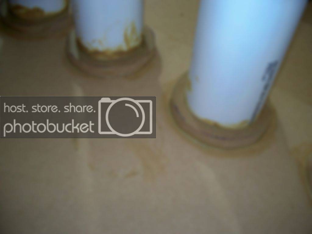

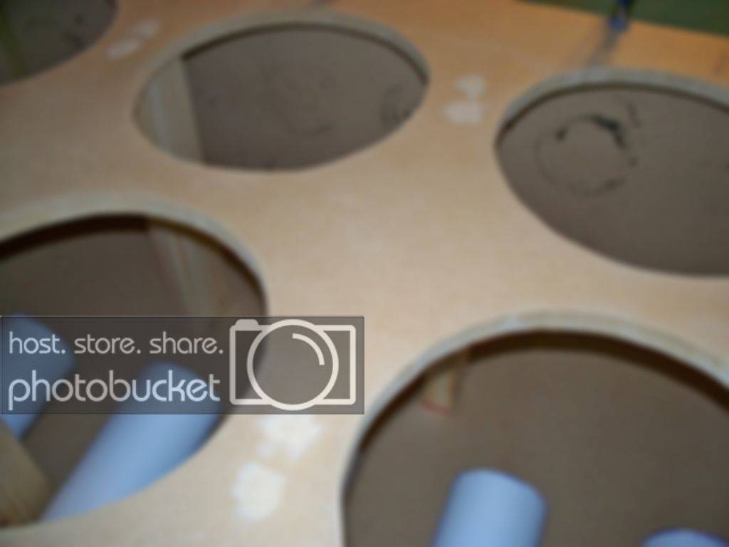

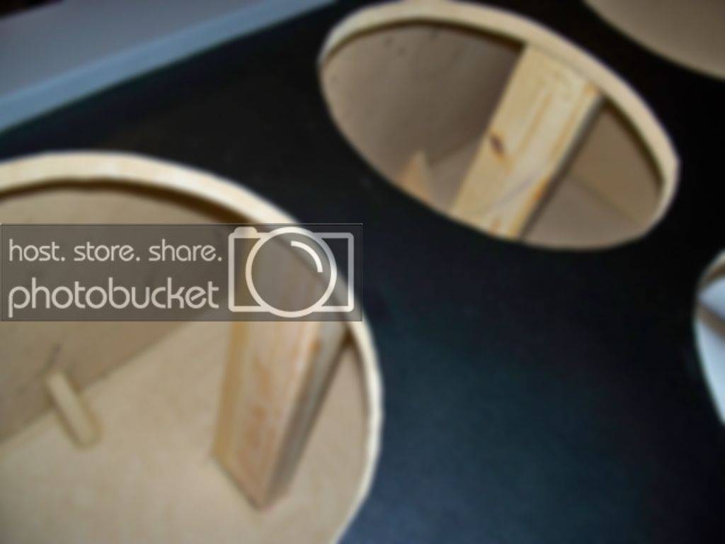

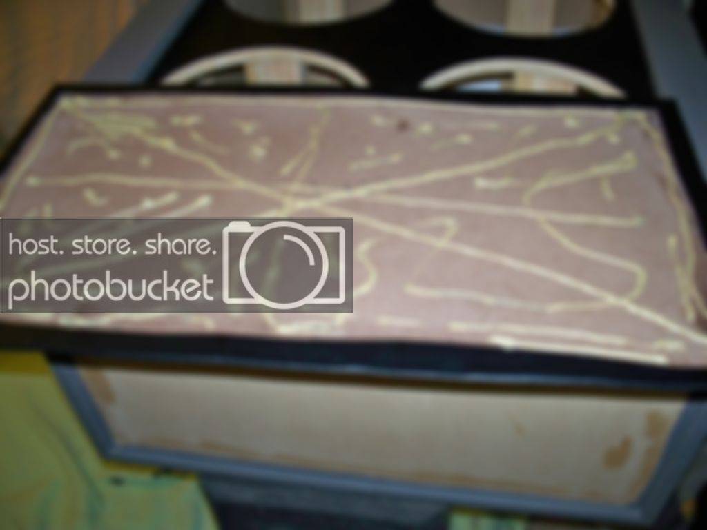

Ports are held in by Liquid Nails, no screws

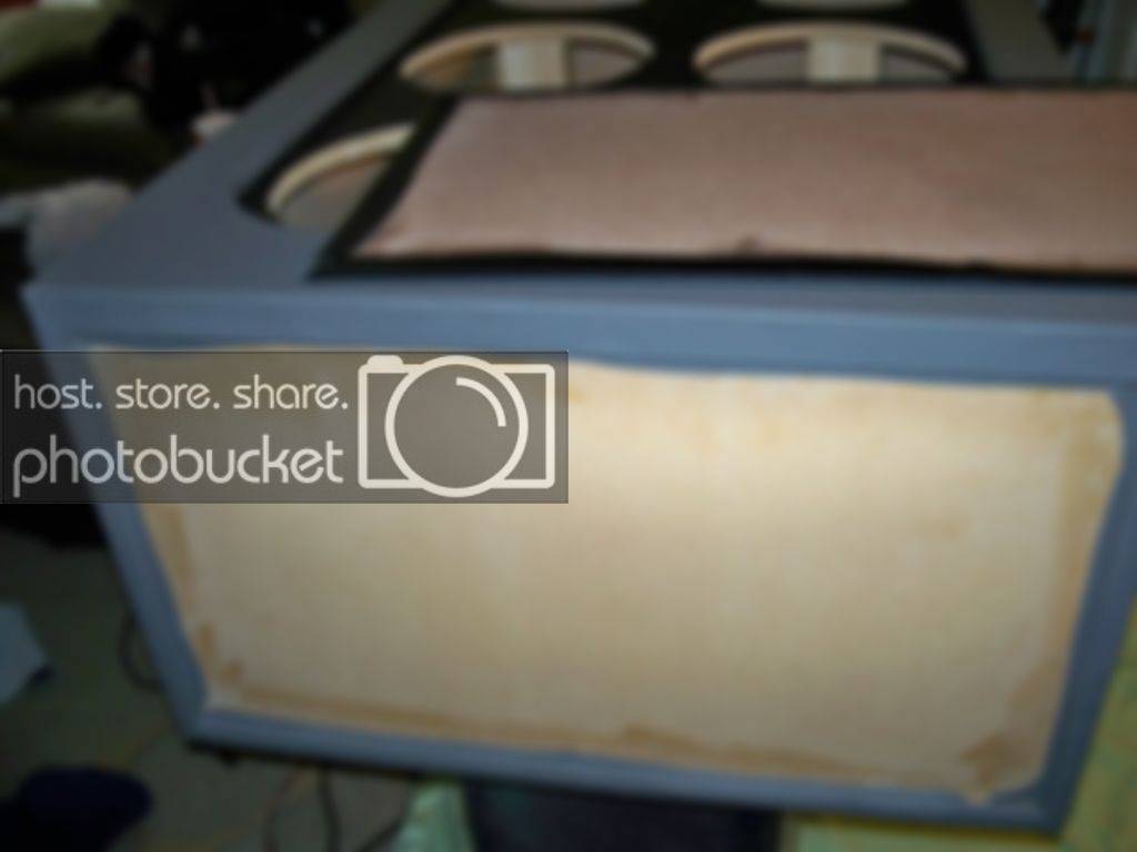

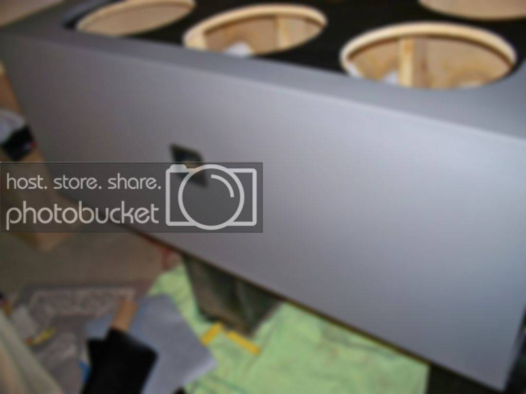

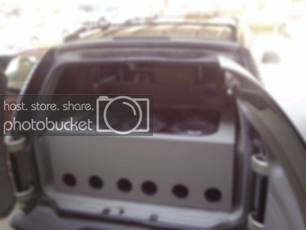

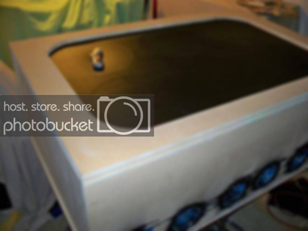

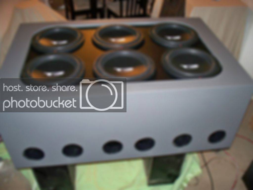

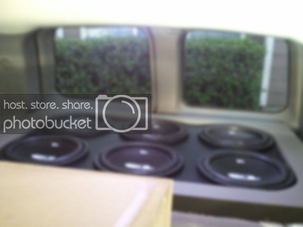

All Done. I think it turned out ok.
In my Tahoe that was stolen. I never got my seats redone that they tore up.

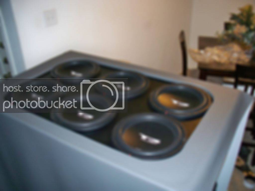

These sound better than I expected. They play pretty flat, and they hit the high and low low bass. I've pushed them pretty hard and haven't smelled any coil yet. These are not my dream subs. I just needed something to hold me over until I got something better.
nice box...do u have any port noise cause didnt use aeros?
I can't really tell because the bass makes the interior rattle so much. I'm too lazy to deaden the truck, but I will eventually. I don't think there is any port noise. I would have used aeros but I didn't really care much about this build. That 10 foot thin walled pvc is only about $10. I don't think aeros would be a night and day difference. I will use them when I get some subs I love.
