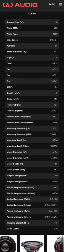

I'm trying to make the build as small as possible but still get low Hz, I can go side to side in trunk 30 in max, baffle I'd like to stay under 14 in.
Slot Port I assume would be downfire as well, Im trying to maintain the compact look and get some trunk space back. Only looking to use best performance of the subwoofer and sound good.
