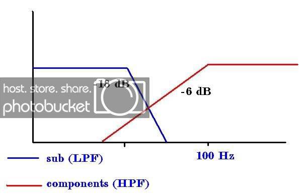

based on the settings i saw suleman (shout out!) use for his pioneer 7800, i set my:
HPF @ 100 Hz, -6 dB/ocatave
LPF @ 80 Hz, -18 dB/octave
previously, i had it set at:
HPF @ 80 Hz, -12 dB/octave
LPF also @ 80 Hz, -18 dB/octave
all these settings refer to settings on the HU.
is this what is referred to as "staggering" your crossover pts. now i know everyones car, setup, gain settings, etc. are diff., but why does it sound so much better?

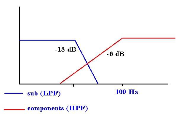

is it bc the morel components dont have to go as low in terms of the frequencies they are responsible for producing? what does this actually look like? here was my very rough and not-drawn-to-scale approximation:
in case that pic doesnt show, heres the link
http://i39.photobucket.com/albums/e164/fcelau1/approximationofcrossoverpoint.jpg
so joker, it starts to cut before the pt (in Hz) u choose?
i admit i still dont know enough about phase (everything i try to read is very difficult to digest and not overly technical, but too technical for me to fully understand it) or crossovers (whether active or passive).
is there a website or program i can put my crossover pts, slopes, etc. into that will generate some type of graphical display?

as for the staggered Question. its not uncommon to have a 1st-3rd combo. the phase of one speaker is usually inverted as there is more phase shift in the 3rd order filter.
(among the more interesting topics for phase is the realization that ACOUSTIC effects like distance affect the phase of the signal to your ear, and as such some filters will work better in practice even when they look like crap on paper. this is also why the LR filters are not really a good choice for car audio -- the tweeter is probably no where near the mid, and the major LR benefit of phase matching is lost!)
