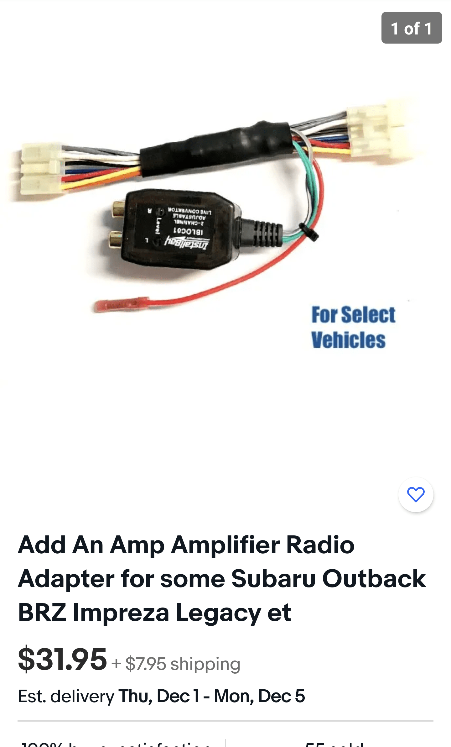

No need to replace the headunit. There are many amps with built in LOC to make installation easier. There are also kits called Add An Amp that make splicing a snap. Of course you would still have to run wires to the speakers, or if you're feeling froggy, you can cut the wires that go to those speakers and splice in there.
It is not that the 1666s can not handle the power; It is that the radio can not push them to where you want them to. This is inherent in even aftermarket headunits. The amp section is 15-20 RMS watts per channel for most. Any voltage past those 20 watts is pushing the limits of clean output.
No need to replace the headunit. There are many amps with built in LOC to make installation easier. There are also kits called Add An Amp that make splicing a snap. Of course you would still have to run wires to the speakers, or if you're feeling froggy, you can cut the wires that go to those speakers and splice in there.View attachment 45058
I really like the direction that this is headed. Would you be so kind to clarify for me tho? It looks to me like a regular LOC. I tap the LOC wires into my headunit like i did with my kicker LOC and then I have RCA outputs....but where do I run RCA to if the speakers themselves are T-plugs or whatever? Just curious how I could do that. I feel like im missing something here. Do you have a video or wiring diagram for this concept? Thank you.
Ok wait... the amp that I have is 350wrms. Could I run speaker wires from that (2 channel) and run it to the speakers if I reduce the watt in between the amp and the speakers?
