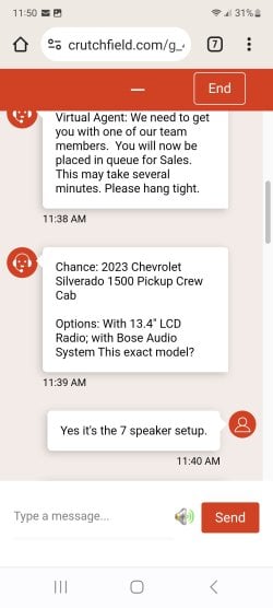

I'm keeping the stock subwoofer.
I want to replace the 4 door speakers and the dash speakers.

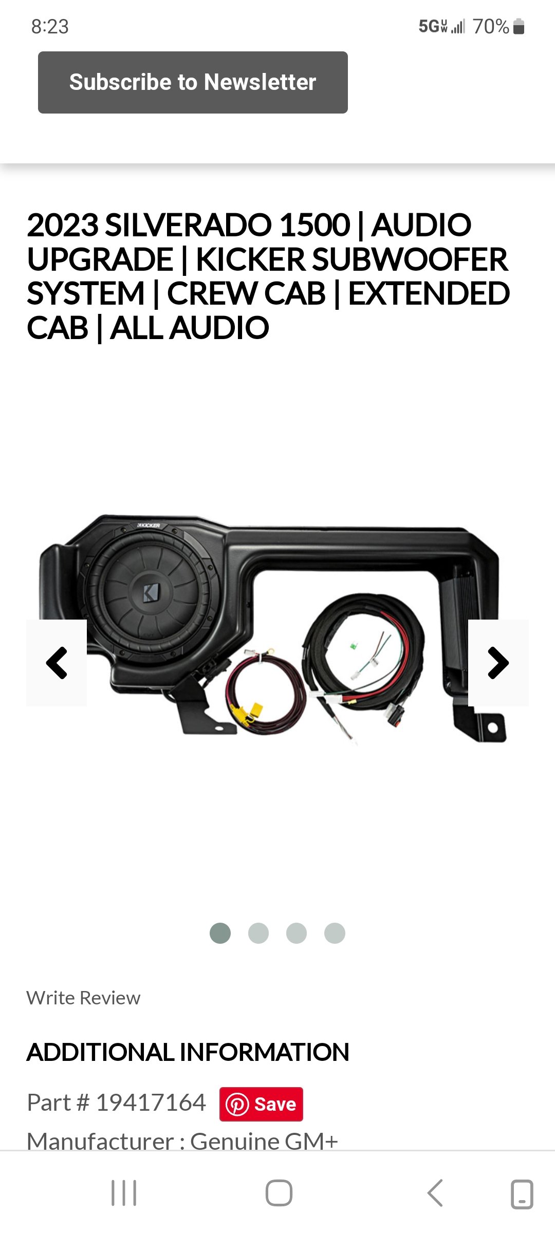

Then I want to add the GM Kicker powered subwoofer that sits under the back seat

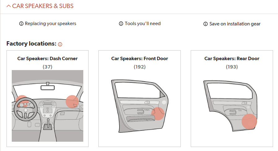

Great. I would make sure of the fitment and Crutchfield.com is a great place to start. Input your vehicle type, determine what you need to replace the existing speakers (always use the new crossovers provided on any of them), and then shop around.
The dash stuff is tricky in that the size/fit ohm rating can be problematic when trying to find those and other 2ohm drivers that are from the same manufacturer. Crutchfield can help you there too.. You may have to start with the dash drivers to point you in the right direction. In some of these situations, the dash speakers have a dual function as they may be designated for your communication devices too. Not using them means you may lose intercom or phone interaction. Some opt for using them with upgrades but I'm personally not a fan of using the stock dash speakers with upgraded speakers everywhere else but I'm also not a fan of the Bose systems in "most" vehicles. If you had to use the dash speakers with upgrades, a compromise for sure but probably still better than not upgrading at all. I assume that the Kicker sub will replace the stock sub, probably a decent option.

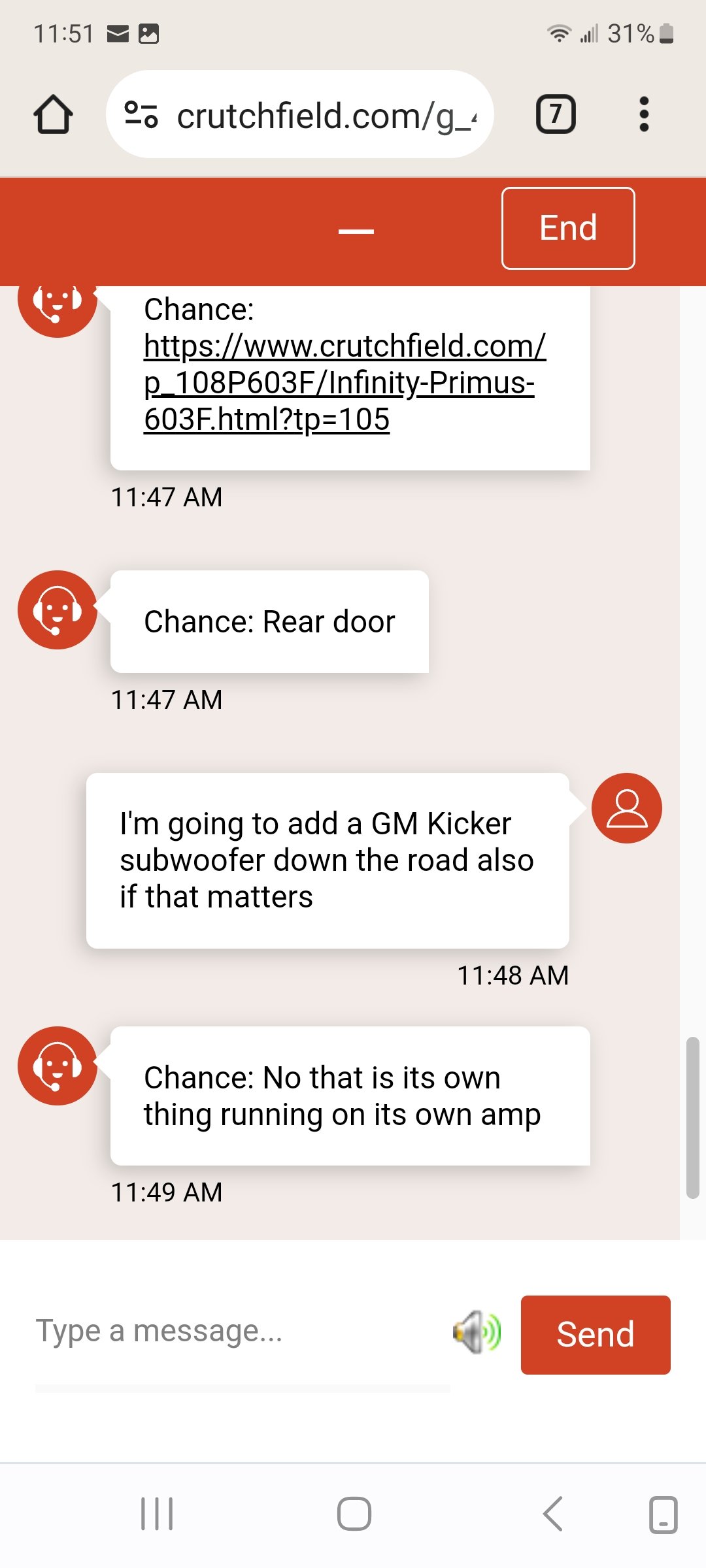

The GM Kicker sub doesn't replace the existing sub under the center console. It's powered by its own 200 w amp. So in theory there will be two subs.

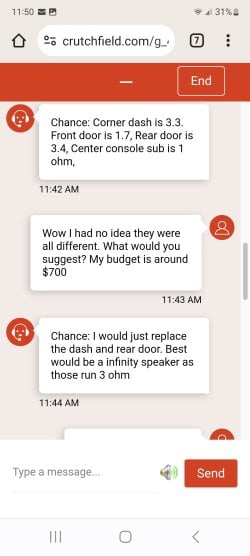

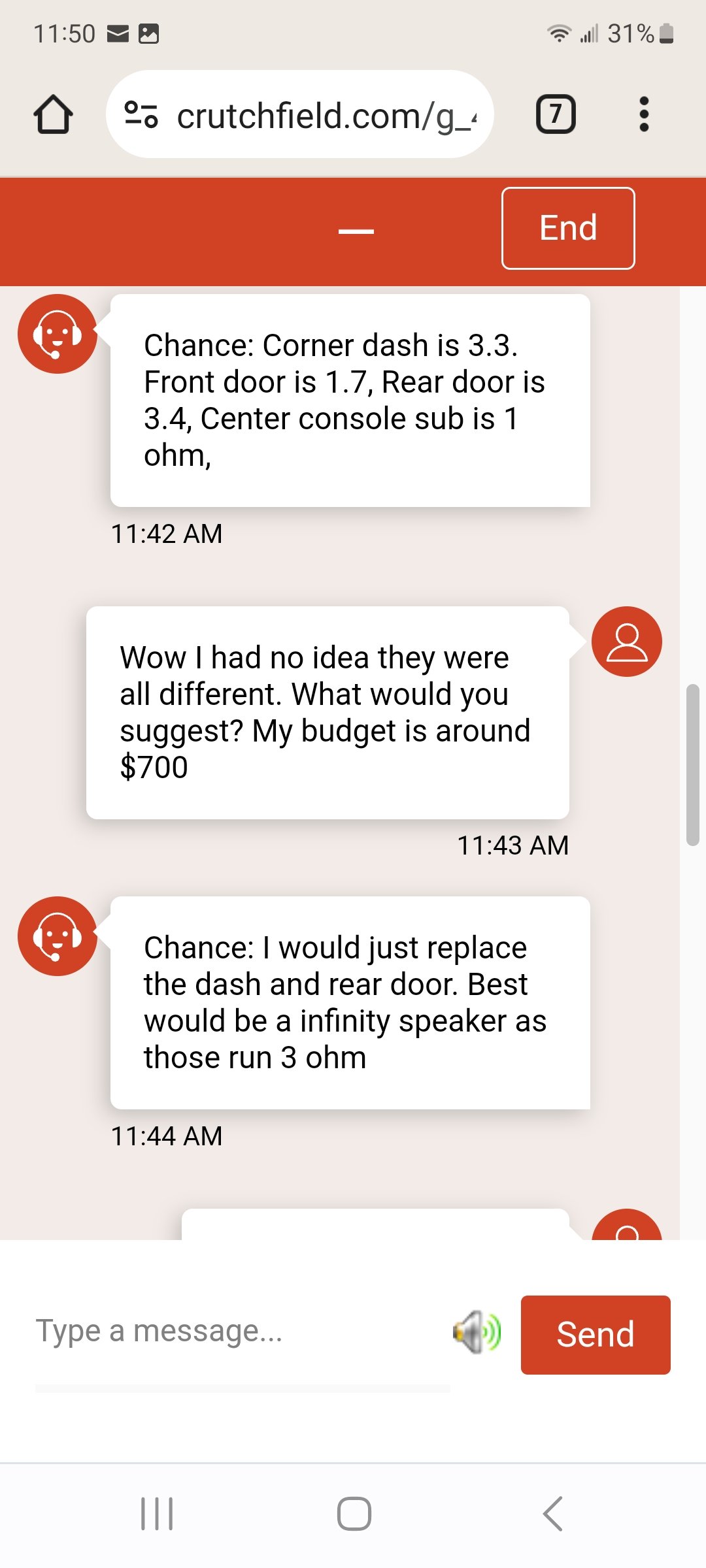

The ohms of existing speakers I think are 2 ohm dash and 4 ohm door speakers but I can't confirm.
How important is it to replace speakers of the same ohm?
Nice, well, can't say that either would be "too" much bass! As for the impedance ratings, I would wager that all the speakers are 2 ohms. Moving to 4-ohm speakers would effectively reduce the power to the speakers by as much as 50%, not usually anywhere near acceptable in an OEM setup. I run my 3000-watt@1ohm stable sub amp at 4 ohms but it puts out over 1000 watts at 4 ohms, you don't have that luxury, so to speak. Unless you upgrade the amplifier(s) to something more substantial, you will need to find 2-ohm speakers to replace the ones you have. The Bose amp is designed to put out rated power at that 2ohm resistance rating. If push came to shove, using 4ohm drivers in the dash would be the preference over the other way around, still not desirable if you can avoid it. If I recall, Kicker and several other companies make 2 ohm 2-4" drivers that will fit in the dash locations, just have to check it out.

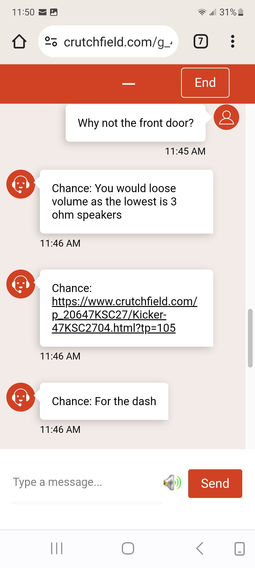

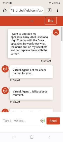

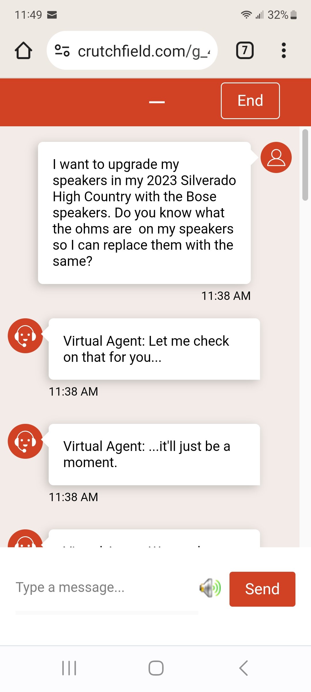

Thanks so much guys. Talked to crutchfield support with the same question and although they likely don't know everything, and sometimes, salesmen...
