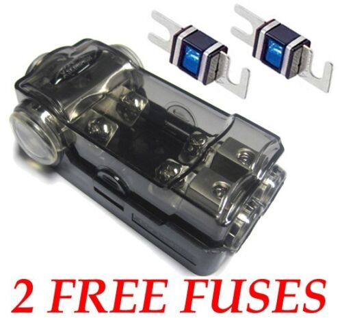

Xscorpian is made by Stinger and Ive used these for several installs and never had any issues. Excellent distribution fused block. Use a 120 for the 150.4 that is called for and later use what is called for for sub amp. The 150 at the Battery will work fine for the wiring supply for the 150.4 for now. Save the RCAs above for the Sub amplifier later.

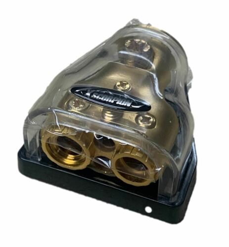

Excellent Ground block for both amplifiers.
