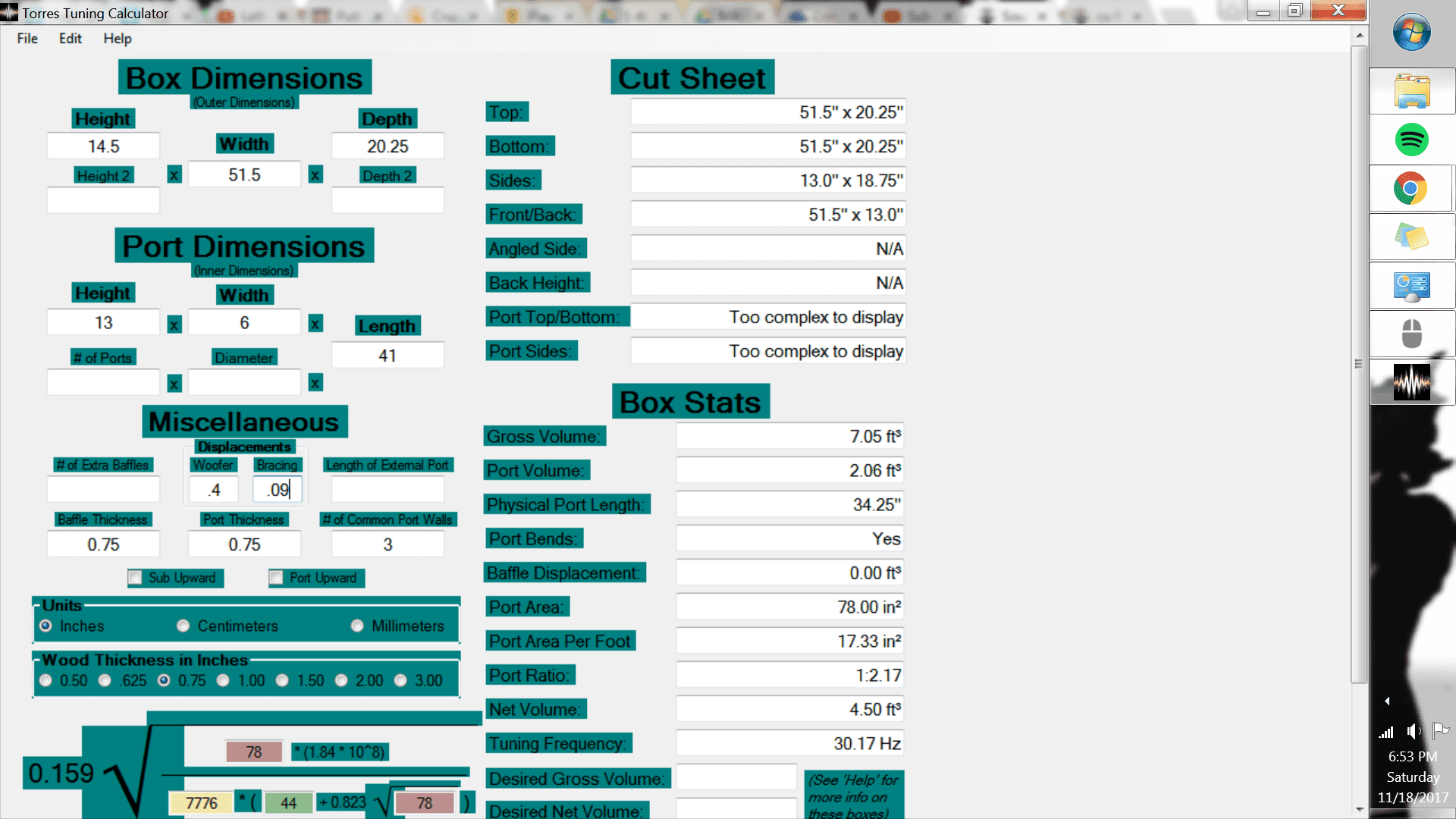

So how does this look51.5 width 14.5 tall 20.25 deep
Port is 13x5.875 by 41 long. Tuned to 30hz and port is 1.8 cubic foot.....hum?
Should be close to 4.5 after port and sub are taken out. .18 cubic foot displacement per sub. Think I rounded off to .40 for both.
Maybe I should add a lil more for 45's and bracing

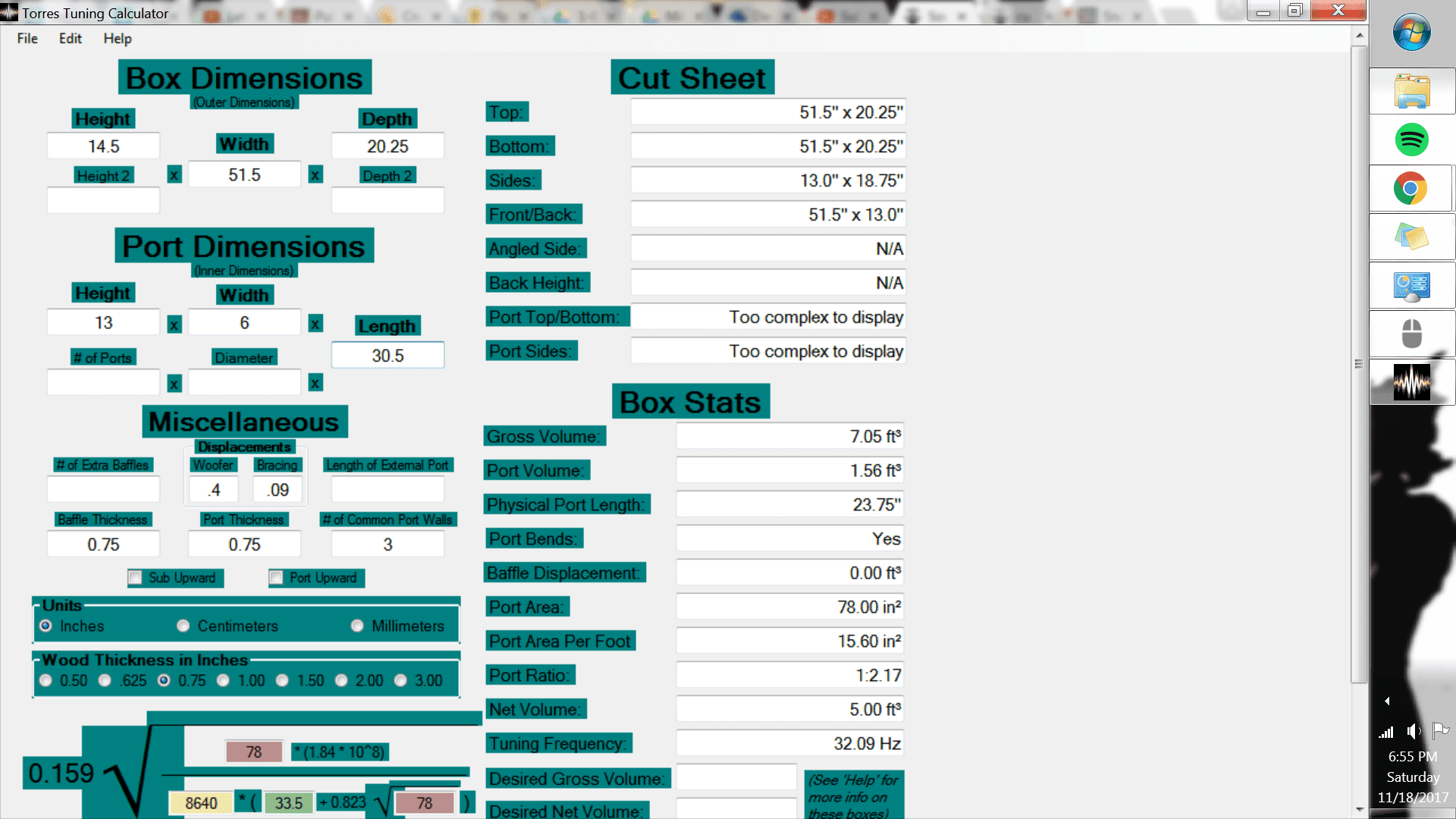

I'd say you are better off with 6 inch in width for your port. HDC subs love port area.
However Id say tune to 32hz, you are just shooting yourself in the foot trying to tune that low. This gives 5 cubic feet of airspace and you are gonna gain output overall

So tune port at 32hz is better?

Thought it would be cool to hit some lows.32hz is 34 inch port, 35hz is 27 inch port.
I don't have a problem fitting any of the ports, what you think would sound best?
I'm not really going for all out spl or I would be tunning higher
Unless you ONLY listen to slowed music or test tones I wouldn't go much lower than 35. You should be able to play down 5-6 cycles below tuning well enough.
