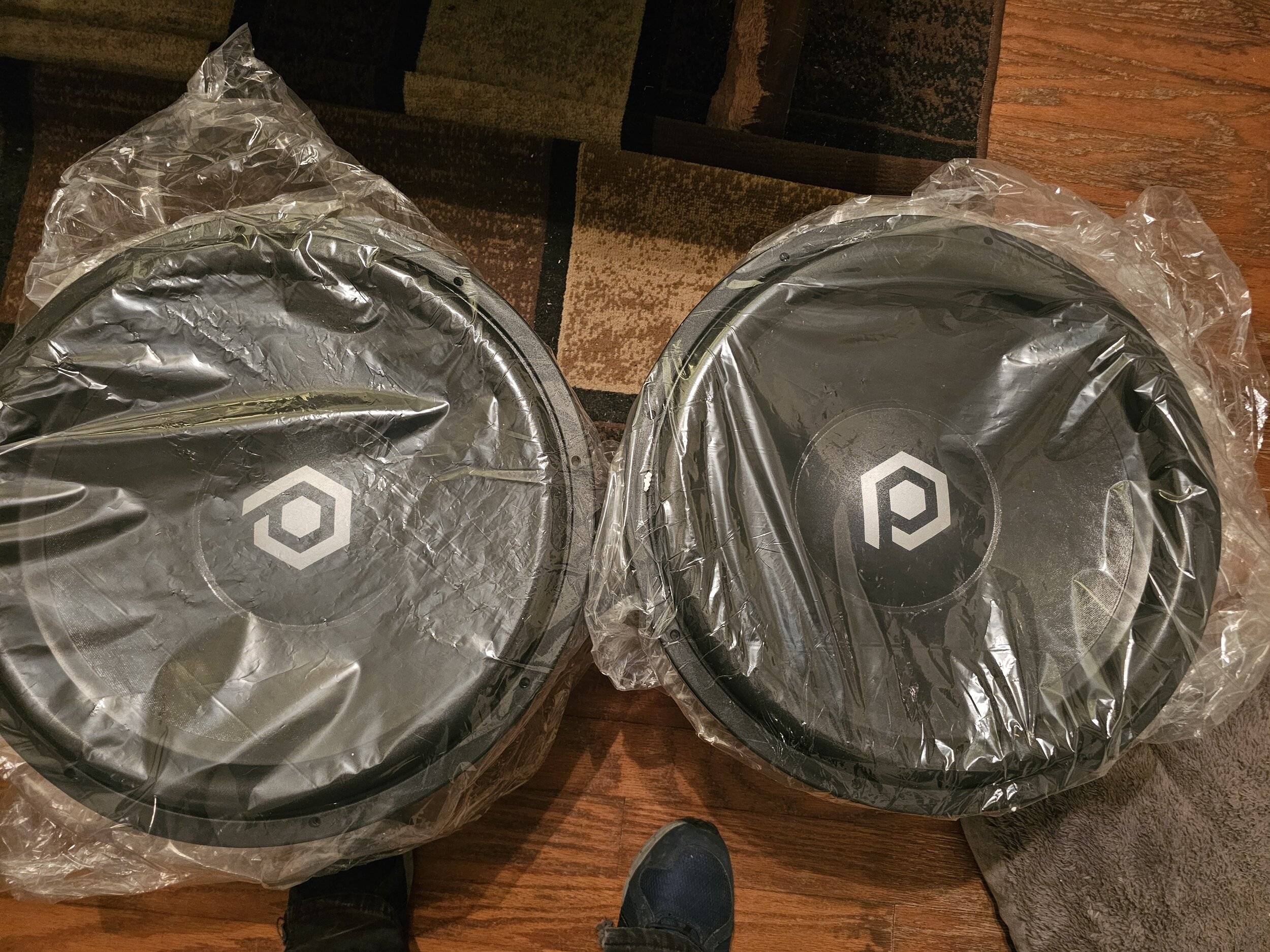

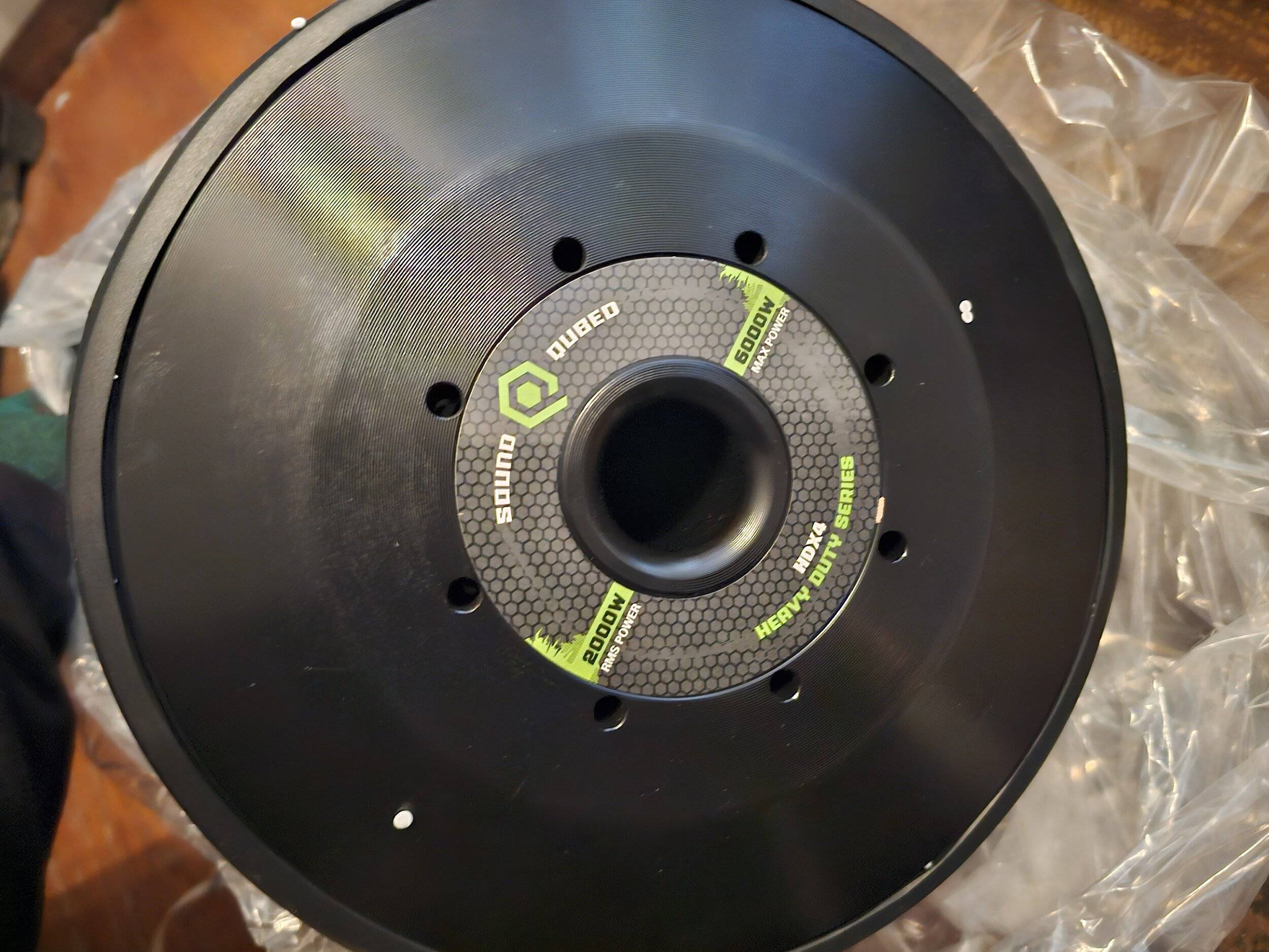

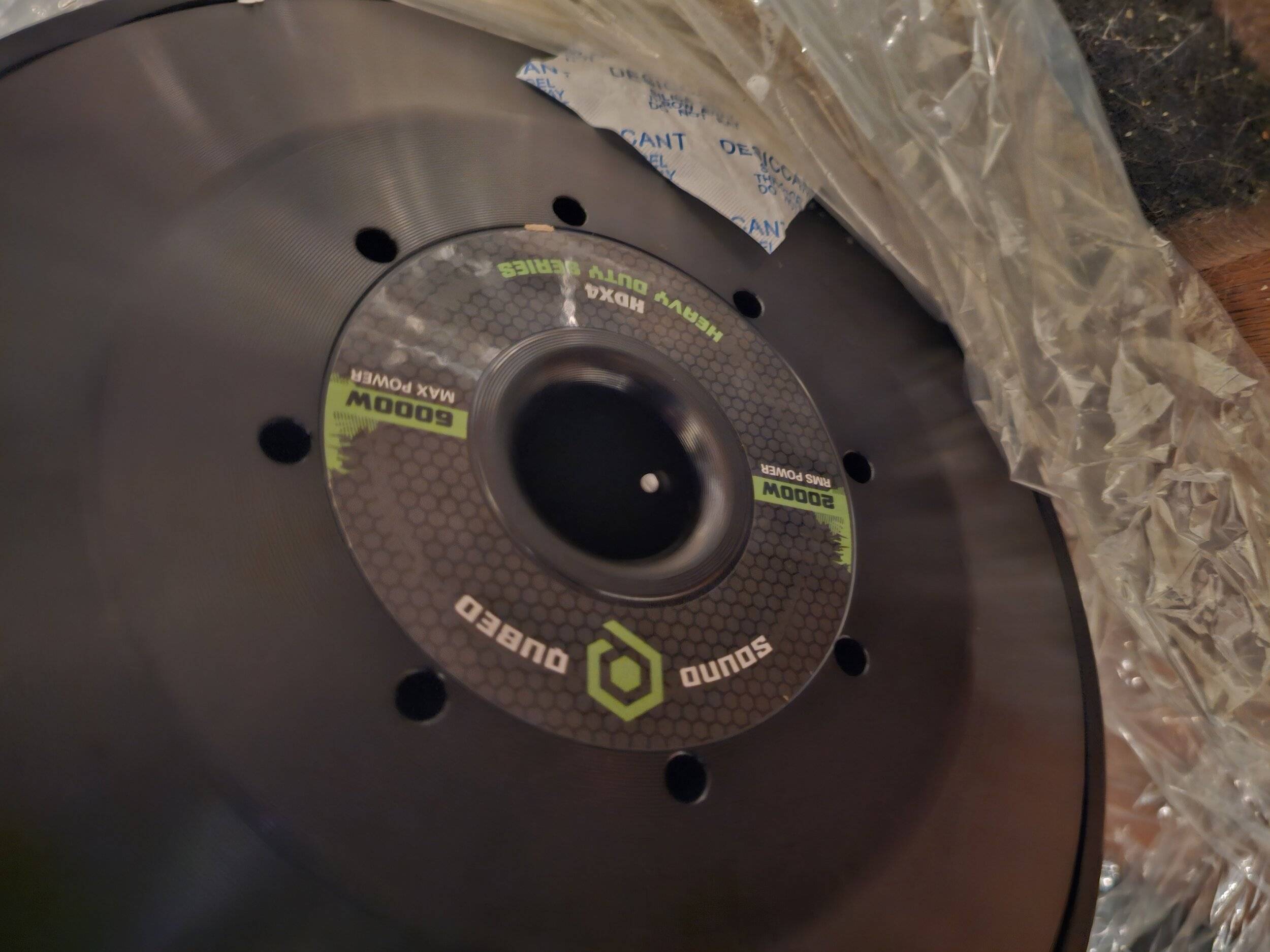

Subs arrived at the house will send pics this evening
