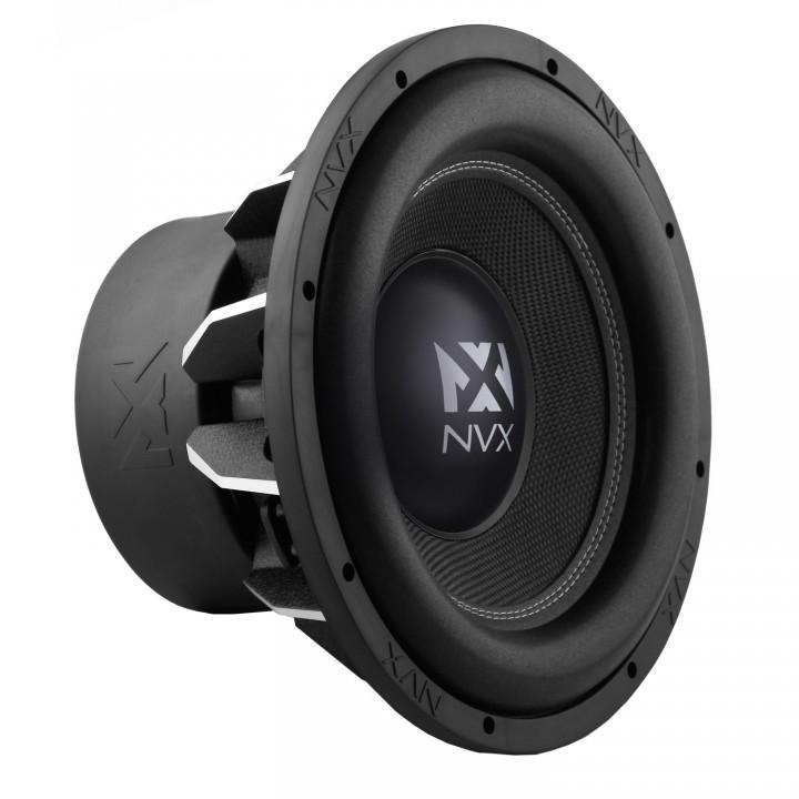

Hey guys. I don't have a box building program, but I know a couple of you do. I have an NVX VCW124v2 subwoofer. The box is 1.9 cubic feet. I need the port length for a port that has a 3"x8" opening. I'm looking to get 40hz. I know it's high, but my kid listens to rap music, so I want it hit to hit hard between 40hz and 50hz. This subwoofer is the version 2 design and not the newer version 3.
Here's the link for the parameters.

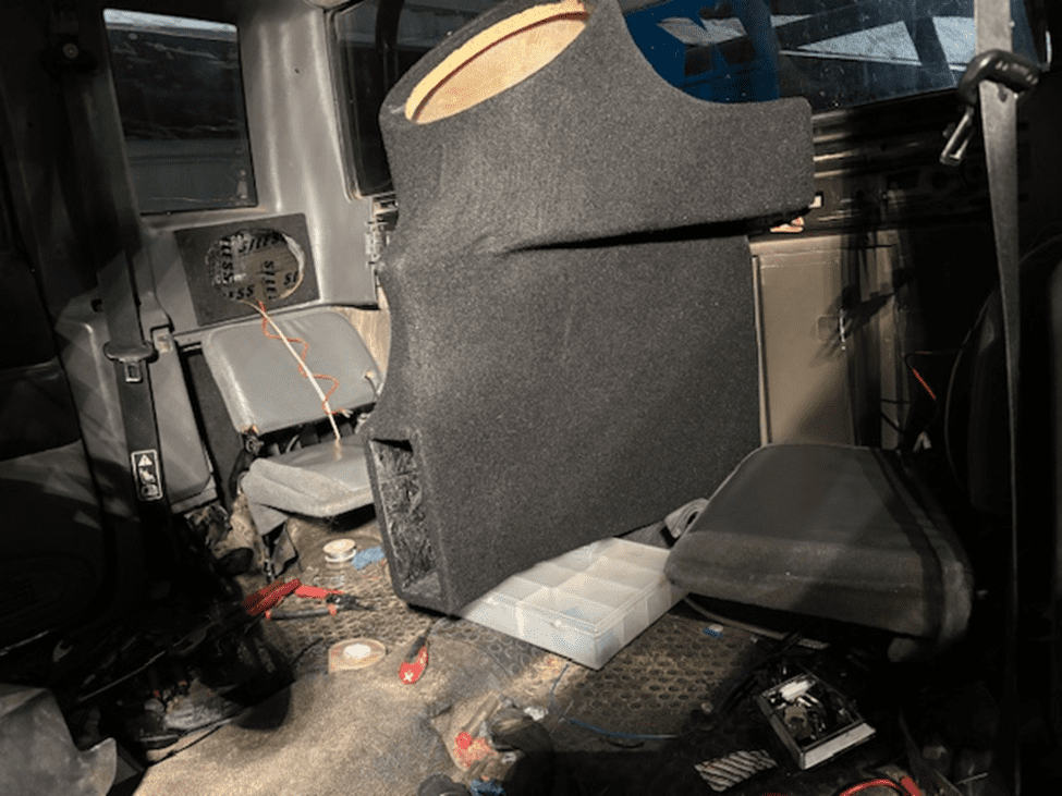

Here's the box in it's place. I'll get completed pics up soon. It was hard to make is perfect. It was pretty cold to be using fiberglass and not having an actual shop to do it in.
