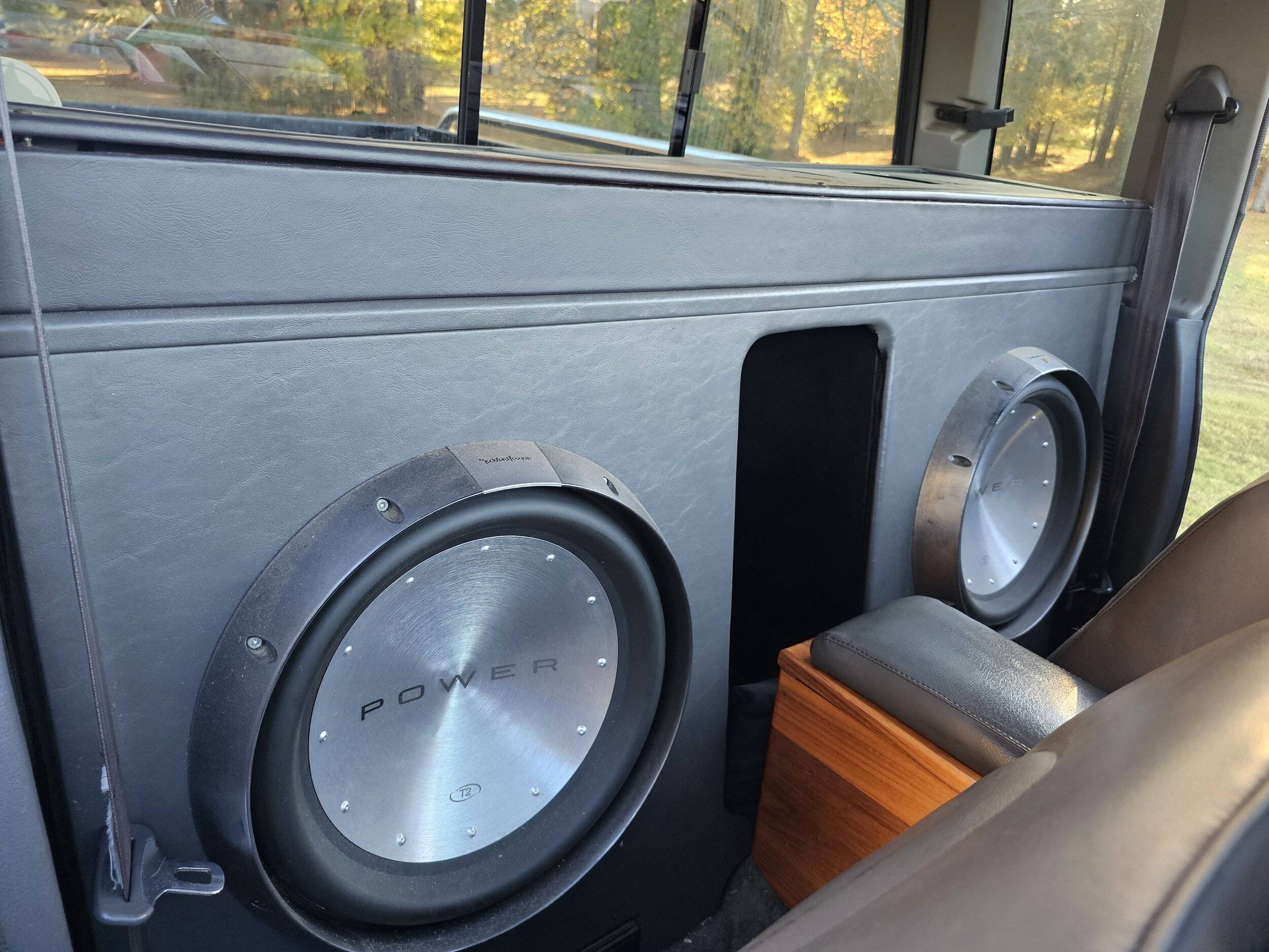

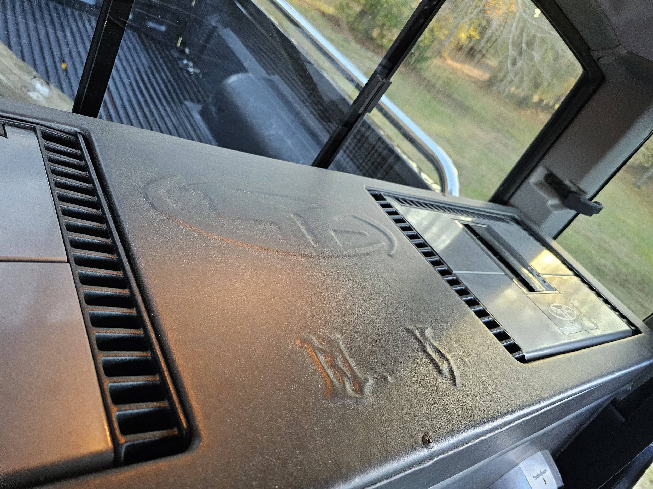

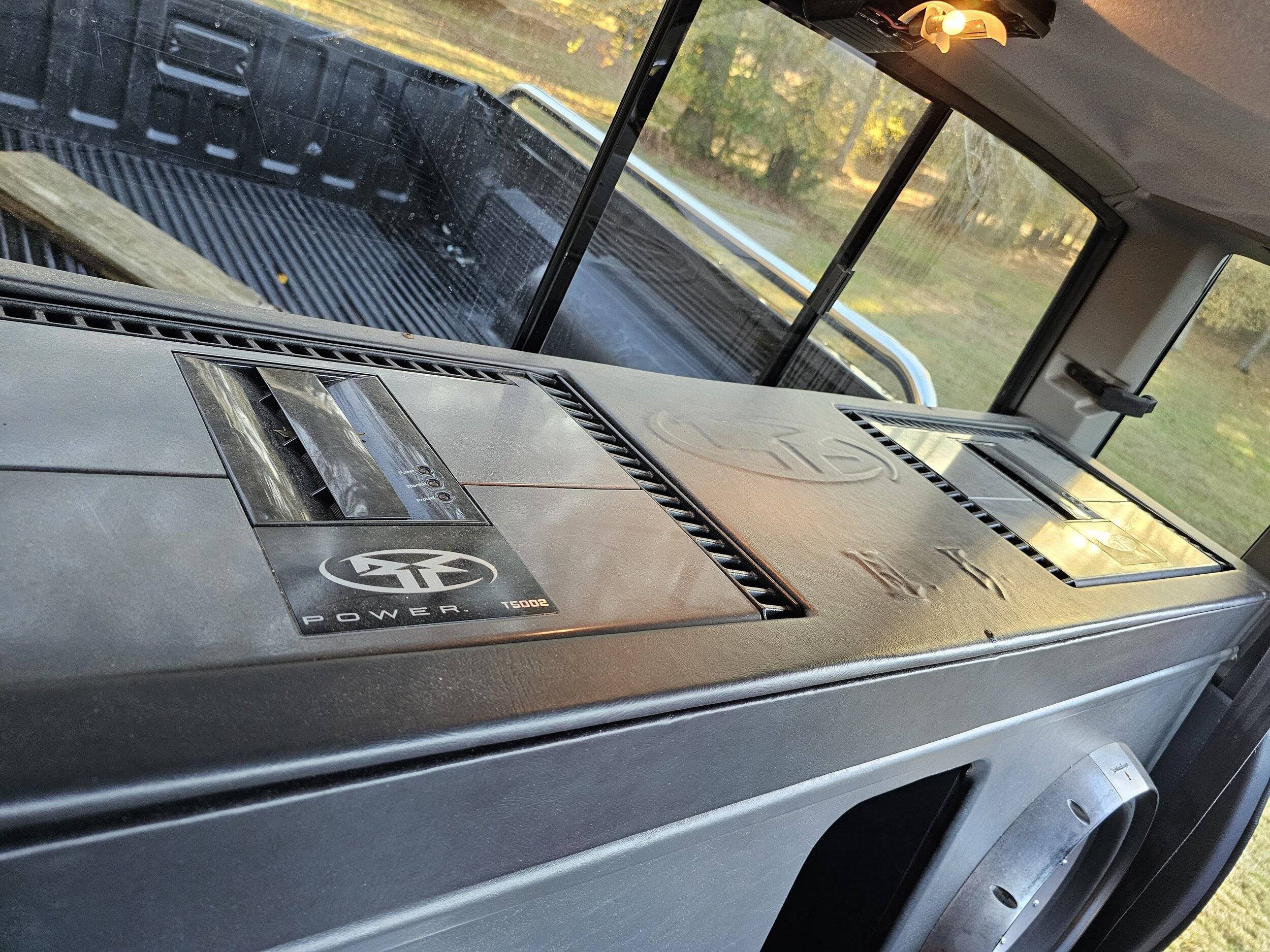

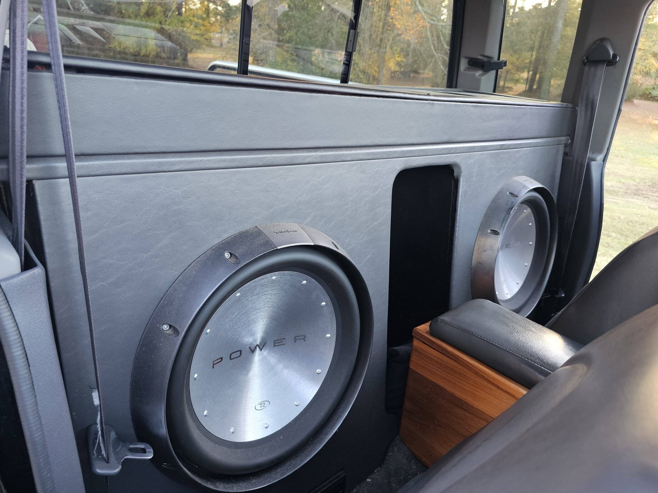

Thats what I like to hear i am an old school bass head lol. Me and my dad use to do the db drag racing back in the day and I was a die hard rockford guy back in the mid 90's so getting back into it and wanted one more big build. This is my old build we ran was an 8 cubic ft box with 21 Inch port...had 2 t2 rockford 15 dual 2ohm on 2 bd t500.2 and 160.4 channel rockford running my component system. Was hitting in the 144 because is in a 95 nissan extended cab.... so I really wanted this build to definitely slam harder than that which it should lol blow it out of the water.....
