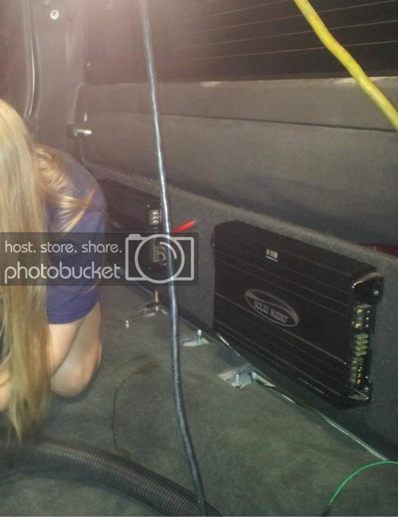

Silverado craptastic build..
Mostly finished up in the back.

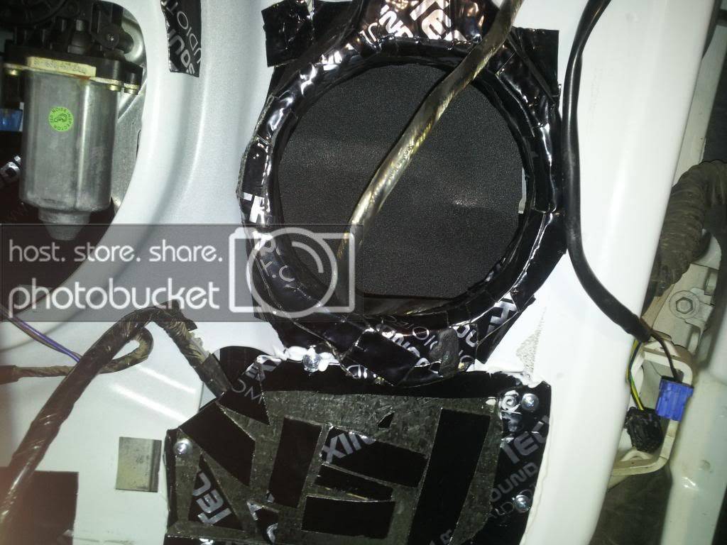

I have a similar truck and when trying to install comps where you did I had a problem with the doors leaking. Do your doors leak directly onto the back of your speakers, and if so how did you solve that?
Butyl rope above the speaker opening on the inside of the door. Built it up a bit, some recommend covering that with deadner but I didn't.
