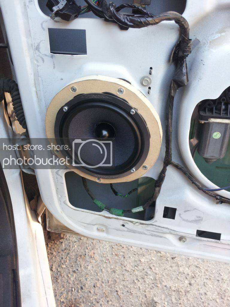

How I installed my ID X65 mids. I used some butyl rope from autozone to create a barrier between the door and MDF and speaker from the MDF.

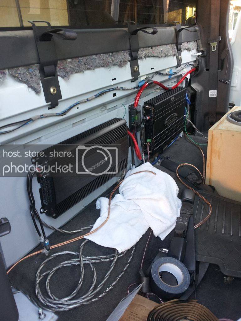

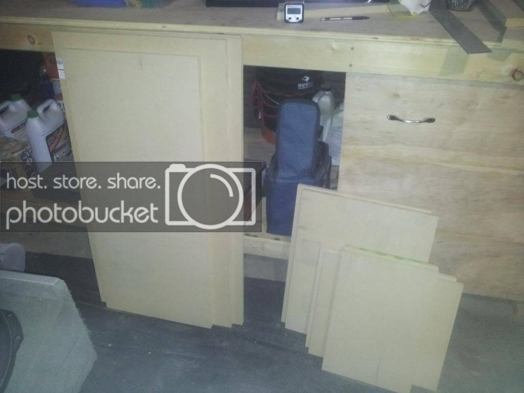

This is how I have my amps mounted atm, using double sided tape to hold up the wood then amps mounted to that.

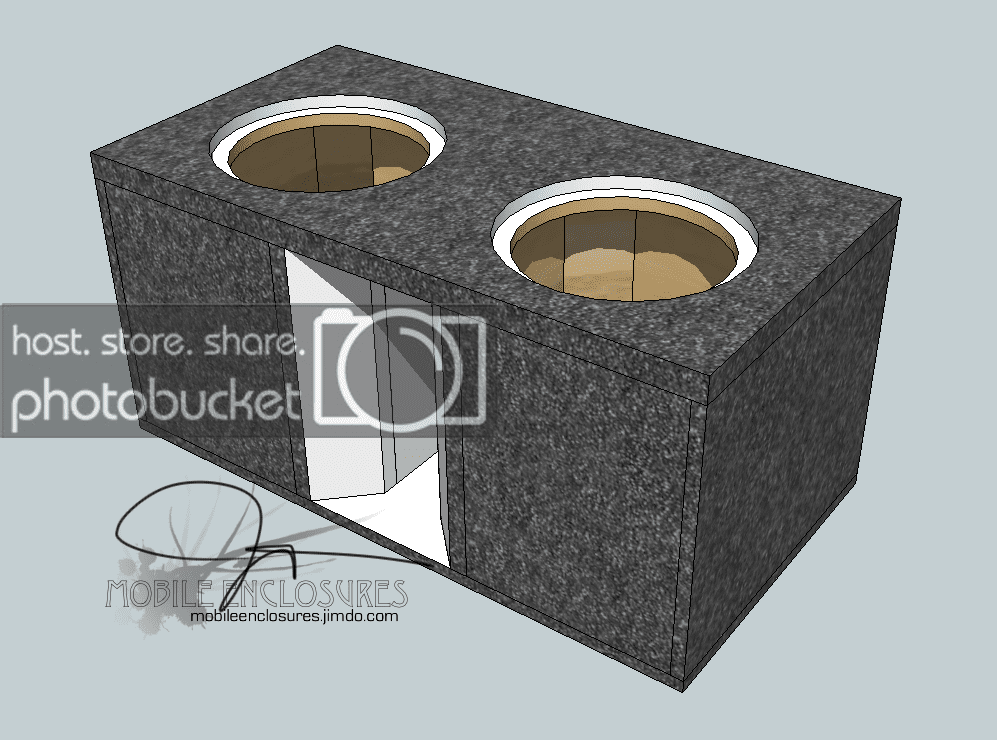

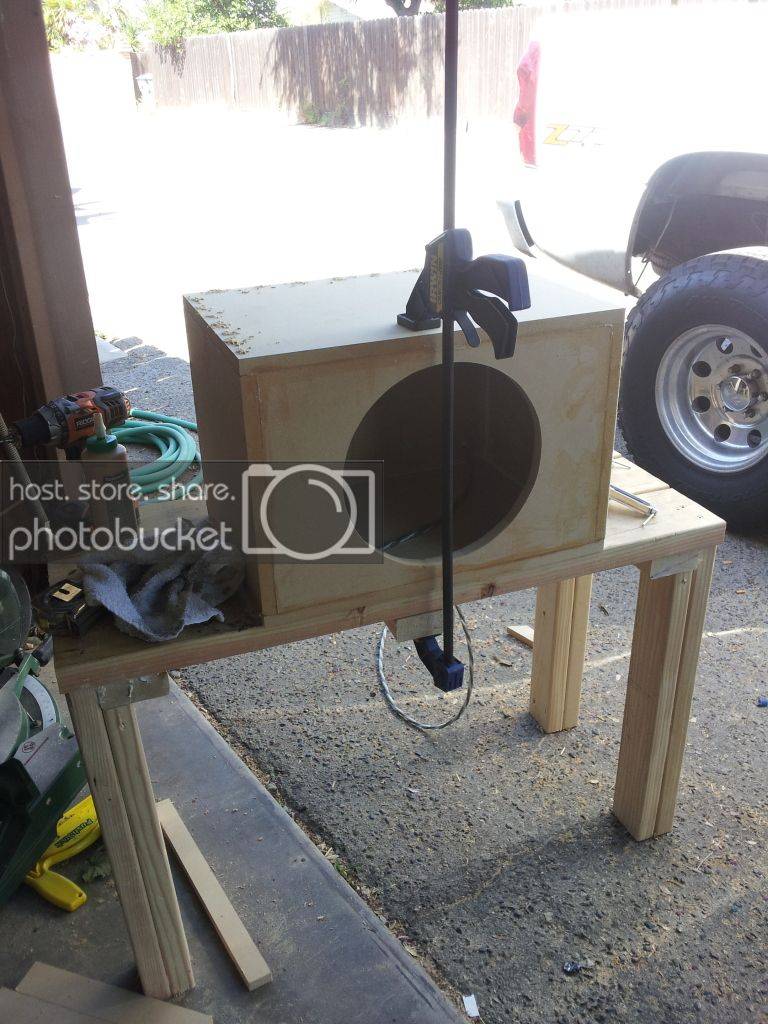

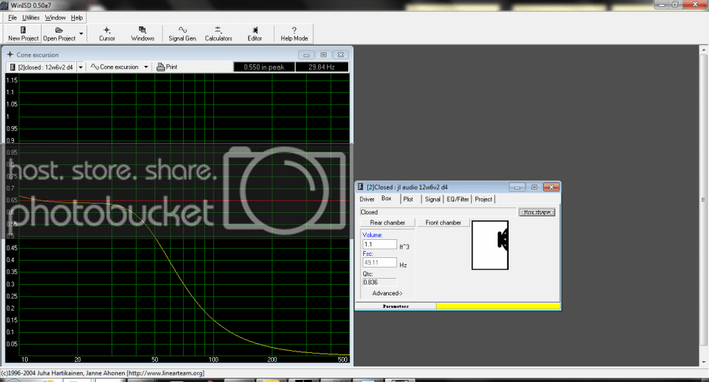

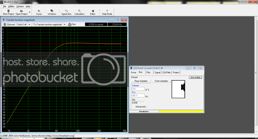

My second attempt at a box, currently working on another box Rangerdanger designed for me. (JLw6V2 is the sub that went into that)

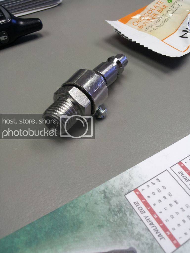

^^^^Not sure what that is about... but here is a pic of the mount ill be using for my tweeter pods that I drilled and put a set screw in so I can tighten and adjust the tweeters imaging.
I think I may have to find a way to extend the length of this to get the tweeter pod farther away from the pillar.
Looks pretty good bro. Pro tip: you need to paint or somehow semi-waterproof those mdf rings you used to mount your mids or they'll fall apart if/when they get wet. Also you'll get far better midbass response from your mids if you somehow seal up those big holes in your doors. You can just use some sheet metal & self-tapping screws, then cover with deadener.
When I get some stuff from Sound deadner showdown ill be redoing the door and sealing it up. I think i will use some 1/2 plywood to seal it though with buytl rope as a decoupler.
