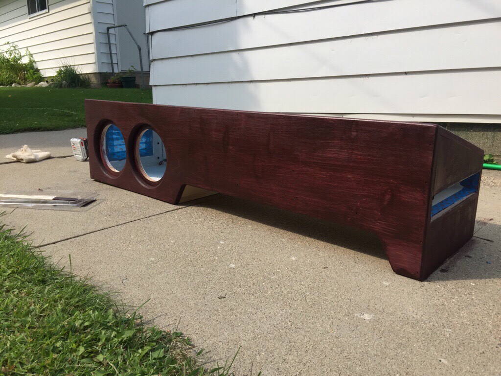

this is the box I had built amp mounts under the box
Hey that's pretty cool! I never thought of extending the hump! Also, being forward facing and on the same side, I could just make the kid sit on the drivers side so the little muddy heels don't find their way into my drivers.
What truck did that go in, and is that a faux wood finish? Looks incredible if so...

Hey that's pretty cool! I never thought of extending the hump! Also, being forward facing I could just make the kid sit on the drivers side so the little muddy heels don't find their way into my drivers.
It's Baltic birch I stained modern mohogany... It's for my 04 Sierra ext.. The box is 2 cu 33hz for two sundown x8's

They are built to order... Gotta be willing to wait for it lol... The hds10s should do you fine... Just know my box required me to lift seat 2" that's how I got it to 2 cu... You could easily go 3" seat lift and have plenty of air space
I'm not sure I want the seat sticking up too far out the back window, there's only a couple of inches of leather before it looks bad through the window / obstructs the view out the back. 2.5" or so would put it right at the level of my toolbox viewing through the rear view... perfect for me. I think I will make it out of 2.5" square tubing.
Do you have the dimensions of yours or would you be willing to share? Anything you could give me would save me tons of time with the pencil!
You have to build your seat lift first... You can't really design a box until you can take exact measurements of what your going to be dealing with...
That's 2 cubes including port and speakers, correct?
After displacement
Right on, thank you. I'm calculating 2.65 cu. ft.^3 including port, before speaker displacements if I raise the seat 2" and keep the trans hump like you did for amp clearance. Pretty spot on my friend!
