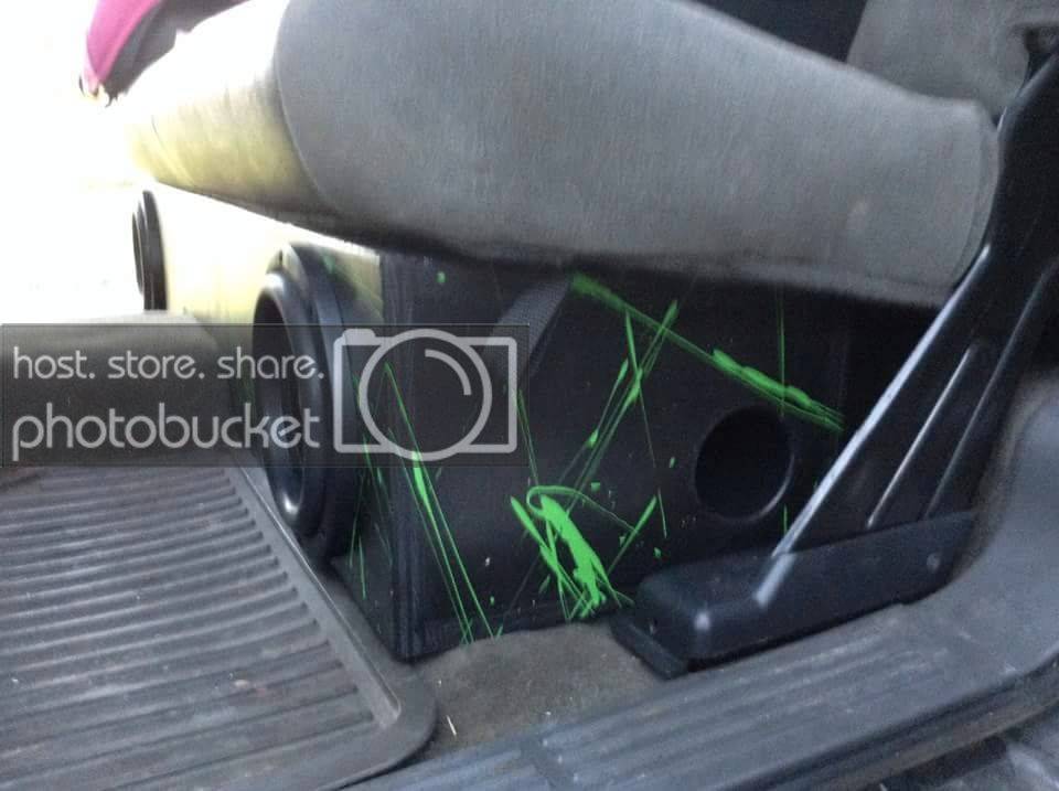

Just did a build with two hds208's front firing port to the sides tuned to 35hz on a 2200.1 @ 1ohm and it gets down. The roof in the silverado is like Paper, it's annoying. Going to have to dampen the entire top because it jiggles around so bad.

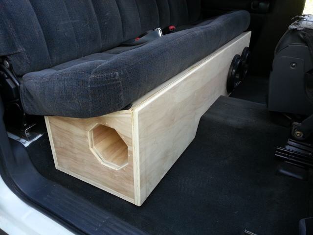

Just over a cube net per sub.. I'll have to look for the rest of my design pictures. Here is the original design, ended up doing side ports like mentioned after talking with cscstang, side ports have a lot more output in these trucks. It gets down, that's for sure. They have been holding up just fine on the power.
The design is under seat, no seat lift.
EDIT: I believe this was a CSCStang box here, which is what I modeled my box after and built exactly like this:
I just added 3/8 ply to mines with spray foam in between. Solid as **** now. Added a false to the back wall as well.

When we were discussing how well the 8's would do.. I didn't expect them to do this well and destroy my roof lol. The ply is a good idea, I'll definitely try that and see how well it does for me.
That looks like a 2000ish truck, same brackets as mine. My box is almost exactly the same, except it's poorly built, not tall enough in the back, and I blew one of the corners out the first week I owned the truck. So I guess it's nothing like it. Oh well.
I would agree that a front facing port would be better since the door closes directly into the port area and would create a strange secondary port of sorts out of the area it creates.
Do you have the file for that or could you dimension it and give it to me? What's the center intrusion for? Does the box actually continue into the ***** hump, or is it a single layer of MDF right there?

Side port was actually better, unloading off the side made it louder.
The center part in the box was a single layer MDF where the amp was going to be mounted, ended up doing a full box all the way across for more air space though. The truck is an 05.

No big deal, I can dimension roughly assuming your holes are 8" with reference measurements from my truck/box.
I think any amp I would use would be too big for that space anyway, I'll use it for volume and put the amp on the back wall like others say is fine.
Sorry, I misread about the side ports. I was trying to avoid them because I didn't think they'd be efficient, if they are I'll try to figure something out! Looks like a 3" round port there?
